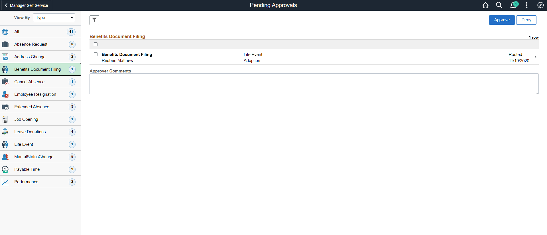

This example illustrates the Pending Approvals- Benefits Document Filing page.
Pending Approvals_Benefits Document Filing page
The approval options on this page are common to all fluid approval transactions, as described in the documentation for theApplication Fundamentals: Using PeopleSoft Fluid User Interface Self-Service Approval Transactions.
You can also take action (for e.g. approve or deny) on multiple approval requests at the same time by selecting the check box before each item then tapping the appropriate action button on the page. Select or deselect all check boxes at once by tapping the top check box in the gray header.
To view details for each request, tap a row and access the Benefits Document Filing Page.

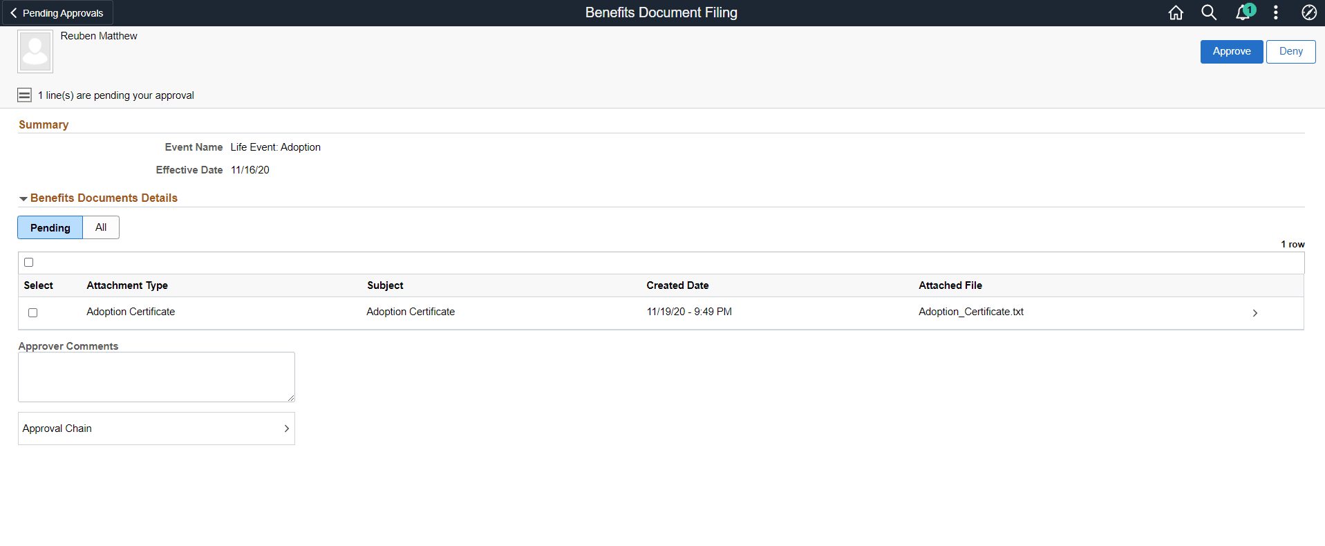

This example illustrates the Benefits Document Filing Page.
Here, you can view the attachment type, subject, created date and name of the attached file. Click a row to open the Attachment modal window, where more details of the document is displayed. You can also access the document uploaded from this Attachment modal window.
If you access the Benefits Document Filing page from the Benefits WorkCenter, the benefits administrator can navigate between the drill-down levels using breadcrumbs. The Pending Approvals level displays all the approvals that are pending. The Header level displays the list of documents that are pending approval for the selected employee. The Line level displays the details of the selected document.

Benefits Documents Line Details Page
Field or Control Description
Approve and Deny buttons
Use these buttons to take action on the requested approval.
Approver Comments
Enter any comments related to the approval action you take.
Approval Chain
Click this item to open the Approval Chain page, where you can review information about all the approver(s) for the transaction.
