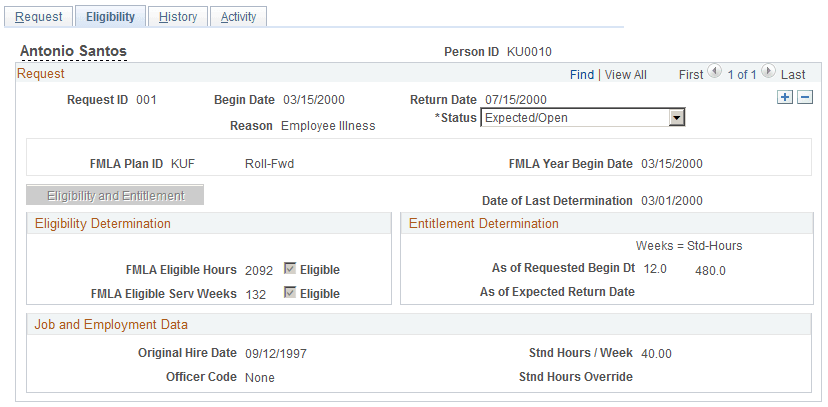

Use the Request/Authorize/Track Leave - Eligibility page (FMLA_LV_REQUEST2) to determine FMLA leave eligibility and entitlement.
Navigation:
Benefits, and then Track FMLA (Family Medical Lv), and then Request/Authorize/Track Leave, and then Eligibility
This example illustrates the fields and controls on the Request/Authorize/Track Leave - Eligibility page. You can find definitions for the fields and controls later on this page.

Eligibility and Entitlement
Click to start the eligibility and entitlement processes. These processes use employee job history, the FMLA plan parameters, payroll data, and data on the Request page to populate all of the other fields on the Eligibility page with the exception of the Std Hours Override (standard hours override) field.
Note: The Eligibility and Entitlement button is not available if the prerequisite data for the leave request is not entered in the Request page. It is also unavailable if the request's status is completed, denied, or canceled.
