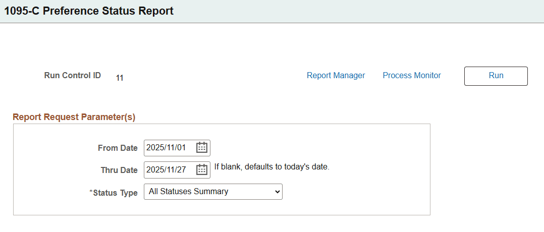

1095-C Preference Report Page
Use the 1095-C Preference Report page (ACA_RC_BAC010) for administrators to run the 1095-C Preference Report (BAC010), which lists employees’ most current 1095-C Preference status based on dates and status type that you specify in the report request parameters.
Navigation:
  • Select Benefits WorkCenter from the My Work section of the Application Fundamentals: PeopleSoft (My Home) Landing Page. Then select Links, and then ACA Setup, and then 1095-C Preference Report
  • Benefits, and then ACA Annual Processing, and then Preference Process, and then 1095-C Preference Report
  • Workforce Administrator, and then Manage Benefits, and then Benefits WorkCenter, and then Links, and then ACA Setup, and then 1095-C Preference Report
This example illustrates the fields and controls on the 1095-C Preference Report Page.
1095-C Preference Status Report Page
Field or Control Description
From Date and Thru Date
Select the date range to generate the 1095-C Preference Report.
Status Type
Select the employee's 1095-C Preference status to be included in the report. Available values are:
  1. All Statuses Summary
  2. Paper Form Requested
  3. Request Reset Electronic
  4. Request Reset Paper Form
  5. Request Withdrawn
Run
Select to generate the 1095-C Preference Report for the selected date range and employee's preference status.

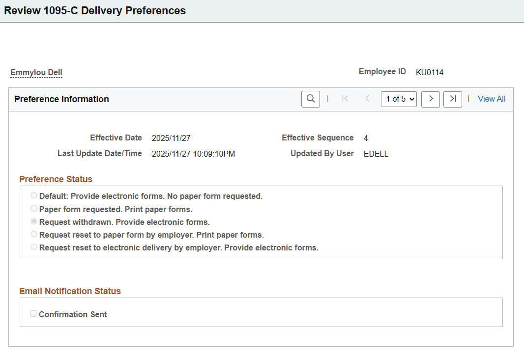

Review 1095-C Preferences Page
Use the Review 1095-C Preferences page (ACA_REVIEW_CONSENT) for administrators to monitor employee preference and review the history of each employee's preference and email notification status.
Navigation
  • Select Benefits WorkCenter from the My Work section of the Application Fundamentals: PeopleSoft (My Home) Landing Page. Then select Links, and then ACA Setup, and then Review 1095-C Preferences
  • Benefits, and then ACA Annual Processing, and then Preference Process, and then Review 1095-C Preferences
  • Workforce Administrator, and then Manage Benefits, and then Benefits WorkCenter, and then Links, and then ACA Setup, and then Review 1095-C Preferences
This example illustrates the fields and controls on the Review 1095-C Delivery Preferences page.
Review 1095-C Delivery Preferences Page
Preference Status
Displays the 1095-C Delivery Preference Status for the employee based on the preference selected by employee or preference reset by the employer.
Email Notification Status
The check box is shown as checked if a confirmation email was sent to the employee for the 1095-C preference reset.
