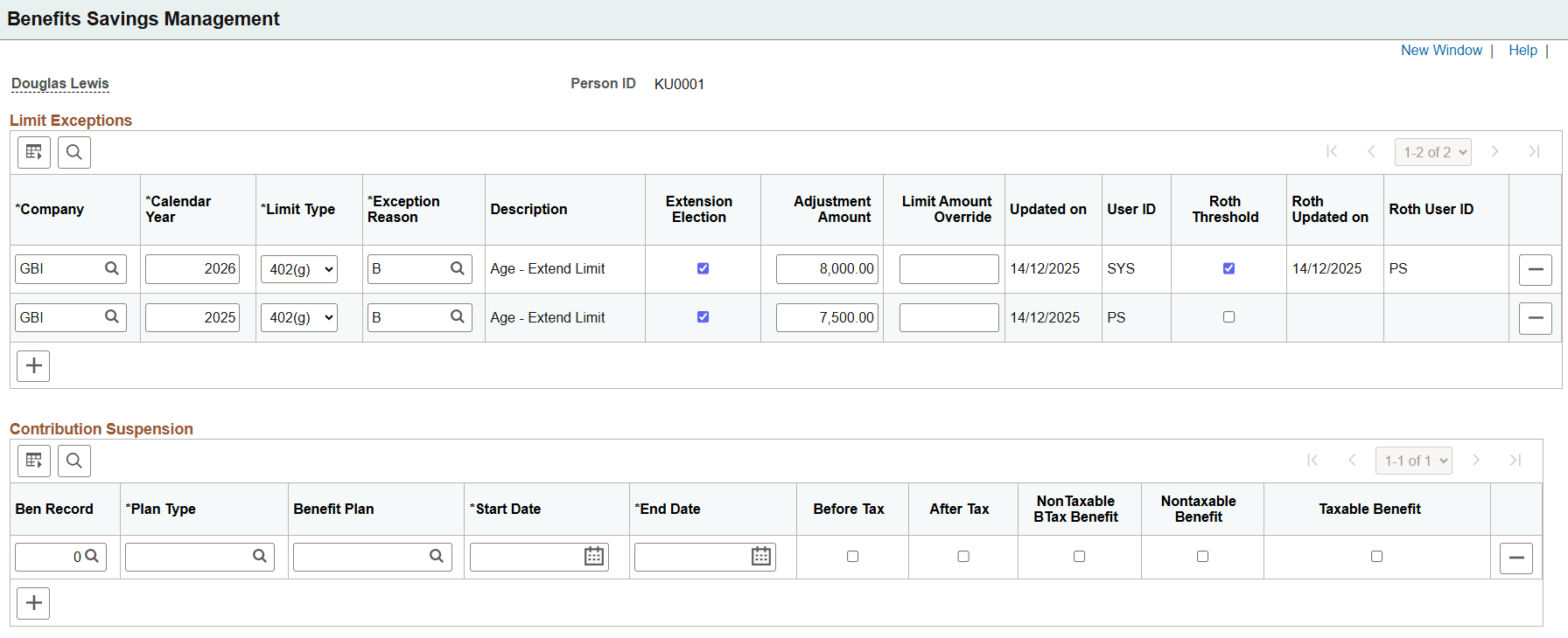

Benefits Savings Management Page
Use the Benefits Savings Management page (SAVINGS_MGT_EE) to review and update savings plan limits.
Manage the 402(g), 457 and 401(a) limit extensions and overrides for 401(k), 403(b), and 457 Savings Plans. Suspend savings plan contribution.
Navigation:
Benefits, and then Enroll in Benefits, and then Benefits Savings Management
This example illustrates the fields and controls on the Benefits Savings Management page. You can find definitions for the fields and controls later on this page.
Limit Exceptions
Field or Control Description
Company
Select the company.
Calendar Year
Select the calendar year.
Limit Type
Select the limit type you want to adjust. Choose from:
  • 401(a)
  • 402(g)
  • 415(c)
  • 415z
  • 457
Exception Reason and Description
Select the reason for the exception. Choose from:
  • A: This option is available if you select 402(g) or 457 in the Limit Type field. The Description field is automatically populated with Catch Up Extend Limit.
  • B: This option is available if you select 402(g) or 457 in the Limit Type field. The Description field is automatically populated with Age 50 Extend Limit.
  • E: This option automatically appears if you select 401(a) in the Limit Type field. The Description field is automatically populated with Adjust Eligible Earnings Year to Date.
    To give flexibility in controlling the eligible earnings, the Limit Type 401(a) Adjust Eligible Earnings IT'D amount can be used to adjust the eligible earnings accumulated in a positive or negative amount. The special accumulators used to define eligible earnings for the purpose of measuring the 401(a) limit begin accumulating at the start of the calendar year regardless of whether the employee is contributing.
  • H: This option is available if you select 402(g) in the Limit Type field. The Description field is automatically populated with Hardship Reduce Limit.
Extension Election
If applicable, select this check box.
Adjustment Amount (extension amount)
For 403(b) plans, the amount displayed here represents the 15-year catch-up extension amount as generated by the 403(b) process. This field is used as an extension to the 402(g) limit when you select the Extension Election check box. The system uses the lesser of the following three:
  • The amount entered in the 402(g) Annual Cap Expansion field located on the 403(b) Limit Table.
  • The amount entered in the 402(g) Lifetime Cap Expansion field located on the 403(b) Limit Table minus the amount in the Life-To-Date 402(g) Cap Used field displayed on the 403(b) Balances page.
  • The employee's years of service multiplied by the amount entered in the 402(g) Per Year Max Average field located on the 403(b) Limit Table, minus the amount in the Life-To-Date Employee Elective Deferrals 402(g) field displayed on the 403(b) Balances page.
For 457 plans, the underutilized 457 plan amount for previous years is entered here. The amount represents the three-year catch-up extension amount.
Limit Amount Override
The override amount entered here is used instead of the 402(g) limit or extended 402(g) limit if the Ext Election option is selected. It will apply to only 403(b) plans.
Updated On
The system enters a date when new information is saved.
User ID
The system identifies the user who updated the information. Options are:
  • SYS, which indicates that either the Age-50, 403(b), or 457 processes created the record.
  • <user ID>, which indicates that a user manually added the row.
Roth Threshold
The Roth Threshold check box is enabled after the age catch-up extension process for employees whose prior year FICA earnings exceed the limit entered in the Limit Table. These employees are flagged for Mandatory Roth rollover.
Roth Updated On
The system enters the date when the Roth Threshold check box is updated.
Roth User ID
The system identifies the user who updated the Roth Threshold check box. Available values are:
  • SYS: The savings age catch-up extension process updated the Roth Threshold check box.
  • <User ID>: A user manually updated the Roth Threshold check box.
Contribution Suspension
Ben Record (benefit record) Plan Type, and Benefit Plan
Select the desired plan type and benefit plan for which contributions should be suspended.
Start Date and End Date
Indicate the dates through which to suspend the contributions. Indicate the tax class for which to suspend contributions.
Before Tax
Select to suspend the employee's before tax contribution.
After Tax
Select to suspend the employee's after tax contribution.
NonTaxable Btax Benefit
Select to suspend the employer before-tax contribution.
Nontaxable Benefit
Select to suspend the employer after tax contribution.
Taxable Benefit
Select to suspend the employer after-tax contribution.

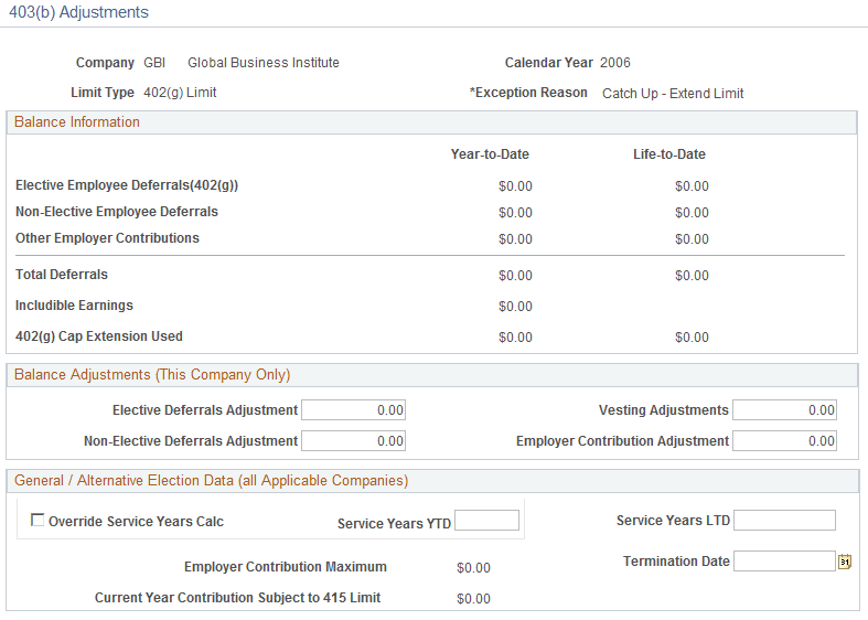

403(b) Adjustments Page
Use the 403(b) Adjustments page (SAVINGS_MGT_EE_SP1) to monitor 403(b) balances.
Review the year-to-date (IT'D) and life-to-date (LTD) balances from the 403(b) process, enter contributions made at another company, and review an employee's contribution amount for each applicable limit.
Navigation:
Click the 403(b) link on the Savings Management page.
This example illustrates the fields and controls on the 403(b) Adjustments page. You can find definitions for the fields and controls later on this page.
Balance Information
The system displays the IT'D and LTD balances calculated from the 403(b) process.
Balance Adjustments (This Company Only)
Use to enter employee contributions from a previous employer. The Calculate 403(b) Extensions process uses these figures.
Elective Deferrals Adjustment, Non-Elective Deferrals Adjustment, and Employee Contribution Adjustment
Enter the new amounts. Both the Calculate 403(b) Extensions and Pay Calculations processes use these fields.
Vesting Adjustments
Enter the new amount. Both the Calculate 403(b) Extensions and Pay Calculations processes use these fields. A vesting adjustment is considered to be a type of employer contribution, so it is used along with the Employer Contribution YTD/LTD balance fields and the Employee Contribution Adjustment field.
General / Alternative Election Data (all Applicable Companies)
Override Service Years Calc (override service years calculation)
Select this check box if you need to override the system-calculated Service Years IT'D field, the Service Year LTD field, or both displayed on the 403(b) Projections page.
Employer Contribution Maximum
This is the amount entered in the Maximum Yearly Deduction field located on the 415(c) Limit Table.
Termination Date (403[b] expected termination date)
If applicable, enter the date.
Current Year Contribution Subject to 415 Limit
This is the year-to-date deductions that are subject to the 415(c) limit.
