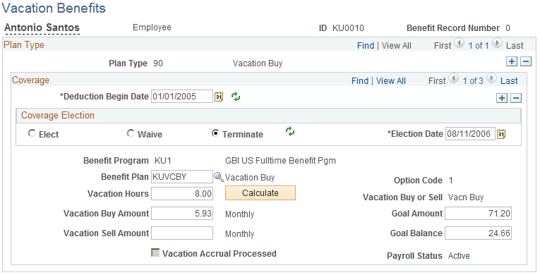

Use the Vacation Benefits page (VACATION_BENEFIT) to review leave accrual processing status for a specific employee.
Navigation:
Benefits, and then Enroll In Benefits, and then Vacation Benefits, and then Vacation Benefits
This example illustrates the fields and controls on the Vacation Benefits page. You can find definitions for the fields and controls later on this page.
When you enroll an employee, the system deselects the Vacation Accrual Processed check box. Vacation Accrual Processed is selected after payroll has been processed for the employee and the Leave Accrual process has been run.
