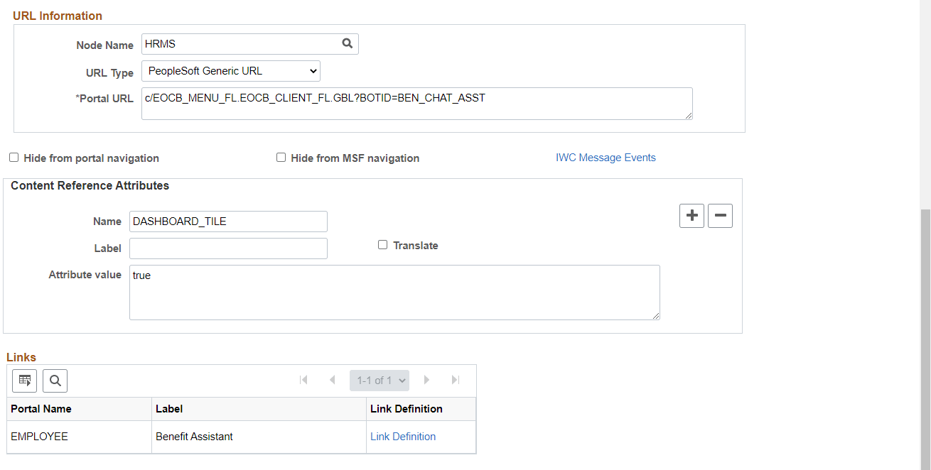

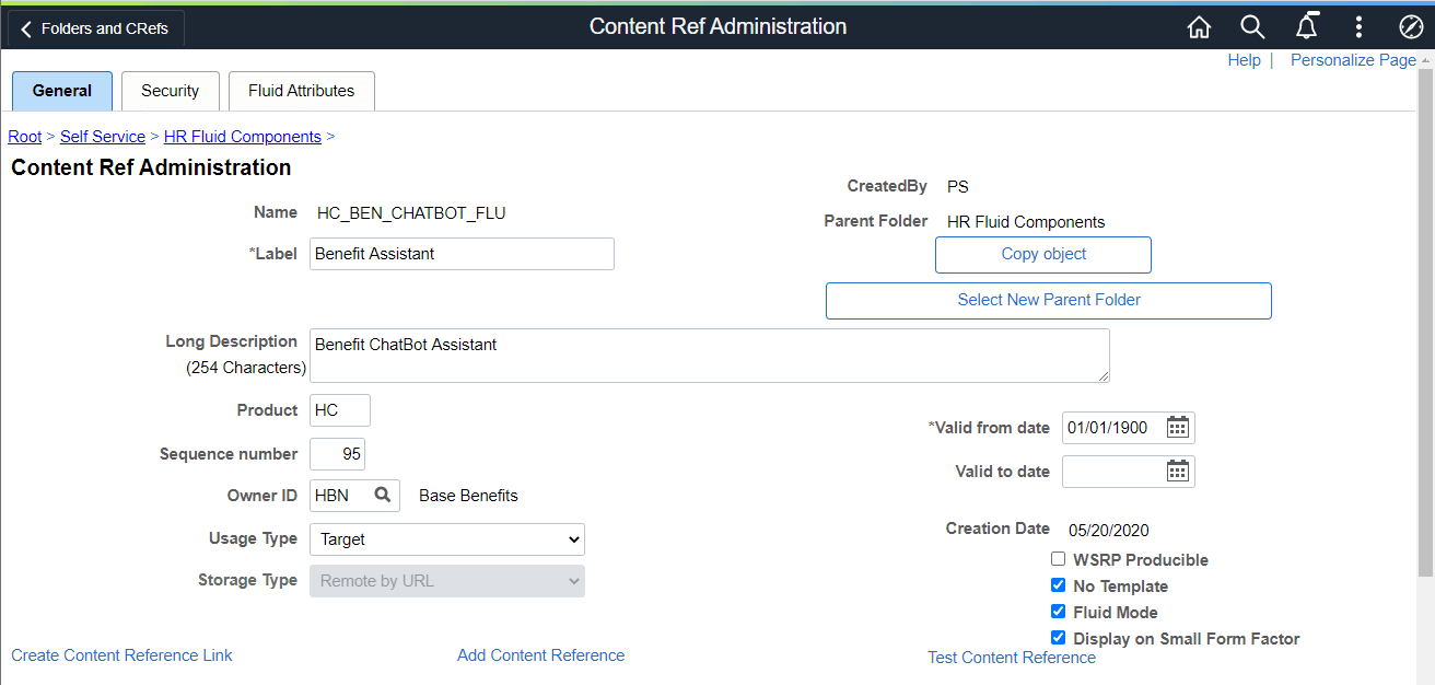

Content Ref Administration Page
Use the Content Ref Administration (PORTAL_CREF_ADM) page — Fluid Attributes tab (PORTAL_GROUPLET), to add the Benefits Assistant tile to the Benefit Details dashboard.

Under Content References, select Edit for the label Benefits Assistant and select Fluid Attributes tab.
For details, refer the topic: Enterprise Components: Adding Chatbot to Application pages.

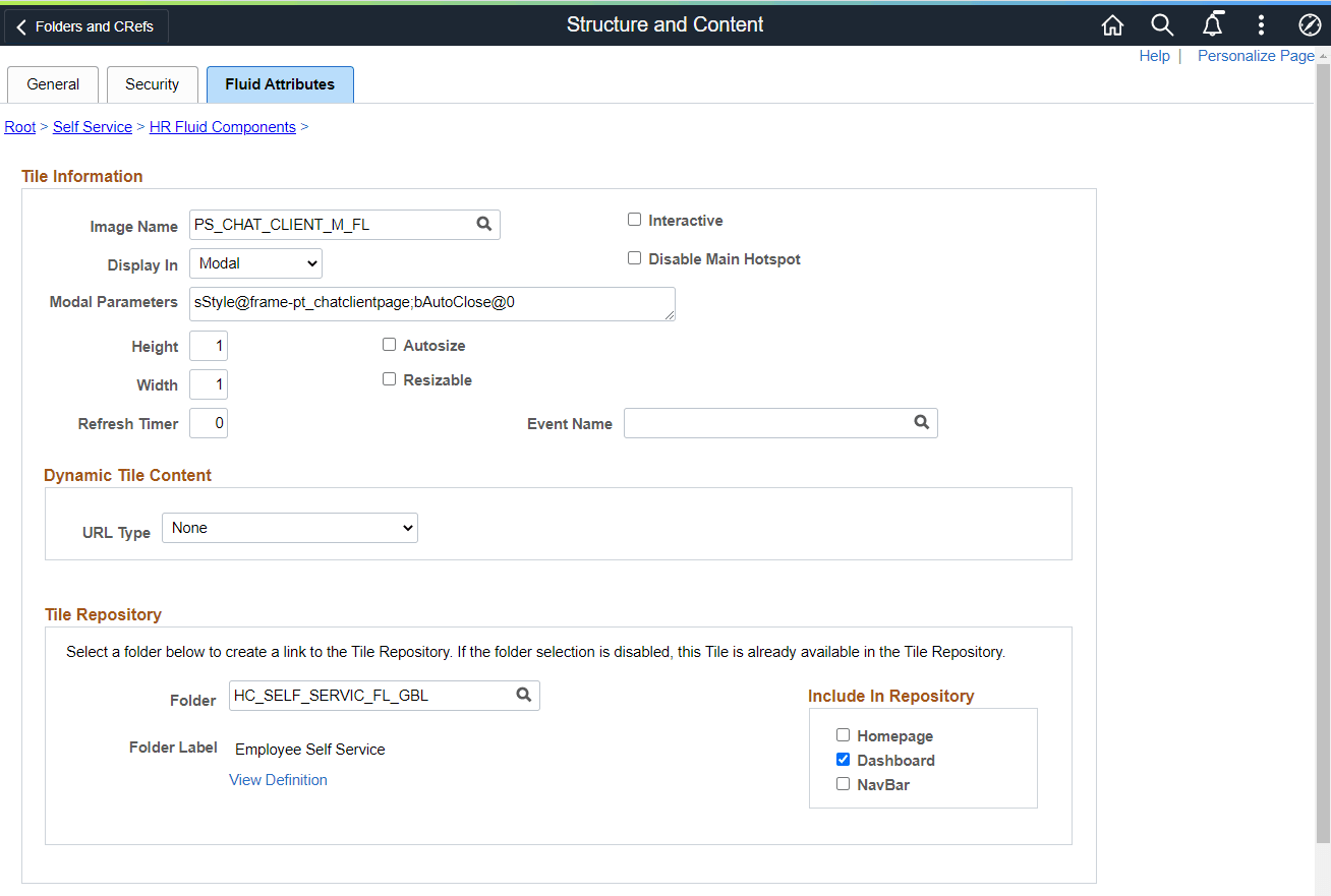

Select the Fluid Attributes tab to open the Tile Repository section.
This example illustrates the fields and controls on the Fluid Attributes tab.
Select the Dashboard checkbox under Include In Repository to enable the Benefits Assistant tile to the Benefit Details Tile dashboard.

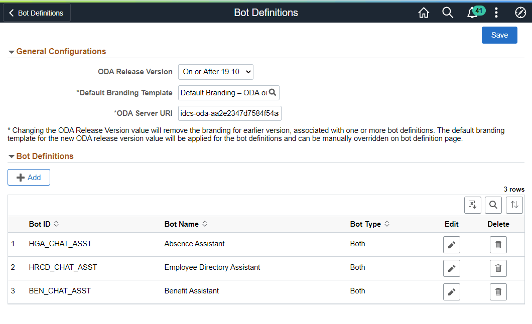

Bot Definitions Page
Use the Bot Definitions (EOCB_BOTSRCH_FL) page to view the existing chatbot identifiers and newly define a chatbot.

This example illustrates the fields and controls on the Bot Definition Page. You can find definitions for the fields and controls later on this page.
| Field or Control | Description |
Select Add to open the Add Bot Definition page to create a new bot definition. |

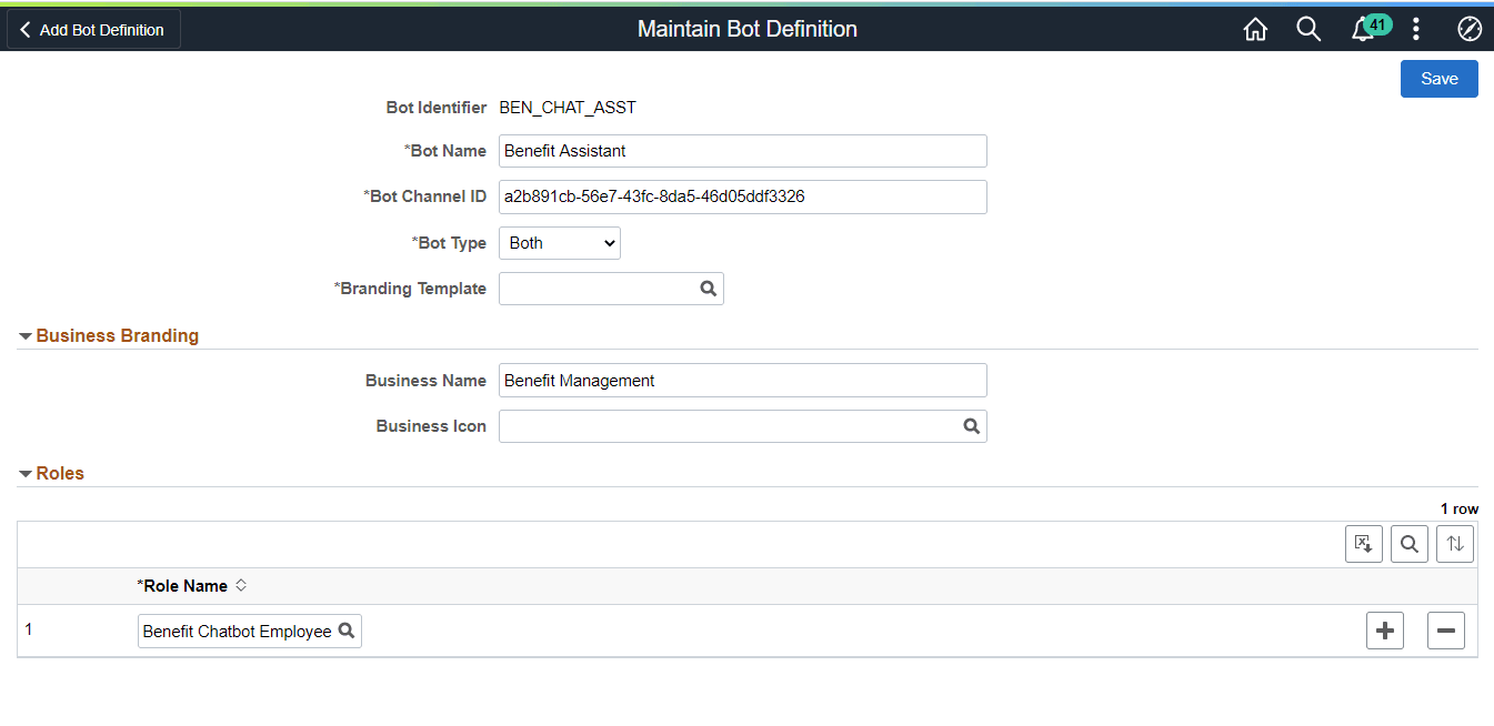

Maintain Bot Definition page
Use the Maintain Bot Definition page (EOCB_BOTDEFN_FL) to view the existing definitions for a chatbot.

This example illustrates the fields and controls on the Maintain Bot Definition page. You can find definitions for the fields and controls later on this page.
Bot Identifier |
Displays the root package ID defined in the application server. |
Bot Name |
Enter the name of the chatbot. |
Bot Channel ID |
Specify the channel ID generated by the ODA Skill created for this chatbot. This ID links the chatbot with the skills in the ODA. |
Bot Type |
Choose whether to deploy the chatbot client as a tile or as a widget in a page or both. Bot types are embedded (for components) and widget (lower right-hand corner button). |
Branding Template |
Choose the Branding template for the bot. |
Business Name |
Name of the chatbot as it will appear to the users. |
Business Icon |
Choose the bot icon according to your business need. Refer, PeopleTools: Creating Image Definitions, for more information. |
Role Name |
Choose the roles that should be given access to this chatbot. |

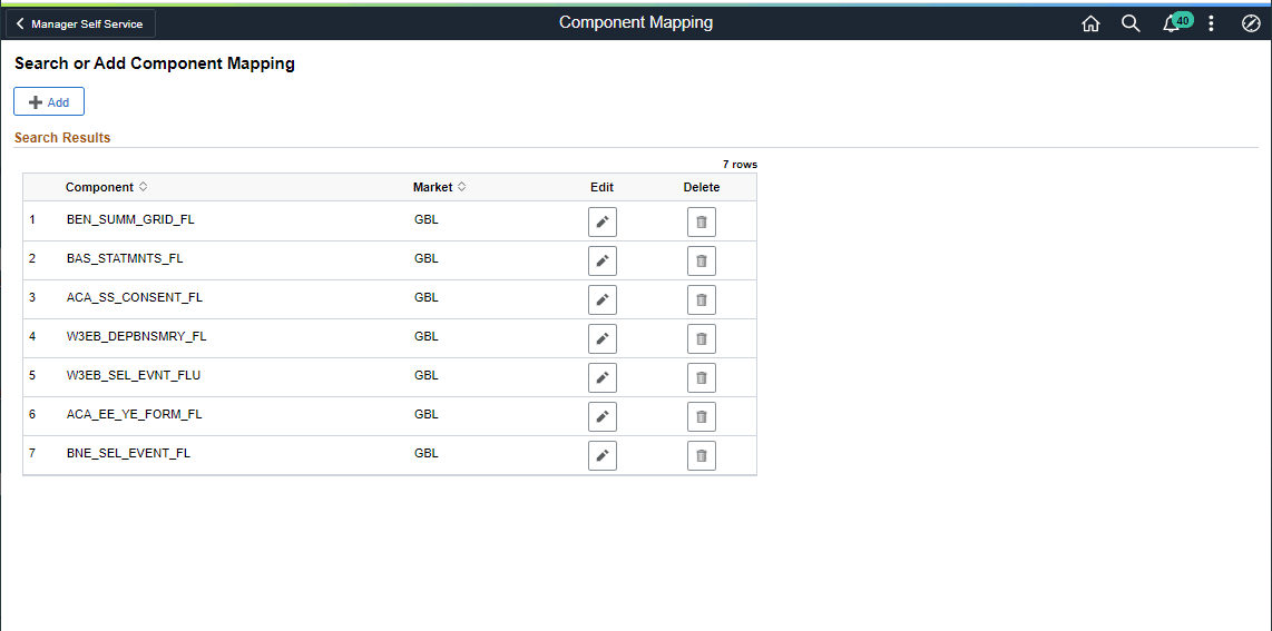

Component Mapping Page
Use the Component Mapping page (EOCB_COMPSRCH_FL) to choose the component (that is, the Benefits fluid page) on which the Benefits Assistant widget should be made available.

This example illustrates the fields and controls on the Component Mapping Page.
Component |
Displays the fluid components or fluid Benefits pages on which the Benefits Assistant widget can be enabled. |
Edit |
Click the Edit button to access the Maintain Component Mapping page and enable the Benefits Assistant on the component pages. |
