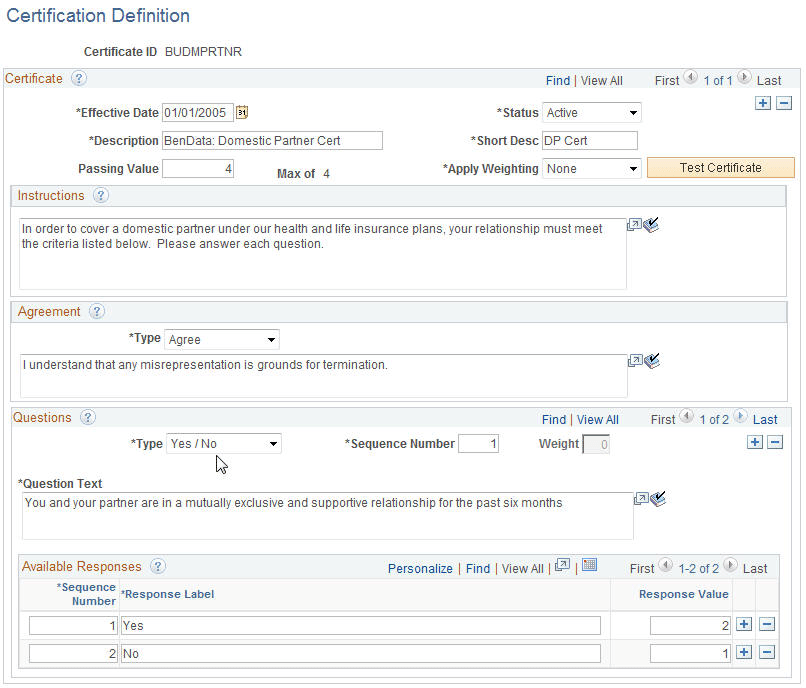

Certification Definition Page
Use the Certification Definition page () to define benefits certifications.
Navigation:
Set Up HCM, and then Product Related, and then Base Benefits, and then Certification Definition, and then Certification Definition
This example illustrates the fields and controls on the Certification Definition page. You can find definitions for the fields and controls later on this page.
Field or Control Description
Passing Value
Enter a minimum value for the certification to pass.
Apply Weighting
Select to control the display of the Weight field in the Questions group box below.
Values are:
  • None (the default)
  • Multiply: Because the answers to the questions are weighted, or have values, the system multiplies these values by a multiplier (defined here) to enable the administrator to assign more weight or importance to various questions. The Weight field is required when you select Multiply.
Test Certificate
Select to display the Certification Definition page, which appears to the participant in the eBenefits self-service application when enrolling in benefit plans. You can also test the certificate to verify that the values of the answers and the certificate are calculating properly.
Instructions
Enter instructional text to display to the participant. This is optional.
Agreement
Type
Select from Accept, Agree, and N/A. The agreement text box can be left blank, but the type needs to be defined.
Questions
Type
Select from the following values to determine the display of the Available Responses group box.
  • Yes / No: Single statements are displayed.
  • Rating: Statements with several options appear. The sequence number needs to be specified and must be unique. This type allows one or more response rows to be created; they will appear as radio buttons on the certificate. Only one answer is allowed.
  • Multiple (choice): Select from one or more statements. The sequence number needs to be specified and must be unique. This type allows one or more response rows to be created and they will appear with check boxes, so multiple responses can be selected.
Sequence Number
Enter the number next to the entry that specifies the order in which it will appear to the participant.
Weight
Enter a number that the system uses when applying weighting. The system multiplies the response by 1.
Question Text
Enter a statement for the participant to respond to.
Available Responses
The system automatically displays either:
  • Sequence Number: The system enters the sequence number.
  • Label text: Yes, No, or anything within the field size limit.
