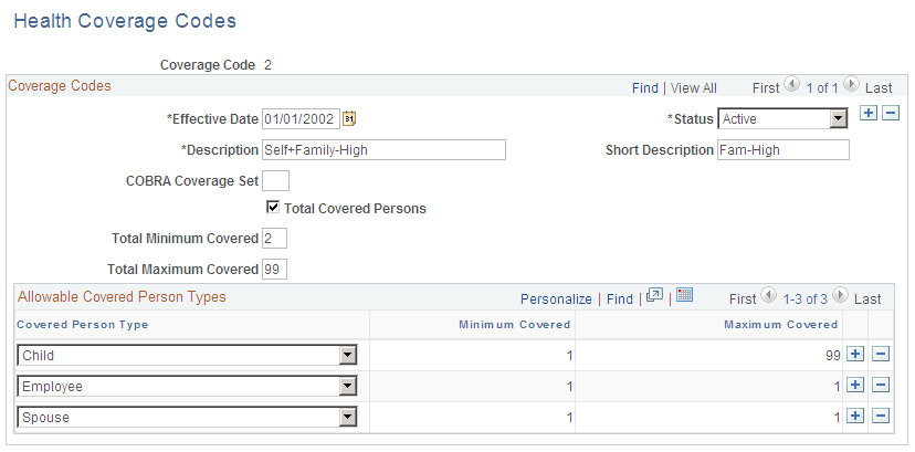

Health Coverage Codes Page
Use the Health Coverage Codes page (COVRG_CD_TBL) to define coverage codes.
Navigation:
Set Up HCM, and then Product Related, and then Base Benefits, and then Plan Attributes, and then Health Coverage Codes, and then Health Coverage Codes
This example illustrates the fields and controls on the Health Coverage Codes page. You can find definitions for the fields and controls later on this page.
Field or Control Description
COBRA Coverage Set
A 2-character code that is used to group coverage codes together for COBRA eligibility purposes. When an individual experiences a COBRA event, the system must adjust the range of coverage codes available to each qualified beneficiary. By restricting itself to a specific set of coverage codes, COBRA processing can more accurately determine which benefit options to present to a participant who is eligible for COBRA coverage. If COBRA coverage sets are not established, then COBRA processing may encounter multiple equivalent coverage codes, and eligibility determination may fail.
Total Covered Persons
Select to activate the total covered person types functionality for this coverage code.
Total Minimum Covered and Total Maximum Covered
These fields are visible only when the Total Covered Persons check box is selected.
Enter the allowable minimum and maximum covered persons. Include the employee in this count.
Allowable Covered Person Types
Covered Person Type
Select from the following values to define the relationship you have to the dependent.
Child, Adult Child, Domestic Partner, Employee, ExSpouse, Non-Qualified Dependent, Other Qualified Dependent, Spouse, and US Same-Sex Spouse.
Note: The coverage code controls for covered person type are used in PeopleSoft Benefits Administration.
See PeopleSoft Benefits Administration: Event Rules Table – Event Rules Page.
Minimum Covered
Enter the minimum number of covered persons allowed.
If you selected the Total Covered Persons check box, this field is not editable.
Maximum Covered
Enter the maximum number of covered persons allowed.
If no limit applies to the number for this coverage code, enter 99.
