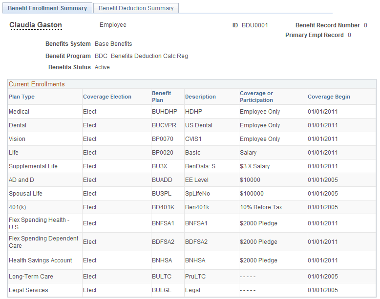

Benefit Enrollment Summary Page
Use the Benefit Enrollment Summary page (BN_ENRL_SUMMARY) to view benefit enrollment summaries for employees.
Navigation:
Benefits, and then Review Employee Benefits, and then Current Benefits Summary, and then Benefit Enrollment Summary
This example illustrates the fields and controls on the Benefit Enrollment Summary page. You can find definitions for the fields and controls later on this page.

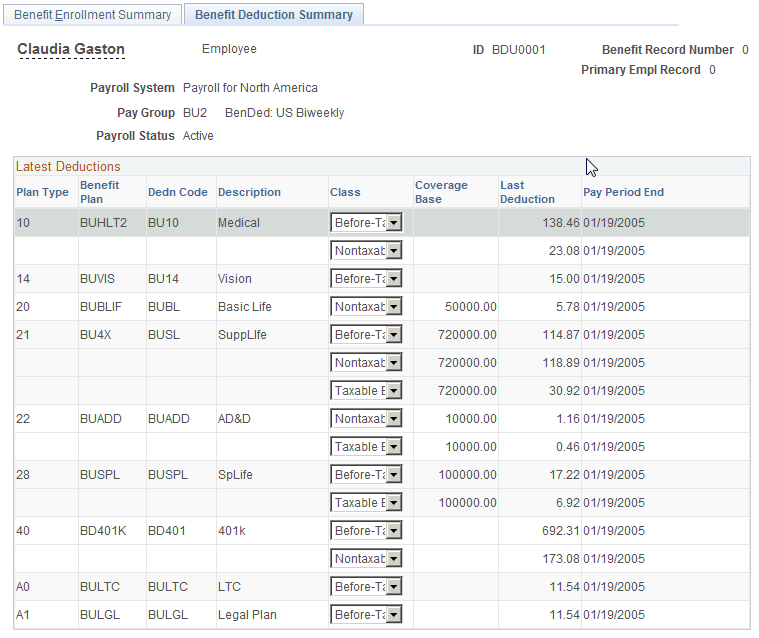

Benefit Deduction Summary Page
Use the Benefit Deduction Summary page (BN_DEDN_SUMMARY) to display any deductions taken against those enrollments on the last run of either PeopleSoft North American Payroll or PeopleSoft Payroll Interface, as applicable to the employee.
Navigation:
Benefits, and then Review Employee Benefits, and then Current Benefits Summary, and then Benefit Deduction Summary
This example illustrates the fields and controls on the Benefit Deduction Summary page. You can find definitions for the fields and controls later on this page.
