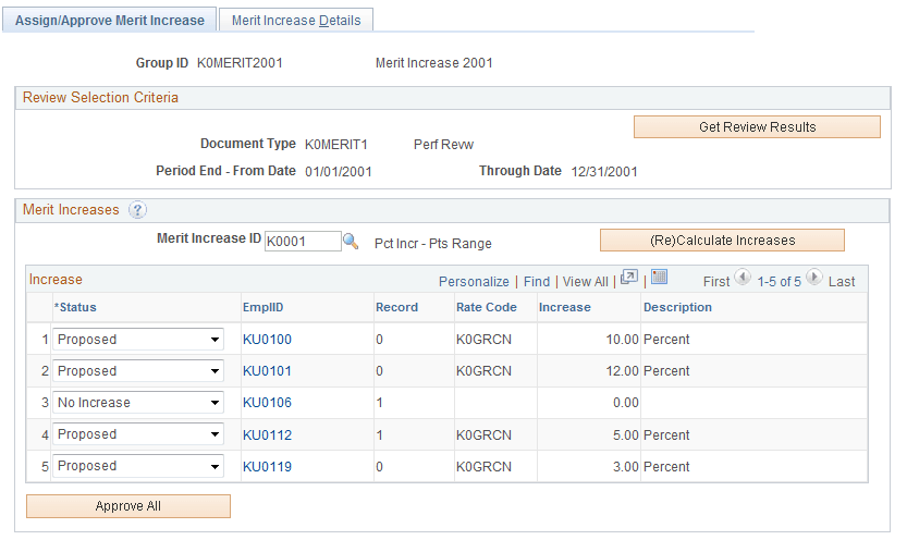

Assign/Approve Merit Increase Page
Use the Assign/Approve Merit Increase page (SP_MERIT_INCR_GRP) to calculate merit increases for the workers in the selected group based on the workers' review results and the merit increase guidelines associated with the Merit Increase ID.
Navigation:
Compensation, and then Base Compensation, and then Merit Increases, and then Assign/Approve Merit Increases, and then Assign/Approve Merit Increase
This example illustrates the fields and controls on the Assign/Approve Merit Increase page.
Field or Control Description
Get Review Results
Click to retrieve the review results for the workers in the merit group (as defined on the Define Merit Group page).
Merit Increase ID
Select a Merit Increase ID to apply to the members of this merit Group ID. Merit Increase IDs are defined on the Define Merit Increase component.
(Re)Calculate Increases
Click to calculate or recalculate merit increases. The system uses the change values entered on the Define Merit Increase component. The system sets the Status to Proposed for each worker listed. If the merit increase is zero (0), the system sets the status to No Increase.
Note: Click only to calculate the merit increases based on the review points resolution associated with the Merit Increase ID. If you click this button after having made manual changes, the system will erase your changes and reapply the changes associated with the Merit Increase ID.
Status
Select one of the following statuses for each worker's merit increase:
  • Approved
    When you select this value, the system makes the merit increase fields unavailable for entry. Select to approve the merit increase.
  • Ineligible
    When you select this value, the system makes the merit increase fields unavailable for entry. Select if the worker is ineligible for a merit increase.
  • No Incr (no increase)
    When you select this value, the system makes the merit increase fields unavailable for entry. Select to deny the worker the calculated increase.
  • Proposed
    Select to manually adjust the merit increase amount calculated by the system on the Merit Increase Details page, if required. The system selects the Manually Updated flag on the Merit Increase Details page when you make an adjustment. Once you have entered the appropriate merit increase, select Approved to approve the increase or No Incr or Ineligible to deny it.
  • Processed
    The system selects this status when it has processed a merit increase for this worker. You cannot modify the merit increase or status for this worker.
    Note: You can manually change a worker's merit increase on the Merit Increase Details page before you select a status.
Approve All
Click to set the status from Proposed to Approved. The system does not modify the statuses No Incr, Ineligible, and Processed.
Note: You can manually change a worker's merit increase on the Merit Increase Details page before you approve all the merit increases.

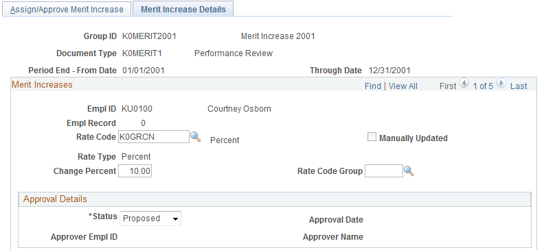

Merit Increase Details Page
Use the Merit Increase Details page (SP_MERIT_INCR_EE) to review details about the worker merit increase and make changes, if required.
Navigation:
Compensation, and then Base Compensation, and then Merit Increases, and then Assign/Approve Merit Increases, and then Merit Increase Details
This example illustrates the fields and controls on the Merit Increase Details page (1 of 2).
This example illustrates the fields and controls on the Merit Increase Details page (2 of 2).
Rate Code
If changes are necessary, select a Rate Code to associate with this Merit Increase ID. If you select a Rate Code with a Rate Code Type of:
  • Flat Amount or Hourly, enter a Change Amount or a Change Percent value.
  • Percent, enter a Change Percent and Rate Code Group (if you are using rate code groups).
  • Points, enter Change Points and Frequency or Change Percent.
Status
Select the appropriate status for this worker's merit increase (values listed on the Assign/Approve Merit Increase page). To approve the changes, select Approve.
