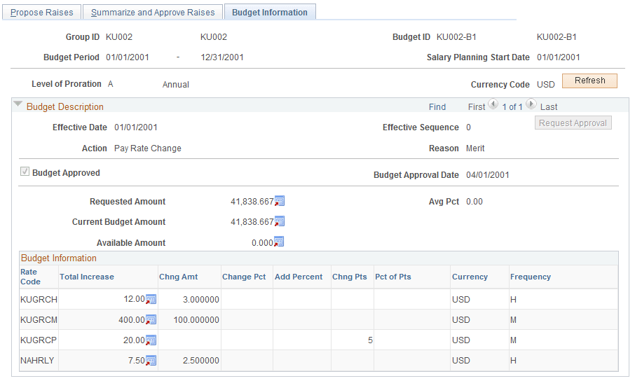

Budget Information Page
SAL_PLAN_GRP_BDGT
Display budget information.

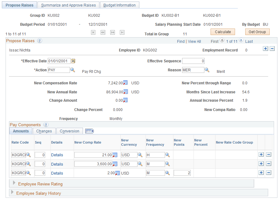

Propose Raises Page
Use the Propose Raises page (SALARY_PLAN_GRP) to apply the group increase budget to the pay components of the workers in the group.
You can manually enter pay components and modify salary increases for workers in the group.
Navigation:
Compensation, and then Base Compensation, and then Group Increases, and then Assign Group Increases, and then Propose Raises
This example illustrates the fields and controls on the Propose Raises page (1 of 4).
This example illustrates the fields and controls on the Propose Raises page - Pay Components: Changes tab (2 of 4).
This example illustrates the fields and controls on the Propose Raises page - Pay Components: Conversion tab (3 of 4).
This example illustrates the fields and controls on the Propose Raises page - Salary Grade tab (4 of 4).
Propose Raises page - Employee Salary History: Salary Grade tab (4 of 4)
You must create a group increase budget for the worker's group before using this page.
This process is recommended for calculating small groups.
Identifying the Budget
Field or Control Description
Salary Planning Start Date
Displays the salary planning start date that you associated with this budget ID on the Create/Approve Group Budget - Budget Description page.
Request Load
If you have workflow enabled, click this button after you have made all manual changes on this page and are ready to approve the salary plan and load the salary increases to the worker Job Data records. When you click this button, the system sends a worklist entry to the Personnel Administrator, who can then perform any necessary approvals and run the process to load the salary changes to Job.
This button is hidden if you do not enable workflow.
Total in Group
Displays the total number of workers in the group.
Calculate
Click to calculate and load the default budgeted increases for group members. Do not click this button if you use the Salary Plan Calculation process before accessing this page.
Note: Do not click this button after adjusting worker raises on this page unless you want to return to the budgeted increases without any modifications.
Get Group
Click to load the group into the page and to make sure the workers displayed in the page are currently eligible group members.
The system also updates the Total Annual Salaries on the Summarize and Approve Raises page when you click this button, because a change in the group affects the group's totals.
Note: When you refresh the group by clicking Get Group, the system does not calculate the default proposed budgeted increases for workers added to the group. The system loads the page in chunks of group members. Use the Previous and Next buttons to select the data of the worker you want to view.
Propose Raises
The system enters default proposed increases based on the budget that you identified when you entered the page. It applies calculations only to budgeted rate codes that are already in the worker's compensation package. If you want to add additional salary components to the worker's compensation package or to increase components that were not originally budgeted, add these manually in the Pay Components grid on this page.
Effective Sequence
Select the sequence number of the action that you defined for the budget increase on the Create/Approve Group Budget - Budget Requested page.
This sequence number determines the order in which the salary increases are compounded if more than one action and reason appears in the budget for the same effective date. For example, suppose the first action and reason results in an increased amount of compensation for a rate code from 50,000 USD to 53,000 USD. The second action and reason results in an additional 3 percent for the same rate code. Because of the sequence, the system calculates and adds 3 percent of 53,000 USD.
Action and Reason
Select the action and reason that you defined for the budget increase on the Create/Approve Group Budget - Budget Requested page.
New Compensation Rate
Displays the worker's new compensation rate as of the effective date, sequence, action, and reason. The Job Curr/Freq field displays this new compensation rate.
New Percent through Range
Displays the worker's new percent in range. The system calculates the percent in range figure from the data in the Salary Grade table.
New Annual Rate
The system calculates and displays the worker's new annual rate by applying the budgeted increase for this effective date, sequence, action, and reason to the applicable rate codes in the worker's compensation package.
Months Since Last Increase
Displays the number of months since the worker's last increase.
Change Amount
Displays the amount of the worker's total increase for this effective date, sequence, action, and reason for all components of the budget that are in the worker's compensation package.
Annual Increase Percent
Displays the worker's annualized change in terms of percent.
Change Percent
Displays the worker's total percent increase by applying the effective date, sequence, action, and action reason to all of the budget increase components that are in the worker's compensation package.
New Compa Ratio
Displays the worker's new compa-ratio. The system calculates the compa-ratio figure from the data in the Salary Grade table.
Frequency
Displays the currency code and frequency specified in the worker's Job record. The calculations appear in this currency and frequency.
Job Ratio
Displays the job ratio of the job code assigned to this worker. The job ratio is derived from the values in the Job Ratio group box on the Job Code Table - Default Compensation page and the worker's compensation rate.
Pay Components
The pay components listed in the grid are those defined on the Job Data - Compensation page. The grid is populated when you enter the page. When you click Calculate, the system applies the increases to the rate code. To recalculate and refresh the data on the Create/Approve Group Budget - Budget Requested page after you manually add or change data here, click the Refresh button in the Grand Total section of the Summarize and Approve Raises page.
Do not click the Calculate button after you make manual changes on this page because you will lose your manual changes. Instead, click the Refresh button in the Grand Total section of the Summarize and Approve Raises page. The Refresh button updates the requested budget on the Budget Requested page.
If a raise status is Processed, then this grid is not accessible.
Amounts Tab
Rate Code
Displays the rate codes in the worker's compensation package. If you are manually entering a new data row, you can select a rate code from the valid values.
Seq (sequence)
Displays the sequence number of the rate code in the compensation package.
Details
Click to view details about the rate code.
New Comp Rate (new compensation rate)
Displays the compensation rate for the rate code after applying the new amount, percent, or points.
New Currency
If you want the rate code to have a different currency, select that currency here. For points-type rate codes, this field is not available for change.
New Frequency
If you want the rate code to have a different frequency, select that frequency here. Valid values are stored in the Frequency table.
New Points
If you proposed an additional point value for the rate code, that new point value appears here.
New Percent
If you proposed a different percent value for the rate code, that new percent value appears here.
New Rate Code Group
You can select a different rate code group for the percent increase.
Changes Tab
Rate Code
Seq (sequence)
Change Amount
Displays the proposed change in the amount of compensation for the rate code, in the currency and frequency of the rate code.
Change Points
If the rate code type is Points, displays the proposed change in the points for the rate code. You can enter a value for a new data row if the rate code type is Points.
Change Percent
Displays the proposed percent of change in the compensation for the rate code.
Conversion Tab
Source
Indicates how the pay component got into the pay components grid. Values are:
  • Manual: The pay component was added manually.
  • Salary Step: The pay component was a default value from the salary step.
  • Job Code: The pay component was provided by default from the Job Code, and so on.
Default Without Override
Used for multiple components of pay.
Apply FTE
The system indicates whether Apply FTE is selected for this rate code in the Comp Rate Code table.
Convert Comprt (converted compensation rate)
Displays the compensation rate for the rate code converted to the worker's compensation frequency and currency.
Employee Review Rating
In this section, view the results of the worker's review. The fields in this section are the same as those on the Employee Review page.
Employee Salary History - Rates Tab
In this section, view each salary change in the worker's salary history over time. The fields in this section detail each salary change and are the same as those in the worker's Job record.
Job EffDt (job effective date) and Job EffSeq (job effective sequence)
The effective date and effective sequence of the change in the worker's compensation.
Action and Reason
The action and reason that resulted in the change in the worker's compensation, as recorded in the Job record.
Comp Rate (compensation rate)
The worker's compensation in the Job record for the job effective date, job effective sequence, action, and reason.
Currency and Frequency
The currency and frequency of the worker's compensation in the Job record for the job effective date, job effective sequence, action, and reason.
Change Percent and Change Amount
The percent of change and amount of change in the worker's compensation for the job effective date, job effective sequence, action, and reason.
Employee Salary History - Salary Grade Tab
Salary Set ID
The setID associated with the worker's salary.
Sal Plan (salary plan) and Grade
The salary plan and salary grade associated with the worker's job row.
Comp-Ratio (compa-ratio)
The worker's compa-ratio for this job row, calculated from data in the Salary Grade table.
Month Last Incr (month last increase)
The number of months since the previous salary increase.

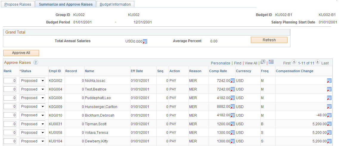

Summarize and Approve Raises Page
Use the Summarize and Approve Raises page (SAL_PLAN_GRP_APPR) to show the totals by effective date, effective sequence, action, and action reason as well as the overall grand totals of your planned salary increases.
Navigation:
Compensation, and then Base Compensation, and then Group Increases, and then Assign Group Increases, and then Summarize and Approve Raises
This example illustrates the fields and controls on the Summarize and Approve Raises page.
Budget Period
Displays the start and end dates that you defined for this budget ID.
Displays the salary planning start date that you defined for this budget ID.
Approve All
Once you have finalized the plan, click Approve All to mark all increases with the Approved status. Increases must have the Approved status to be loaded into the workers' job records by the Load Salary Changes process.
Grand Total
Displays the total of all of the salaries in the salary plan.
Average Percent
Displays the percentage of increase between the sum of the annualized salaries as of the start date of the plan and the calculated increased salaries in the plan.
Refresh
Click this button after you modify the salary increase plan. The system updates the Grand Total.
Approve Raises
Displays the following information for each worker in the group. With the exception of the Rank and Status fields, this information is identical to the information on the Propose Raises page.
Rank
Enter a rank number if you want the workers to appear in an order other than by worker ID. Use this field for force ranking, such as listing workers from the highest increase to the lowest.
Status
Select Approved, Ineligible, No Incr (no increase), Processed, or Proposed. The default is Proposed.
You cannot change the status to Processed. The Load Salary Changes process sets the status to Processed when it loads increases to JOB.
Note: If the status is Processed, then you cannot modify the status manually.
Name
Displays the name of each member of the group.
Compensation Change
Displays the change in the worker's compensation.
Use the Budget Information page (SAL_PLAN_GRP_BDGT) to display budget information.
Navigation:
Compensation, and then Base Compensation, and then Group Increases, and then Assign Group Increases, and then Budget Information
This example illustrates the fields and controls on the Budget Information page.
This page is display only. The information is similar to that found on the Budget Requested and Budget Components pages.
Refresh
Click to update the Requested Amount and Available Amount.
Available Amount
Represents the difference between the Current Budget and Requested Budget. It is calculated when you click Refresh or save the component.
If the variance is a positive amount, the salary plan exceeds the budgeted amount. If the variance is a negative amount, the planned salaries fall short of the budgeted amount.
Request Approval
This button appears only if the budget is approved.
If the Available Amount is negative and the budget was approved, you must request a new approval because you will not be able to save without requesting a new approval if the Available Amount is negative.
If you do not want to request a new approval, you have to leave the component without saving.
If you request a new approval, the budget will be unapproved and the Budget Approval Date will be deselected. These changes will be reflected in the Budget Requested pages.
