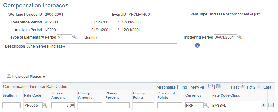

Salary Increase event setup or Compensation Increases Page
Use the Salary Increase event setup or Compensation Increases page (LMS_INCREASE) to define a compensation increase event.
Navigation:
  • Set Up HCM, and then Product Related, and then Compensation, and then Forecast Compensation FRA, and then Salary Increase event setup, and then Salary Increase event setup
  • Compensation, and then Forecast Compensation FRA, and then Define Forecast Data, and then Compensation Increases, and then Compensation Increases
This example illustrates the fields and controls on the Compensation Increases page.
Field or Control Description
Individual Measure
Select if the increase is an individual measure. This check box relates to La Masse Salariale method of analysis. It classifies compensation increases into three categories: general increases (applies to the overall simulated population); increases by category (a category being a subset of the overall simulated population); and individual measure (the compensation increase is an increase for an individual).
To simulate general increases, deselect this check box.
See Understanding Salary Plans.
Compensation Increase Rate Codes
Define the rate codes to be increased. All people in a group with a compensation package containing specified compensation rate codes receive the increase that is specified on this page as of the triggering period of this event.
Select the way to change a person's compensation for a given rate code from these choices: Percent Amount, Change Amount, Change Percent, Change Points, Percent of Points, Currency, and Rate Code Class.
Specify any components of pay and any increases. Depending on the component type, fill in the fields as follows. (Fields not related to certain component types are unavailable for selection.)
If the component type is flat amount or hourly, enter either a Percent Amount or a Change Amount.
If the component type is percentage, enter only a Change Percent.
If the component type is points, enter either a Percent of Points or a Change Points.
