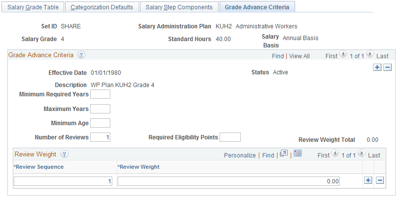

Grade Advance Criteria Page
SAL_GRD_REV_JPN
Specify grade advance criteria used in the Shohkaku (Grade Advance) candidate process.

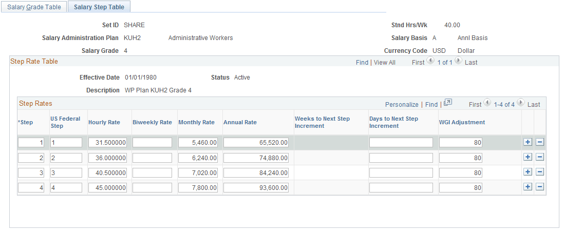

(USF) Salary Step Table Page
GVT_SAL_GRADE_TBL2
Associate salary components with salary steps within a salary grade. The information you set up here is used as default compensation data when your workers move into a specific step.

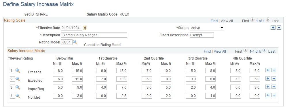

Define Salary Increase Matrix Page
Use the Define Salary Increase Matrix page (SALARY_MATRIX_TBL) to establish the minimum and maximum percentage increases permitted for each review rating by quartile.
Navigation:
  • (Classic) Compensation, and then Base Compensation, and then Maintain Plans, and then Define Salary Increase Matrix, and then Define Salary Increase Matrix
  • (Fluid) Select the Workforce Administrator home page and click the Compensation Administration tile. On the left navigation, select Compensation Configuration, and then Define Salary Increase Matrix
This example illustrates the fields and controls on the Define Salary Increase Matrix page.
Rating Scale
Field or Control Description
Rating Model
Select a rating model to associate with the matrix. Rating models are defined on the Rating Model page.
See PeopleSoft Human Resources Manage Profiles: Understanding the Content Catalog.
Review Rating
Select from the list of ratings in the rating model associated with the rating scale that you selected.
Below Min (below minimum)
Enter the percentage increase of a worker's existing salary. The below minimum range is for those workers whose salaries are below the amount for the first quartile.
Note: This column is optional because some organizations do not permit salaries that are below the minimum.
1st Quartile to 4th Quartile
For each quartile, enter the percentage increase of a worker's existing salary.
If you use a structure other than quartiles as the basis for establishing salary matrices in your organization, you can modify this page to accommodate your requirements. To do this, ask your human resources project leader or refer to the PeopleTools documentation.

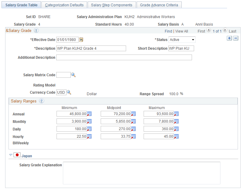

Salary Grade Table Page
Use the Salary Grade Table page (SALARY_GRADE_TBL1) to specify the minimum, maximum, and midpoint rates for salary grades.
Set up several salary grades, in ascending or descending order, within the same salary administration plan. To create different ranges for the same salary grade, use a separate salary administration plan for each.
Navigation:
  • (Classic) Compensation, and then Base Compensation, and then Maintain Plans, and then Define Salary Grades, and then Salary Grade Table
  • (Classic) Compensation, and then Base Compensation, and then Maintain Plans, and then Define Salary Grades USF, and then Salary Grade Table
  • (Fluid) Select the Workforce Administrator home page and click the Compensation Administration tile. On the left navigation, select Compensation Configuration, and then Salary Grades
This example illustrates the fields and controls on the Salary Grade Table page.
Before using this page, set up a salary administration plan on the Define Salary Plan page.
Salary Grade
Additional Description
Enter information that will supplement the salary grade (ID) and description. For example, you might use the field to store an additional internal name for the grade, such as "Associate Managers" to supplement a simple description such as "Grade 4."
Salary Matrix Code
If you selected a default salary matrix code on the Define Salary Plan page, the system enters that code as the default. You can override the default.
Rating Model
If you selected a default salary matrix code on the Salary Plan Table setup page, the system displays the Rating Model that is tied to the salary matrix.
Currency Code
Displays the currency code that you selected for the Salary Administration Plan on the Salary Plan Table setup page. You can change the currency code.
Range Spread
The system calculates the range spread percentage by dividing the salary maximum amount by the minimum amount and then subtracting 1.0.
Salary Ranges
Minimum and Maximum
Enter the minimum and maximum salary in either the Annual, Monthly, Daily, or Hourly field row. Enter the range in one frequency; the system calculates the minimum and maximum in the other frequencies.
(USF) Bi-Weekly is also a frequency option.
Midpoint
The system calculates the midpoint as the maximum plus the minimum divided by 2. You can override this default.
Annual, Monthly, Daily, Hourly, and Bi-Weekly
Enter the annual, monthly, daily, hourly, or bi-weekly salary range, depending on how you quote the salary for this grade. If you leave the rows blank, the system calculates the values.
(JPN) Japan
Salary Grade Explanation
Use this field to store information such as capability grade requirements and the corresponding supervisor level.

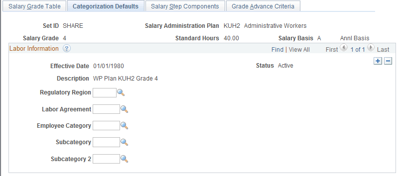

Categorization Defaults Page
Use the Categorization Defaults page (SALARY_GRADE2_TBL) to associate the salary grade with labor agreement categories and subcategories.
Before using this page, define labor agreements, categories, and subcategories on the Employee Categorization page.
Navigation:
Compensation, and then Base Compensation, and then Maintain Plans, and then Define Salary Grades, and then Categorization Defaults
This example illustrates the fields and controls on the Categorization Defaults page.
If the salary administration plan has a related wage progression rule, this page will not be available.
Regulatory Region
Select a regulatory region from the valid values that you set up on the Regulatory Region page.
Labor Agreement
Select a labor agreement from the valid values that you set up on the Employee Categorization page.
Employee Category, Subcategory, and Subcategory 2
Select, as necessary, from the available options.

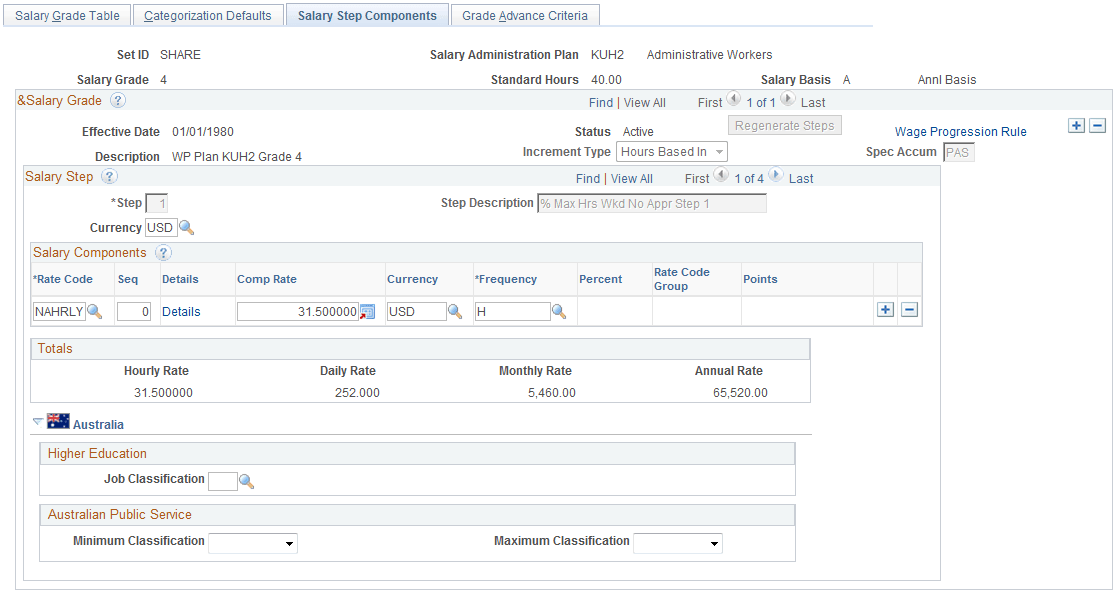

Salary Step Components Page
Use the Salary Step Components page (SALARY_GRADE_T3GBL) to associate salary components with salary steps within a salary grade.
The information that you set up here is used as default compensation data when your workers move into a specific step.
Navigation:
Compensation, and then Base Compensation, and then Maintain Plans, and then Define Salary Grades, and then Salary Step Components
This example illustrates the fields and controls on the Salary Step Components page.
Salary Grade
Increment Type
If you plan to run a process that automatically moves a worker to the next salary step, select from these values:
  • (None): Select to use no increments or to deselect any values that were entered in error.
  • Date Based: Select to move the worker into the next step based on the worker's entry date into this step. If you select this option, the Months to Next Step Increment field becomes visible.
  • Either: Select to use Date Based and Hrs Based at the same time. If you select this option, the Spec Accum (special accumulator), Months to Next Step Increment, and Hours to Next Step Increment fields become visible.
  • Hrs Based (hours based): Select for the worker's step increase to be based on a number of hours. If you select this option, the Spec Accum and Hours to Next Step Increment fields become visible.
  • Manual: Select to manually enter increments.
  • Wks Based (weeks based): This value is for U.S. federal government users only.
Generate Steps or Regenerate Steps
Click this button to calculate or recalculate the salary steps after you have changed the wage progression rules.
Wage Progression Rule
Click this link to access the Salary Plan Table2 page, where you can view wage progression rules associated with this salary grade.
If you selected an Increment Type of Either or Hrs Based, select a special accumulator. The system uses this accumulator to determine worker compensation.
See PeopleSoft Human Resources Manage Base Benefits: Setting Up Special Accumulators.
Salary Step
Step
If you are defining a new step or modifying a step, enter the step number.
Currency
Select a currency code for the step. The system enters the currency code that you entered in the Salary Grade table as the default value. You can change the currency code.
The system displays the compensation totals for the step on this page in the currency that you specify here.
If you select an Increment Type of Date Based or Either, enter the number of months that the worker must remain in this step before being eligible for the next step increment.
If you select an Increment Type of Either or Hrs Based, enter the number of hours that the worker must accumulate in this step before being eligible for the next step increment.
Salary Components
Rate Code
Select a rate code that you want to associate with this salary step. The valid values in the list are the base pay components that you defined on the Comp Rate Code table page.
The system automatically populates certain fields in the grid based on how you defined the rate code in the Compensation Rate Code table.
Seq (sequence)
The system displays 0 as the default Seq number. To avoid duplicate keys for data rows, enter 1 or higher if you associate the same rate code with the same step more than once.
Use the same rate code more than once to give the same rate code different compensation rates for the same step. This is useful for job splitting.
Details
Click this button to view details of the selected rate code and rate matrix, if applicable.
Comp Rate (compensation rate)
The system displays the default compensation rate that you defined for the rate code on the Comp Rate Code Table page. If the rate code type is Flat Amount, Hourly Rate, or Hourly Rate + Flat Amount, enter a compensation rate for the rate code in this salary step.
Note: This field is unavailable if you are using a rate code that has an associated rate matrix.
Currency
The system enters the default currency code that you defined for the rate code on the Comp Rate Code Table page. You can change the rate code's currency code for this salary step.
Frequency
The system enters the default Frequency ID that you defined for the rate code on the Comp Rate Code Table page. You can override that frequency here.
Percent
If the rate code type for this rate code is Percent, enter a percent for the rate code in this salary step.
Rate Code Group
If you selected the Use Rate Code Groups check box on the Installation Table - HCM Options page, you can apply the rate code percent to a rate code group. To do so, select a rate code group from the list of valid values. You define rate code groups on the Rate Code Groups page.
This field is hidden if you did not select Rate Code Groups in the Installation table.
Points
If the rate code type for this rate code is Points, assign points to the rate code for this salary step. Set up the value of each point at the company level on the Company - Default Settings page.
This field is hidden if you did not select the Salary Points check box on the Installation Table - HCM Options page.
Totals
The system calculates and displays the total value of the pay components that you assigned to the step. When you save the page, the system warns you if the total is outside the minimum or maximum ranges that you specified on the Salary Grade Table page.
Hourly Rate, Daily Rate, Monthly Rate, and Annual Rate
The system displays these total values of all the rate codes of the salary step.
Note: When comparing the hourly rate to the maximum of the step rate, the system does not use rounding. Instead, it uses six decimal places to verify if the hourly rate is less than the maximum rate. Once this check is performed, the system displays the final number for the hourly rate, rounded to two decimal places.
(AUS) Australia
This group box appears only if the Education & Government check box on the Installation Table - Country Specific page is selected.
Job Classification
Select the DETYA job classification.
Minimum Classification and Maximum Classification
For Australian Public Service, select the minimum and maximum classifications for this salary step.
Use the Grade Advance Criteria page (SAL_GRD_REV_JPN) to specify grade advance criteria used in the Shohkaku (Grade Advance) candidate process.
Navigation:
Compensation, and then Base Compensation, and then Maintain Plans, and then Define Salary Grades, and then Grade Advance Criteria
This example illustrates the fields and controls on the Grade Advance Criteria page.
Minimum Required Years
Enter the number of years workers must be in this grade before they can advance from it. This value is the minimum number of years required in the grade.
Maximum Years
Enter the maximum number of years workers can be in this grade. When checking for workers eligible for advancement from this grade, the system automatically includes those who have been in the grade this number of years, irrespective of all other criteria.
Minimum Age
Enter the minimum age workers must be to be eligible to advance from this grade.
Note: This criterion refers to workers' education level age, not their actual age.
Number of Reviews
Enter the number of reviews the results of which the system will use to assess a worker's eligibility to advance from this grade. If you enter 3, for example, the system will count the results from the most recent review, the review before that, and the review before that. Only reviews that have the Include in Grade Advance check box selected on the Review Definition Table JPN page are included in this process.
Required Eligibility Points
This is the total number of eligibility points a worker must have attained to be eligible to advance from this grade.
Review Weight Total
The system keeps a running count of the weightings you add to the reviews in your Review Sequence. The total must be 100 when you have entered all the weightings. The system warns you if the sum of your weightings is not 100.
Review Sequence
Enter a sequence number for the Number of Reviews you specified. Sequence number 1 is the most recent review, 2 is the review before that, and 3 is the review before that. The system uses the Review ID (which is a date) to associate the correct review with the correct sequence number and, therefore, the correct weighting.
Note: If you have more reviews defined as applicable for grade advance than you specify here, it does not matter. If you are only going back two reviews, the system ignores any earlier reviews even if they are defined as applicable for grade advance. You do not have to go back to the Review Definition Table JPN page and deselect the Include in Grade Advance check box. If the opposite is true—that is, you specify more reviews here than are defined as applicable for grade advance—the system warns that it was unable to get data when attempting to get review results.
If you do not want to weight the reviews, and you are using the non-weighted average review method, then enter the Number of Reviews and leave the Review Sequence(field) and Review Weight (next field) blank. The system will divide the review total by the number of reviews used in the calculation.
Review Weight
Unless you are using the non-weighted "simple average" method to determine the number of points, enter the weighting for each review in the sequence.
Use the Salary Step Table page (USF) (GVT_SAL_GRADE_TBL2) to associate salary components with salary steps within a salary grade.
Navigation:
Compensation, and then Base Compensation, and then Maintain Plans, and then Define Salary Grades USF, and then Salary Step Table
This example illustrates the fields and controls on the Salary Step Table page.
Salary Basis
Displays the salary basis.
Federal Step
The step that is associated with the Federal pay plan.
Biweekly Rate
Displays the total biweekly rate value of all the rate codes of the salary step in the currency of the salary step.
Weeks to Next Step Increment
The number of weeks before the worker is moved into the next step based on the worker's entry date into the current step.
Days to Next Step Increment
The number of days before the worker is moved into the next step based on the worker's entry date into the current step.
WGI Adjustment (within grade increase adjustment)
Define the leave without pay (LWOP) threshold hours. This is the number of consecutive LWOP hours before the within grade increase (WGI) due date is affected. The WGI/Tenure Update process compares threshold hours to the worker's unprocessed nonpay hours to determine if the worker's WGI due date was affected.
See PeopleSoft Payroll for North America: Processing WGI, Tenure, and Probation Nonpay Hours.
