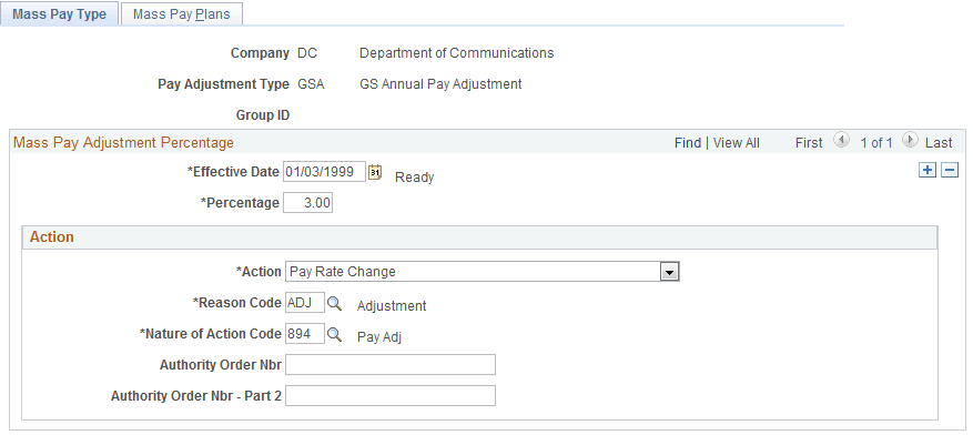

Mass Pay Type Page
Use the Mass Pay Type page (GVT_MPA_TYPE_TBL) to define the percentage of the pay increase and the date that the pay adjustment will go into effect.
In addition, adjustment control information, such as Action, Reason Code, and NOA code data is necessary for the SF50.
Navigation:
Set Up HCM, and then Product Related, and then Payroll for North America, and then Compensation and Earnings, and then Mass Pay Adjustments USF, and then Mass Pay Type
This example illustrates the fields and controls on the Mass Pay Type page.
Mass Pay Type page
Field or Control Description
Group ID
Displays the group ID that you entered in the search criteria to access the page.
Specifying a group ID enables the FGPY005 application engine program to process mass pay adjustments for that group of employees rather than all employees, thereby reducing performance time.
Percentage
Specify the percentage of increase for the pay adjustment. If the calculation type on the Mass Pay Plan equals Percent, the system will use the value in this field. The Effective Date and Percentage entered become part of the key fields in the Mass Pay Plan table.
Action
Specify the appropriate action code for this mass pay adjustment. The value selected here will be reflected on the Data Control page at the worker level.
Reason Code
Enter the corresponding reason code for the specified action. The value selected here will be reflected on the Data Control page at the worker level.
Nature of Action Code
Enter the nature of action (NOA) code that justifies this mass pay.
Authority Order Nbr (authority order number)
Use this free-format field to enter the executive order number or other legal authority number that identifies which executive order was issued for pay raises. This information will print on SF50.

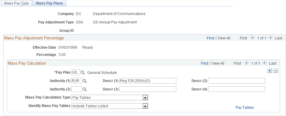

Mass Pay Plans Page
Use the Mass Pay Plans page (GVT_MPA_ERNPGM_TBL) to identify the pay plan to be included in the pay adjustment processing as well as the type of calculation to be used.
Navigation:
Set Up HCM, and then Product Related, and then Payroll for North America, and then Compensation and Earnings, and then Mass Pay Adjustments USF, and then Mass Pay Plans
This example illustrates the fields and controls on the Mass Pay Plans page.
Mass Pay Plans page
Group ID
Pay Plan
Enter the pay plan for the group of workers to receive the pay adjustment. You can include multiple pay plans, if necessary.
Authority (1) and Authority (2)
Enter the legal authorities for the mass pay adjustment.
Mass Pay Calculation Type
Specify the type of calculation to be used in pay adjustment processing: Pay Tables, Percentage, or Special Calculation Routine.
Identify Mass Pay Table
Specify which pay table entries should be included or excluded from the pay adjustment. Values are Exclude Tables Listed, Include All For Pay Plan, and Include Tables Listed. Unless all pay tables are to be included in processing pay adjustments, the Pay Tables link will appear, enabling you to specify the appropriate selections.
Pay Tables
Click to access the Mass Pay Adjustment Pay Tables page (GVT_MPA_PAYTBL_SEC) to specify the pay tables to include or exclude when processing this mass pay adjustment.

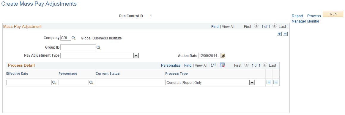

Create Mass Pay Adjustments Page
Use the Create Mass Pay Adjustments page (RUN_FGPY005) to indicate the parameters required to process the mass pay adjustments or, alternatively, to generate a report.
You can process a single agency and pay adjustment type or multiple agencies and adjustment types.
Navigation:
Set Up HCM, and then Product Related, and then Payroll for North America, and then Compensation and Earnings, and then Create Mass Pay Adjustment USF, and then Create Mass Pay Adjustments
This example illustrates the fields and controls on the Create Mass Pay Adjustments page.
Group ID
Select the group ID to process.
Selecting a group ID enables the FGPY005 application engine program to process mass pay adjustments for that group of employees rather than all employees, thereby reducing performance time.
Pay Adjustment Type
Select the type of pay adjustment to be processed by agency. You can process multiple agencies and pay adjustment types.
Percentage
Specify the percentage of the pay adjustment.
GVT Mass Pay Adj Process Act (government mass pay adjustment process action)
Indicate whether you want to generate a report only or process the action and produce a report.
Important:
Run the Mass Pay Adjustments Application Engine process before you run the Mass Pay Adjustments SQR report.
Make sure that an entry for Mass Pay (FGPY005) for the USFED transaction appears on the Transaction Setup page (Set Up HCM, and then Product Related, and then Workforce Administration, and then Workforce Data USF, and then Approval Transaction setup). Click the Batch Programs tab to verify that the USFED transaction is included.

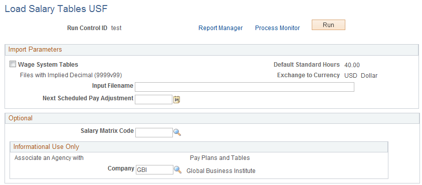

Load Salary Tables USF Page
Use the Load Salary Tables USF page (RUNCTL_FGHR029) to load salary adjustment information from a file into the system for a particular company.
Navigation:
Set Up HCM, and then Product Related, and then Payroll for North America, and then Compensation and Earnings, and then Load Salary Tables USF, and then Load Salary Tables USF
This example illustrates the fields and controls on the Load Salary Tables USF page.
Wage System Tables
Select this check box if you want the system to import information from the tables containing data for wage system employees.
Input Filename
Enter the path to the file from which you want to load salary table information.
Next Scheduled Pay Adjustment
Select or enter the date of the next scheduled pay adjustment.
Salary Matrix Code
Select the salary matrix code. Salary matrices define the common characteristics of a salary plan.
Company
Select the name of the company for which you wants to load salary table information.
