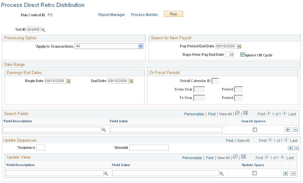

Process Direct Retro Distribution Page
Use the Process Direct Retro Distribution (process direct retroactive distribution) page (RUN_HP_RETDISTSRCH) to do the following.
  • Enter search criteria to specify which records to modify.
  • Indicate which field values the system should update and with what values.
  • Run the Retro Distribution (retroactive distribution) process.
Navigation:
  • Payroll for North America, and then Payroll Distribution, and then Commitment Accounting CAN, and then Process Direct Retro Dist, and then Process Direct Retro Distribution
  • Payroll for North America, and then Payroll Distribution, and then Commitment Accounting USA, and then Process Direct Retro Dist, and then Process Direct Retro Distribution
This example illustrates the fields and controls on the Process Direct Retro Distribution page.
The Direct Retro Distributions process does not apply any changes to the database. If this process produces warnings or errors (viewed in the Review Retro Distributions Msgs components) you can rerun this process with different parameters.
Processing Option
Field or Control Description
Apply to Transactions
  • Select All to process earnings, deductions, and tax transactions.
  • Select Deductions, Earnings, or Tax to process only that kind of transaction.
  • Select Deductions and Taxes, Earnings and Deductions, or Earnings and Taxes to process two of the three kinds of transactions.
Search for Next Payroll
Pay Period End Date
The pay period end date defaults the end date closest to, but not included in, the last CA GL Interface process run. Enter a new pay period end date, if necessary.
The system only processes pay periods that have not been processed by the CA GL Interface.
Days Prior End Date
Enter the number of days prior to the posting date of the pay calendar.
Ignore Off Cycle
Select to ignore off cycle pay calendars.
Transaction Date Range
The process searches for the earnings end dates that fall within the date range you specify.
Begin Date and End Date
Enter the transaction begin and end dates. Clear these fields to use fiscal periods as the date range.
Or Fiscal Periods
Detail Calendar ID
Select a detail calendar ID.
From Year/Period and To Year/Period
Enter the year and period from and to which you want to process.
Search Fields
Field Description and Field Value
Select the fields and the field values of the records you want the process to search for.
Search Spaces
Select to have the system search for blank field values.
Update Sequences
Sequence (sequence number)
Enter the sequence in which this funding amount should be used.
Amount
Enter the funding amount.
Update Value
Field Description and Field Values
Select the fields in the selected records that should be updated and the values they should be updated with.
Update Space
Select to have the system update spaces.
