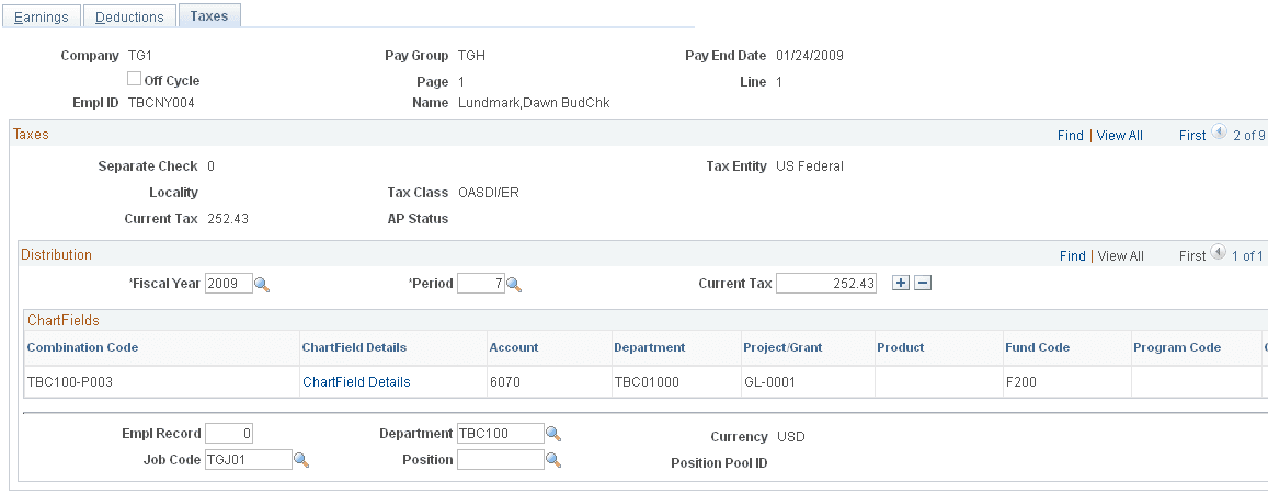

Review Actuals Distribution - Taxes Page
(USA, USF) Use the Review Actuals Distribution - Taxes page (PAY_CHECK_DIST_TAX) to view and modify the actuals distribution after running the Actuals Distribution process and prior to posting to general ledger.
(CAN) The Review Actuals Distribution - Taxes page (PAY_CHECK_DIST_CTX) for Canada is similar to the page for USA.
Navigation:
  • Payroll for North America, and then Payroll Distribution, and then Commitment Accounting USA, and then Review Actuals Distribution, and then Taxes
  • Payroll for North America, and then Payroll Distribution, and then Commitment Accounting USF, and then Review Actuals Distribution, and then Taxes
  • (Payroll for North America, and then Payroll Distribution, and then Commitment Accounting CAN, and then Review Actuals Distribution, and then Taxes)
This example illustrates the fields and controls on the Taxes page (1 of 2).
This example illustrates the fields and controls on the Taxes page (2 of 2).
Actuals Distribution Summary page (2 of 2)
More of the page exists than is shown in the example. Scroll horizontally in the database to view fields in the entire ChartFields group box.
You can fund the tax from multiple combination codes by entering more than one row.
Field or Control Description
Current Tax
Enter the amount of the Current Tax to be funded by this combination code. The total of the values in the Current Tax field must equal the amount in the Current Tax field in the upper group box.
Account
If tax account mapping is enabled for the corresponding department budget, this field is available for entry. When the ChartField Details column is visible, it will contain a link to the page where the user may select a combination code or account value that determines the value of the Account field on the Taxes page.
