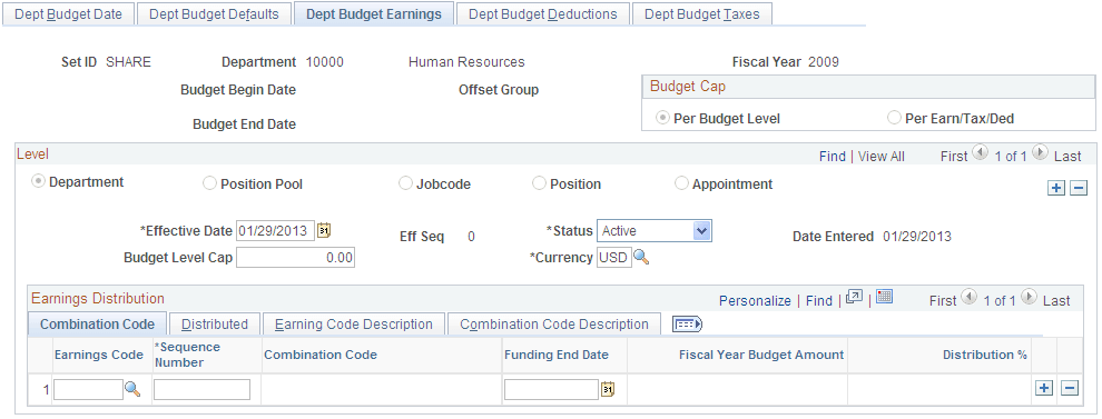

Understanding the Dept Budget Earnings Page
The system uses the combination code information from the Department Budget Earnings page when processing encumbrances and actuals distribution if there isn't a person-specific combination code override.
For encumbrance calculations, a combination code override can be entered on Job Earnings Distribution page (JOB_DATA_ERNDIST) or Job Data - Payroll page (JOB_DATA2). For actuals distribution process, the combination code override is automatically populated from the Job Earnings Distribution page, the Job Data - Payroll page, and the Additional Pay page (ADDITIONAL_PAY1). Otherwise, the override can manually entered on paysheet pages (PAY_SHEET_ADD_S, PAY_SHEET_LINE_S, PAY_SHEET_LN_S, PAY_OL_SHEET_S1).
When you run the encumbrance process to calculate encumbrance data, the system looks first for a combination code on the Job Earnings Distribution page. If no code is specified there, it next looks for a combination code on the Job Data - Payroll page, and if that code doesn't exist, it looks for combination code information on the Department Budget Earnings page. The system looks first for appointment level funding, then position or job code level funding, the position pool, and finally department level funding. To calculate pre-encumbrance data, the system looks for combination code information on the Department Budget Earnings page. The system looks first for the position, then the position pool and finally department level funding.
The encumbrance process looks first for an entry with the earnings code you've defined as regular for your organization, then at the default funding source (blank earnings code).
Similarly, when you run the Actuals Distribution process (PSPPFUND) to distribute your actuals across funding sources and accounting periods, the system looks first for a combination code specified on the Paysheet record (PAY_EARNINGS), which originates from the Job Earnings Distribution page or the Job Data page, and which you can override on the Paysheet. If there is no code specified there, then it looks at the combination code information on the Department Budget Earnings table.
The system performs fund checking when you run the Actuals Distribution process (PSPPFUND). If there is insufficient budget to distribute all or part of a person's earnings, benefits, or employer-paid taxes, the system generates messages to the Pay Messages component (PAY_MESSAGES) and distributes the unfunded amount to suspense combination code. If the budget is sufficient to cover part of the earnings, benefits, or taxes, then that part is distributed. Note also that funds checking is performed against the information on the Dept Budget pages (and not against the Overall/Detail caps; the latter are used to edit the budget amounts).
During this processing, the system searches active budget levels and stops using a funding source if a funding end date is specified and the processing occurs at a later date. For actuals distribution, the earnings end date is used for comparison with the funding end date.
To create multiple funding sources, insert multiple entries (there is no limit) to specify additional funding source. However, be aware of the following guidelines:
  • Enter either a budget amount or a percentage of distribution (Distrib %) in each row.
  • If you have some dollar-limited funding sources (budget amount) and others that are unlimited (percentage of distribution), assign lower sequence numbers to the limited entries and higher sequence numbers to the unlimited entries.
  • When you use percentages (Distrib %), the sum of percentages for all funding source (combination code) must equal 100.
  • When the Default Funding Source Option on the Dept Budget Data page is either Actual or Earnings, you must enter one earnings distribution record with a blank earnings code.
Although you can choose to set up budgeting and funding at the department, position pool, job code, position, or appointment (EmplID) levels, the system stores actuals and encumbrance information at the lowest level, even if you define your budgeting and funding for the entire department. In this way, if you change the levels during your fiscal year, the system calculates the encumbrances and actuals according to your new funding levels.

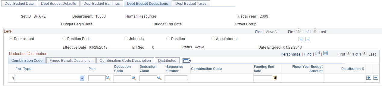

Overview of the Dept Budget Deductions Page
When you run the Actuals Distribution process, the process distributes to the override combination code specified on Job Data - Payroll page. If there is no override, the process distributes actual employer-paid deductions across the funding sources defined on Dept Budget Deduction page.
The system searches active budget levels and stops using a funding source if a funding end date is specified and the processing occurs at a later date. For actuals distribution, the earnings end date is used for comparison against the funding end date.
Unlike the Dept Budget Earnings page, the information specified here isn't used during encumbrance processing. Information specified on the Encumbrance Definition component is used for that purpose.
When the default funding source option is Actual or Earnings the system creates a Dept Budget Deductions record using the earnings combination code as a default combination code.

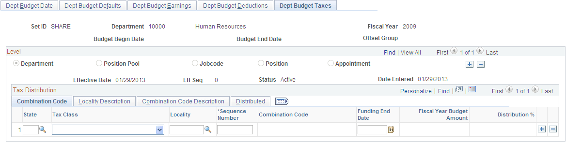

Overview of the Dept Budget Taxes Page
When you run the Actuals Distribution process, the process distributes to the override combination code specified on Job Data - Payroll page as the override. If there is no override, the process distributes actual employer-paid taxes across funding sources defined on Dept Budget Taxes page.
The system searches active budget levels and stops using a funding source if a funding end date is specified and the processing occurs at a later date. For actuals distribution, the earnings end date is used for comparing against the funding end date.
The system ignores budget levels that have become inactive. It also stops using a funding source if a funding end date is specified and the processing occurs at a later date. For actuals distribution, the earnings end date is used for comparing against the funding end date.
Unlike the Dept Budget Earnings page, the information specified here isn't used during encumbrance processing; information specified on the Encumbrance Definition component is used for that purpose. Also unlike earnings information, you cannot override funding sources for employer-paid taxes at the job data or paysheet level.
When the default funding source option is Actual or Earnings the system creates a Dept Budget Tax record using the earnings combination code as a default combination code.
The Dept Budget Taxes page is virtually the same on the Department Budget Table CAN and Department Budget Table USA components. There are two small differences:
  • The Dept Budget Taxes (U.S.) page has a State field; the Dept Budget Taxes (CAN) page has a Province field.
  • The Dept Budget Taxes (U.S.) page has a Locality field; the Dept Budget Taxes (CAN) page doesn't.

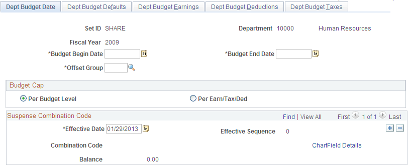

Dept Budget Date Page
(CAN) Use the Dept Budget Date (department budget date) page (DEPT_BUDGET_DATE) to define the fiscal year budget's begin and end-dates as well as other department budget information.
(USA) The Dept Budget Date (department budget date) page (DEPT_BUDGET_TAX) for USA is similar to the one for Canada.
Navigation:
  • Set Up HCM, and then Product Related, and then Commitment Accounting, and then Budget Information, and then Department Budget Table CAN, and then Dept Budget Date
  • Set Up HCM, and then Product Related, and then Commitment Accounting, and then Budget Information, and then Department Budget Table USA, and then Dept Budget Date
This example illustrates the fields and controls on the Dept Budget Date page.
The options on the Dept Budget Date page are available only when you create a new department budget or access an existing budget in correction mode.
Field or Control Description
Budget Begin Date and Budget End Date
Enter the begin and end dates of this department budget.
Offset Group
Enter an offset group to specify the offset combination code to be used for each type of transaction.
Budget Cap
Budget Cap
Specify the type of budget cap for this department budget. At each budget level, define a cap as follows:
  • Per Budget Level (that is, for all expenditures combined): Sets a spending limit for each budget level and takes into account all earnings, deductions, and taxes budgets. This cap ensures that the sum of all lower-level budgets doesn't exceed a higher-level budget cap. It isn't used for checking funds during the processing of encumbrance and actuals. Instead, use the budget amounts specified for each entry on the Department Budget Earnings, Deductions, and Taxes pages.
  • Per Earn/Tax/Ded (that is, separately for earnings, deductions, and taxes): Enables you to define budget caps separately for earnings, deductions, and taxes.
Overall budget and earnings caps are maintained on the Dept Budget Earnings page. Separate caps for taxes and deductions are maintained on the Dept Budgets Deduction and Dept Budget Taxes (U.S. and Canada) pages, respectively.
Suspense Combination Code
Combination Code
Select the ChartField Details link to specify a suspense combination code. The encumbrance and actuals processes will charge all unfunded amounts to this account enabling the encumbrance and actuals processes to continue posting to the specified combination code even when the funding source is exhausted or inactive. Indicate at least one suspense combination code and indicate the effective date of the suspense combination code for each department budget.
The combination code you use here cannot be used anywhere else in the department budget.
Don't correct this combination code after it has been used; instead, enter a new, effective-dated suspense combination code.
See Application Fundamentals: Editing ChartField Combinations in HCM Transactions.

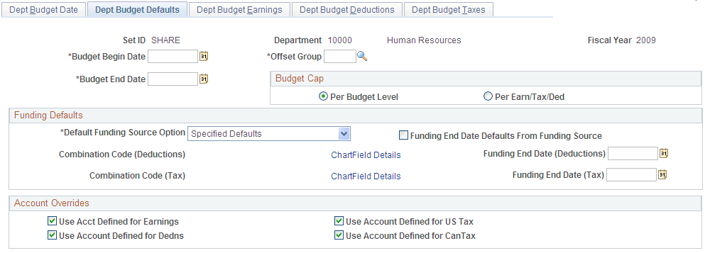

Dept Budget Defaults Page
Use the Dept Budget Defaults (department budget defaults) page (DEPT_BUDGET_DFLT) to set up budget defaults, such as funding source option, default deduction and tax funding sources.
Navigation:
  • Set Up HCM, and then Product Related, and then Commitment Accounting, and then Budget Information, and then Department Budget Table CAN, and then Dept Budget Defaults
  • Set Up HCM, and then Product Related, and then Commitment Accounting, and then Budget Information, and then Department Budget Table USA, and then Dept Budget Defaults
This example illustrates the fields and controls on the Dept Budget Defaults page.
Funding Defaults
Indicate if the Default Funding Source Option is Specified Defaults, Distrib over Actual Earnings or Earnings Funding Source If there is no Default Funding Source Option, select No Defaults.
The default value, whether you create a budget manually or use one of the budget creation processes, is Actual Distrib over Actual Earnings. The system uses the funding source (combination code) specified for earnings as a default for deductions and taxes and distributes deductions and taxes over actual earnings unless you specify funding sources on the Dept Budget Deductions and Dept Budget Taxes pages.
When Distrib over Actual Earnings or Earnings Funding Source is the Default Funding Source Option, the system hides the Combination Code (Deductions), Funding End Date (Deductions), Combination Code (Tax), and Funding End Date (Tax) fields and the system uses the funding source (combination code) specified for earnings as a default for deductions and taxes.
When you select Specified Default, the system displays the Combination Code (Deductions), Funding End Date (Deductions), Combination Code (Tax), and Funding End Date (Tax) fields for you to specify the default funding options.
Funding End Date Defaults From Funding Source
Select this check box if you want the default funding end date for all new earnings, deductions, and tax rows, and for new encumbrance definitions, to be the funding end date from the Funding Source Information page.
This option applies regardless of the method you use to create your fiscal year budget.
Note: Changes on the Funding Source Information page do not affect existing funding end dates in the department budget; the system uses this setting only to set the default funding end date in newly created rows of budget data.
Exclusion Fringe Group
Select a group of fringe expenses to exclude from funding from the earnings funding source. This field is informational only and will be used as a default on Dept Budget Earnings page.
This field is available only when the Default Funding Source Option is Actual or Earnings.
If the Default Funding Source Option is Actual, enter a default combination code for deductions. The value in appears in the Combination Code field on the Dept Budget Deductions page, but you can override it.
Enter the date (if applicable) on which the deductions combination code ends. If you do not enter a date, the system creates encumbrances for the current fiscal year only, but the funding source remains available for future fiscal years.
If the Funding End Date Defaults From Funding Source field is selected, the default value is the funding end date that is defined on the Funding Source Information page.
Enter a default combination code for taxes. The value appears in the Combination Code field on the Dept Budget Taxes page, but you can override it.
Enter the date (if applicable) on which the tax combination code (funding source) ends. If you do not enter a date, the system creates encumbrances for the current fiscal year only, but the funding source remains available for future fiscal years.
Account Overrides
Use Acct Defined for Earnings, Use Acct Defined for Dedns, Use Acct Defined for US Tax, and Use Acct Defined for Can Tax
Select to enable account mapping for earnings, deductions, U.S. taxes, or Canadian taxes. The Actuals Distribution uses the account mapping you set up on the account mapping tables to map earnings, deductions, or taxes to a different account than the one associated with the specified combination codes.
Use the Dept Budget Earnings (department budget earnings) page (DEPT_BUDGET_ERN) to establish department budgets for employee earnings in each department of your organization.
Navigation:
  • Set Up HCM, and then Product Related, and then Commitment Accounting, and then Budget Information, and then Department Budget Table CAN, and then Dept Budget Earnings
  • Set Up HCM, and then Product Related, and then Commitment Accounting, and then Budget Information, and then Department Budget Table USA, and then Dept Budget Earnings
This example illustrates the fields and controls on the Dept Budget Earnings page.
Budget Level Cap and Currency
Enter the budget level cap that you want to place on this budget level. The cap is used to ensure that the sum of all lower-level budgets doesn't exceed this higher-level budget cap. It isn't used for checking funds during the processing of encumbrances and actuals. Also select a currency code.
Use this grid to establish multiple funding sources and (optionally) specify a Funding End Date for each source. Funding sources are defined using a combination code that represents a valid General Ledger ChartField combination.
Establish one entry for each budget level in which the earnings code is blank. This entry is the default funding source and is used as the funding for all earnings where a specific entry for an earnings code hasn't been established.
Earnings Code
Select an earnings code to establish a budget for particular earnings type. Establish budgets for as many different types of earnings as needed.
% Effort (percentage of effort)
Represents a university's estimate of activity attributable to and associated with a specific grant (or funding source) for the defined begin and end-dates.
This field was designed for those higher education customers who need to track a "percentage of effort" as defined in the OMB A-21 regulations.
Select a group of fringe expenses to exclude from funding from the earnings combination code. If you leave this field blank, the system funds all fringe costs from the combination code.
Redirect Combination Code
If you have specified a fringe group, you can select a combination code to fund the fringe expenses included in the selected group.
Individual fringe costs within the fringe group that have a funding source specified on the Dept Budget Deductions or Dept Budget Taxes pages are funded by those sources, not this redirect combination code.
The system does not override the account associated with this combination code even if the appropriate override is selected on the Dept Budget Data page.
Use the Dept Budget Deductions (department budget deductions) page (DEPT_BUDGET_DED) to budget for employer-paid deductions in each department of your organization.
Navigation:
  • Set Up HCM, and then Product Related, and then Commitment Accounting, and then Budget Information, and then Department Budget Table CAN, and then Dept Budget Deductions
  • Set Up HCM, and then Product Related, and then Commitment Accounting, and then Budget Information, and then Department Budget Table USA, and then Dept Budget Deductions
This example illustrates the fields and controls on the Dept Budget Deductions page.
Deduction Budget Cap
If you selected Per Earn/Tax/Ded as the Budget Cap value on the Dept Budget Date page, the system displays the Deduction Budget Cap field. Use this field to define budget caps individually for earnings, deductions, and taxes.
Enter the deduction budget cap that you want to place on this budget level. The cap is used to ensure that the sum of all lower-level budgets doesn't exceed this higher-level budget. It isn't used for checking funds during the processing of encumbrances and actuals.
Deduction Distribution
Establish multiple deduction-plan types and (optionally) specify a Funding End Date for each of those plans. Funding sources are defined using a combination code that represents a valid General Ledger ChartField combination.
Establish one entry for each budget level in which the deduction Plan Type, Plan, Ded Cd, and Ded Class are blank. This entry is the default funding source and is used as the funding for all deductions where a specific entry for a deduction type hasn't been established.
Plan Type, Plan, Deduction Code,and Deduction Class
Select a deduction plan type, plan, deduction code, and deduction class from the available options.
Override
Indicates if this funding source overrides the default funding source established on Dept Budget Earnings page.
If you make an entry in one of these fields (Plan, Deduction Code, or Deduction Class), you must enter all fields.
Use the Dept Budget Taxes (department budget taxes) page (DEPT_BUDGET_CTX) to budget for employer-paid taxes in each Canadian department of your organization.
Navigation:
Set Up HCM, and then Product Related, and then Commitment Accounting, and then Budget Information, and then Department Budget Table CAN, and then Dept Budget Taxes
This example illustrates the fields and controls on the Dept Budget Taxes page.
Tax Budget Cap
If you selected Per Earn/Tax/Ded as the Budget Cap value on the Dept Budget Data page, the system displays the Tax Budget Cap field. Use this field to define budget caps individually for earnings, deductions, and taxes.
Enter the Tax Budget Cap that you want to place on this budget level. The cap is used to ensure that the sum of all lower-level budgets doesn't exceed this higher-level budget. It isn't used for checking funds during the processing of encumbrances and actuals.
Tax Distribution
Establish multiple state or province taxes and tax classes and (optionally) specify a Funding End Date for each of those classes. Funding sources are defined using a combination code that represents a valid General Ledger ChartField combination.
Establish one entry for each budget level in which the deduction Tax Class, State or Province, and Locality (U.S. only) are blank. This entry is the default funding source and is used as the funding for all tax classes where a specific entry for a Tax Class hasn't been established.
State or Province,Tax Class, and Locality
Specify a budget for a particular type of tax. (For U.S. federal tax, enter $U. as the state)
Override
If you enter one of these fields (State/Province, Locality, or Tax Class), you must enter all fields.
