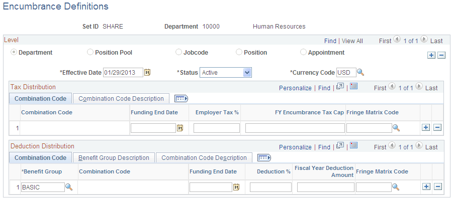

Encumbrance Definitions Page
Use the Encumbrance Definitions page (ENCUMB_DEFN) to create an encumbrance definition for taxes and deductions.
Navigation:
Set Up HCM, and then Product Related, and then Commitment Accounting, and then Encumbrance Information, and then Encumbrance Definitions
This example illustrates the fields and controls on the Encumbrance Definitions page.

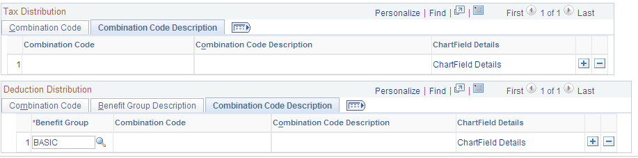

Combination Code
Both the Tax Distribution grid and the Deduction Distribution grids list the combination codes that you use for fringe encumbrances. The column that displays the selected combination code is read-only; to enter a combination code, access the Combination Code Description tab and select the ChartField Details link.
This example illustrates the fields and controls on the Encumbrance Definitions page, Combination Code Description tabs.
Encumbrance Definitions page: Combination Code Description tabs
Field or Control Description
ChartField Details
Select the ChartField Details link in the Deduction Distribution group box, Combination Code Description tab, to access the ChartField Detail page, where you can search for an existing combination code or select a unique combination of ChartFields.
The ChartField values are based on the general ledger ChartField values that you imported as part of the combination code.
See Application Fundamentals: Editing ChartField Combinations in HCM Transactions.
Funding End Date
You can optionally enter a funding end date for each combination code in both the Tax Distribution grid and the Deduction Distribution grid.
Funding End Date
Enter the date through which to create encumbrances. If you do not specify a funding end date, the encumbrance processes calculate fringe encumbrances through the end of the fiscal year. Otherwise, the encumbrance processes create encumbrances and pre-encumbrances up to the date you enter. This can result in partial-year fringe encumbrances for the current or future fiscal years.
Note: If the funding end date for earnings (as entered on the Department Budget Earnings page) is earlier than the funding end date for fringe encumbrances, the system does not calculate future fiscal year fringe encumbrances past the funding end date for earnings. This cut off occurs because fringe encumbrance calculations are based upon the salary encumbrances, and once the salary encumbrances end, there can be no fringe encumbrances.
If the Funding Source Information page has a funding end date for the combination code, and if the Department Budget Defaults page is configured to use that date as a default, then that date appears as a default value when you insert a row in either the Tax Distribution or Deduction Distribution grid. When checking to see if the Department Budget Defaults page is configured to use the default ending date, the system looks at the settings for the fiscal year that matches the fiscal year on the Encumbrance Process Control page.
Note: To activate funding end date defaulting on the Encumbrance Definitions page, you must set up the Encumbrance Process Control page.
See Defining Processing Parameters for Real-Time Budget Checking.
Tax Distribution
Employer Tax % or Fringe Matrix Code
For each combination code, specify the percentage of salary to encumber for taxes. You can either enter a fixed percentage in the Employer Tax % field, or you can select a fringe matrix code. A fringe matrix code matches the employee or position to the appropriate salary range code, which in turn provides a percentage that is based on the salary for the employee or position. (Any additional amount specified in the salary range code is disregarded for tax encumbrances.)
Because you must choose between entering a flat percentage and selecting a fringe matrix code, entering data in one of these fields makes the other one unavailable for entry. To switch which field you use, you must clear data from the field you don't want to use before you can enter data in the field that you do want to use.
Leave both fields blank if you do not want to generate encumbrances or pre-encumbrances for employer-paid taxes.
FY Encumbrance Tax Cap (fiscal year encumbrance tax cap)
Enter the encumbrance tax cap amount per fiscal year. The encumbrance calculation only encumbers employer paid taxes up to this amount per fiscal year. Any employer paid taxes above and beyond this amount won't be encumbered.
Benefit Group
Select a benefit group.
Deduction %, Fiscal Year Deduction Amount, and Fringe Matrix Code
For each combination code, specify the percentage of salary to encumber for deductions in this benefit group. You can either one of the following:
  • A fixed percentage plus a flat amount: enter these in the Deduction % and Fiscal Year Deduction Amount fields.
  • A fringe matrix code: this matches the employee or position to the appropriate salary range code, which in turn applies a percentage and an optional additional amount based on the salary amount.
When you enter data for one of these options, the other option is not available for entry. To switch which option you use, you must clear data from the fields that you don't want to use before you can enter data in the fields that you do want to use.
Leave all three fields blank if you do not want to generate encumbrances or pre-encumbrances for employer-paid deductions.
