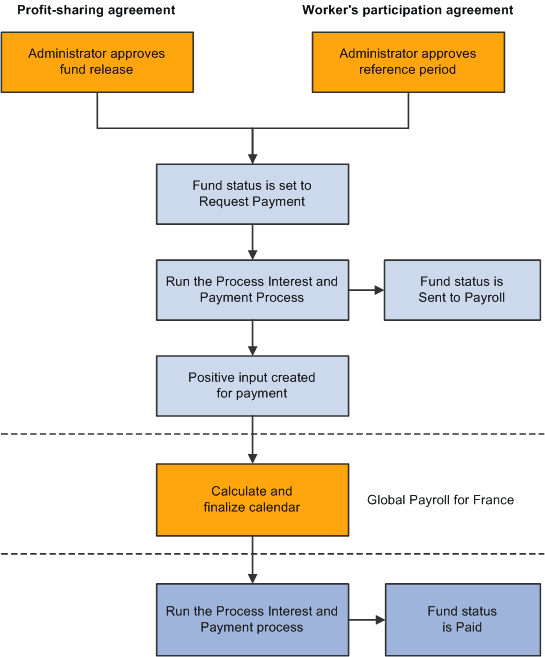

  • Processes payments for profit-sharing funds with Company Investment as the investment method and worker's participation funds with Employee's Bank Account as the investment method.
    Payments are processed only if the reference period is Approved and the fund status is Request Payment. The process changes the fund status to Sent to payroll.
  • Receives information from Global Payroll for France or another payroll system about the status of payments previously sent, and updates fund status accordingly.
    Payments that were processed successfully are assigned a status of Paid. If a payment was not processed, the process changes the fund status to Error.

If you installed Global Payroll for France, you can use it to automatically process payments. The following diagram illustrates the payment processing with Global Payroll for France:
Payment processing with Global Payroll for France
Overview of payment processing
