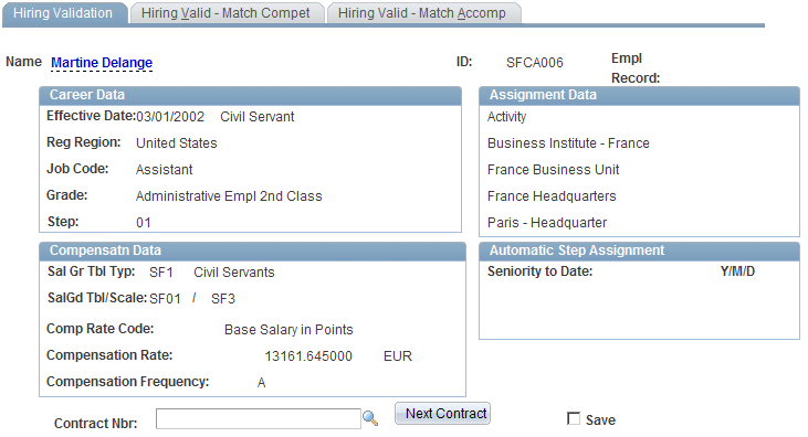

Hiring Validation Page
Use the Hiring Validation page (FPAEERATIFY_PNL1) to validate the hire.
You can select only those employees who have existing records and whose hiring must be manually validated. You can't select employees whose hiring validation is automatic.
Navigation:
Workforce Administration, and then Job Information, and then French Public Sector Jobs, and then Validate Hire FPS, and then Hiring Validation
This example illustrates the fields and controls on the Hiring Validation page. You can find definitions for the fields and controls later on this page.
To validate the hiring process:
  1. Review the displayed data, including data on the other pages of the component.
  2. Click Next Contract to create a contract.
  3. Select Save to validate the hire.
    If the employee is lacking competencies or accomplishments, the system issues a message but the process continues. Once you save the page, the employee's status is Active.
  4. For employees in a grade but with no step, the system assigns a step when hiring is validated and displays it in the Automatic Step Assignment group box.
    The system accounts for the seniority bonus or the salary grade table entry bonus entered in the Salary Grade Table component (FPMSALMATRX_PNL). If a seniority bonus other than that granted for civil service applies, the salary grade table entry bonus is ignored.
