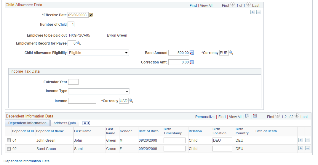

This example illustrates the fields and controls on the Child Allowance Administration page (1 of 2).

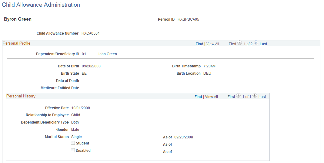

This example illustrates the fields and controls on the Child Allowance Administration page (2 of 2).
This page displays the personal information of employee's children that is populated from the Dependent Information component. If the employee has multiple children registered in the system, only the ones that are eligible for child allowance appear on this page, ordered by birth date.
To edit any of the read-only information, click the Dependent Information Data link.
Child Allowance Data
Data in this section is effective-dated and editable. Child allowance administrator can make changes to this information, for example, when a child in the household is no longer qualified for child allowance due to age and the administrator needs to reassign child numbers to the rest of the children.
Field or Control Description
Number of Child
This field value is populated from the Dependent Information component.
Employee to be paid out and Employment Record for Payee
Displays the employee's name, who is receiving the allowance on behalf of the child, and the employee's employment record from the Dependent Information component.
PAISY uses this information for payroll calculation and assignment.
Child Allowance Eligibility
Values are:
Counting Child and Not Eligible: Base amount is set to zero. Counting child is not eligible for allowance claims.
Correction: the Correction Amt field becomes available for edit and you can enter the corrected allowance amount.
Eligible: populate the field with the appropriate amount from the Child Allowance Type page.
Eligible with Correction: both Base Amount and Correction Amt fields become available for edit.
Base Amount
The system populates this value from the Child Allowance Type page only if the child is eligible for child allowance claims (that is, the value of the Child Allowance Eligibility field is not set to Not Eligible or Counting Child).
The amount populated is determined by the number to which the child is assigned.
