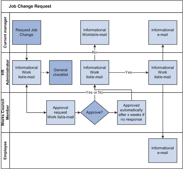

This diagram illustrates the approval process for a job change request:
In this diagram of the employee job change approval process, the current manager requests a job change. The system sends an informational email to the HR administrator and an approval request to the works council member. Works council approval occurs automatically after x weeks if there is no response. When the request is processed, the system sends informational email to the current manager and the HR administrator. If the request is approved, the system also sends informational email to the employee.
Employee Job Change approval process

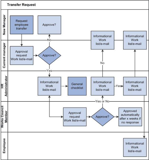

This diagram illustrates the approval process for a transfer request:
In this diagram of the employee transfer approval process, the new manager requests the transfer. The system sends the first approval request to the current manager. If the current manager approves the request, the system sends an informational email to the HR administrator and an approval request to the works council member. Works council approval occurs automatically after x weeks if there is no response. When the request is processed, the system sends informational email to the new manager, the current manager, and the HR administrator. If the request is approved, the system also sends informational email to the employee.
Employee Transfer approval process

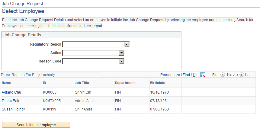

Job Change Request - Select Employee Page
Use the Job Change Request - Select Employee page (WC_JCR_SEARCH) to enter the required data and initiate the job change request.
Navigation:
  • Workforce Administration, and then Job Information, and then Request Job Change, and then Job Change Request - Select Employee
  • Manager Self Service, and then Job and Personal Information, and then Job Change Request, and then Job Change Request - Select Employee
This example illustrates the Job Change Request - Select Employee page as it appears before you select an action:
The Job Change Request - Select Employee page requires different data entry depending on the type of request—either hire, transfer, or termination.

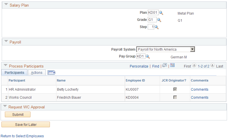

Hire Action
Begin the Works Council hiring approval process by selecting the Hire action on the Job Change Request - Select Employee page.
This example illustrates the Job Change Request - Select Employee page as it appears after you select Hire in the Action field.
Job Change Request - Select Employee page: Hire action
All fields in the Hire group box are mandatory.

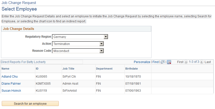

Termination Action
Begin the Works Council termination approval process by selecting the Termination action on the Job Change Request - Select Employee page.
This example illustrates the Job Change Request - Select Employee page as it appears after you select Termination in the Action field.
Job Change Request - Select Employee page: Termination action
Complete the fields in the Job Change Details group box, then click the Search For An Employee button to view a list of workers who meet your criteria. You can then select a worker from the list to continue with the termination process.
HR Administrators see only workers to which they have row level access as defined in the department security tree.
Managers see only their direct reports as defined in the self-service setup.

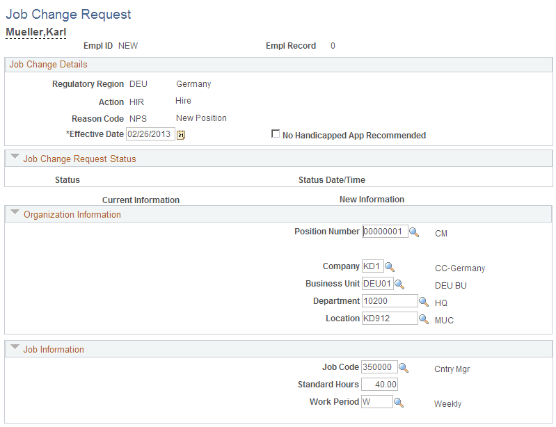

The following examples show the Job Change Request page for a manager submitting a hire request.
This example illustrates the Job Change Request page for the Hire action (1 of 2).
Job Change Request page, Hire (1 of 2)
This example illustrates the Job Change Request page for the Hire action (2 of 2).
Job Change Request page, Hire (2 of 2)

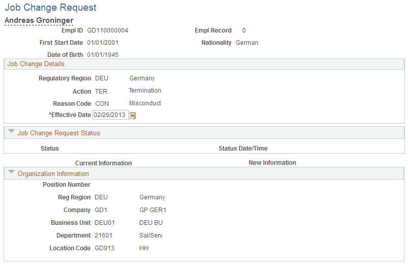

The following examples show the Job Change Request page for manager submitting a termination request.
This example illustrates the Job Change Request page for the Termination action (1 of 2).
Job Change Request page, Termination (1 of 2)
This example illustrates the Job Change Request page, Termination (2 of 2).

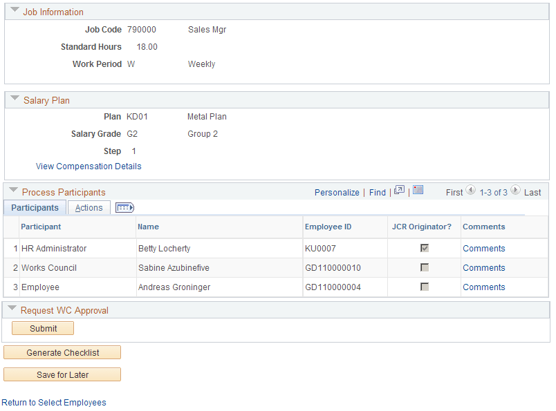

When entering termination requests, this page is display only. The Comments link remains active to access the Decision Details page to add comments to this request.

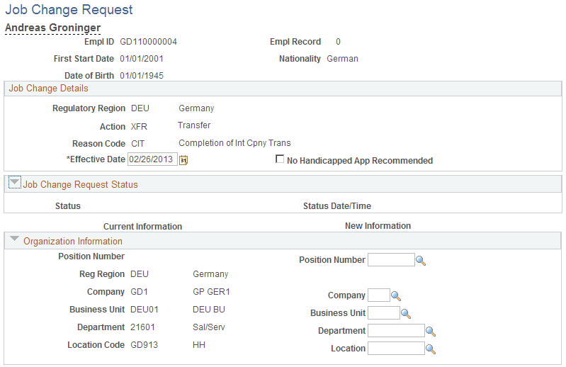

The following examples show the Job Change Request page for the new manager entering a transfer request.
This example illustrates the Job Change Request page for the Transfer action (1 of 2).
Job Change Request page, Transfer (1 of 2)
This example illustrates the Job Change Request page for the Transfer action (2 of 2).
Job Change Request page, Transfer (2 of 2)

Job Information
Complete the fields in this group box if the information does not default from the position data. Defaulted information can be edited here.
Salary Plan
Complete the fields for salary plan, grade, and step data.
Field or Control Description

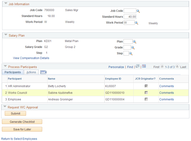

Process Participants
This group box displays everyone involved with requesting or approving job change requests. On the Change by Regulatory Region page you define who is involved with a request and what information they can view.
JCR Originator?
The selected check box indicates which process participant initiated this job change request.
Comments
Access the Decision Details page to provide additional information about this request.
Request Job Change
Once the request has been submitted, this group becomes Request WC Approval.
The buttons that appear in this group box will depend on which action has been selected or where the job change request stands in the approval process.
Submit
Click to submit a new job change request after completing all of the fields on the page.
Generate Checklist
Click to generate a checklist for this job change request.
Save for Later
Click to save this job change request to complete later. To access this after saving it, use the Review All Job Change Requests page.
Approve and Deny
Click approve or deny a job change request routed to you.

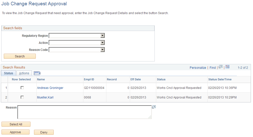

Job Change Request Approval Page
Use the Job Change Request Approval page (WC_JCR_APPR_INQ) to mass-approve job change requests.
Navigation:
Workforce Administration, and then Labor Administration, and then Job Change Request Approval
This example illustrates the Job Change Request Approval page.
Search for all job change requests and approve all selected requests at once.
When you select a job change request to approve, the system accesses the Job Change Request page for this job change request.
The following table discusses approval access by role.
Role Approval Access
Manager
Enters job change requests.
For job change requests such as transfers that involve a change in reporting manager, the new manager enters the transfer request and the current manager approves or denies the transfer request.
HR Administrator
Approves or deny job change requests either before or after Works Council review and decision.
Works Council
Approves or denies a job change request.
