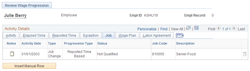

This is the first of seven examples illustrating the Review Wage Progression page.
Review Wage Progression page (1 of 7)

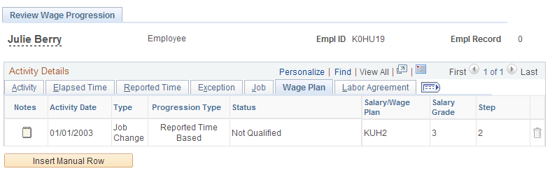

This is the second of seven examples illustrating the Review Wage Progression page.
Review Wage Progression page (2 of 7)

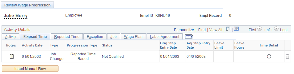

This is the third of seven examples illustrating the Review Wage Progression page.
Review Wage Progression page (3 of 7)

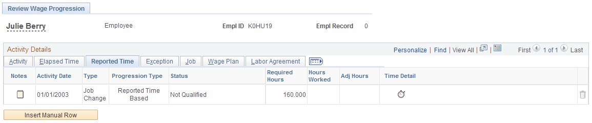

This is the fourth of seven examples illustrating the Review Wage Progression page.
Review Wage Progression page (4 of 7)

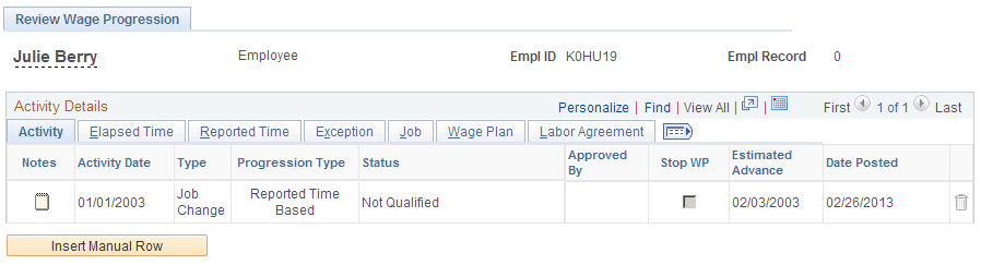

This is the fifth of seven examples illustrating the Review Wage Progression page.
Review Wage Progression page (5 of 7)

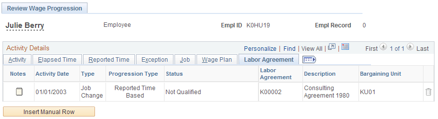

This is the sixth of seven examples illustrating the Review Wage Progression page.
Review Wage Progression page (6 of 7)
This is the seventh of seven examples illustrating the Review Wage Progression page.
Review Wage Progression page (7 of 7)

Activity
Field or Control Description
Approved By
  • If the system automatically approved the worker for advancement, the system sets the value to System.
  • If the worker requires manual approval, for advancement, the system sets the value to Manual once you approve them on the Approve Employees to Advance page.
Stop WP (stop wage progression)
Select this check box here or on the Job Labor page to suspend a worker's participation in the wage progression process. When you select this check box here the system inserts a new Job Data row and selects the Stop Wage Progression check box on the Job Data - Job Labor page.
When you select the Stop Wage Progression on the Job Labor page, the system updates the wage progression activity when you next run the Update Activity with Job Data process.
When you select the check box, the system:
  • Makes the salary plan and grade fields available for entry on the Job Data - Salary Plan page.
  • No longer includes the worker in the Update Wage Progression processes (except for the first Update Activity with Job Data process that updates this field with the value from the Job Labor page, if that's where you first selected the check box).
The system also selects this check box when a worker completes the wage progression.
Estimated Advance
Displays the system-calculated estimated date the worker will be eligible to advance based on the wage progression rule of their salary plan.
For rules based on hours worked, the system bases this calculation on the standard hours on the worker's Job Data record. The date will always be the first day of the next pay period after the worker qualifies.
This is only an estimate since various other factors could impact the actual advancement date.
See Understanding the Update Wage Progression Process.
Date Posted
Displays the system date the row was generated or created.
Elapsed Time
These fields are applicable for elapsed time-based wage progression rules only.
Orig Step Entry Date (original step entry date)
Displays the date the worker originally entered their current salary step. The system draws this value from the Step Entry Date field on the Job Data - Salary Plan page.
Adj Step Entry Date (adjusted step entry date)
Manually adjust the step entry date here to maintain wage progression accuracy.
Leave Limit
(Optional) Displays the maximum number of leave hours a worker can accumulate while in the step, as defined in the salary plan's progression rule.
Leave Hours
(Optional) Displays the leave hours the worker has accumulated since the original step entry date. The Update Activity with Time Data process updates this value.
Time Detail
(Optional) Click to view the Review Time Details page.
See Review Time and Wage Details Page.
Reported Time
These fields are applicable for hours-based wage progression rules only.
Required Hours
Displays the number of hours the worker needs to accumulate to advance to the next grade step defined in the salary plan's progression rule.
Hours Worked
Displays the qualifying hours the worker has worked since the original step entry date. The Update Activity with Time Data process updates this value and also adds in any adjusted hours from a previous manual row.
Adj Hours (adjusted hours)
Manually enter hours here to establish a new total for hours worked. Adjust the hours as necessary to maintain wage progression accuracy. The next Update Wage Progression with Time Data will incorporate manual adjustments. The system uses this adjusted value to qualify if the worker is ready to progress to the next step by comparing it to the Required Hours.
Time Detail

Job
Job Code and Description
Displays the job code and a description of the worker's job.
Wage Plan
Salary/Wage Plan, Salary Grade and Step
Displays the wage progression salary plan, grade, and step currently held by the worker.
Labor Agreement
Labor Agreement . Description , and Bargaining Unit
Displays the worker's labor agreement and bargaining unit.
