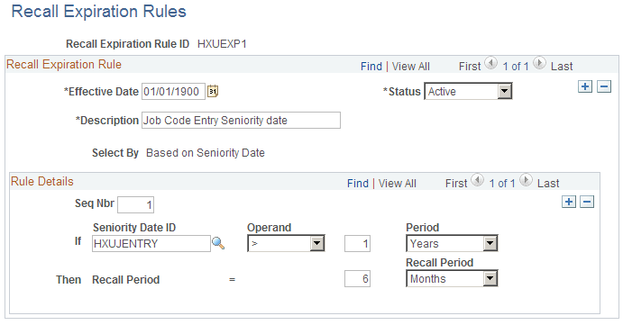

This example illustrates the Recall Expiration Rules page.
The system determines that a recall right has expired when the defined expiry date is less than current system date.
Field or Control Description
Select By
Select one of the following options:
  • Seniority
    Select if the recall expiration date is calculated using seniority as determined by a seniority date.
    Note:If a recall expiration rule is based on a seniority date and this date is blank for a person, then the system will not create automatic recall rights for the worker. You will have to enter rights manually on the Manage Recall Rights page (HR_RCL_RIGHTS).
  • Layoff Date
    Select if the recall expiration date is calculated from the layoff date.
  • No Recall
    Select if there is no recall.
    Note: You must set up at least one recall expiration rule with no recall because the Recall Expiration Rule field on the Seniority Rules page (HR_LABOR_AGRDEFN3) is a required field. If a labor agreement has no predetermined rules around recall rights processing then attach a No Recall type rule to the labor agreement. When a layoff is processed for workers in covered by a labor agreement with a No Recall rule, the system will not create automatic recall rights those candidates being laid off. The Recall/ Reinstatement process will also not process recall rights for candidates covered by a labor agreement with a No Recall recall expiration rule.
Rule Details for Seniority Based Recall Expiration Rules
Enter multiple Rule Details rows to create different recall expiry periods for different seniority categories.
Seq Nbr
Enter the sequence in which the system should process this rule detail.
Seniority Date ID
Select the ID of the seniority date you want the rule to use to calculate seniority for the purpose of recall for this rule detail line.
Operand
Select the operation symbol.
Period
Enter a number in the preceding field and then select the period of time it refers to. For example, enter 1 in the preceding field and Years in this field to indicate that the period of seniority is one year.
Recall Period
Enter a number in the preceding field and then select the period of time it refers to. For example, enter 6 in the preceding field and Months in this field to indicate that recall rights expire after six months for workers with this seniority range.
Rule Details for Layoff Date Based Recall Expiration Rules
Period
Enter a number in the preceding field and then select the period of time it refers to. For example, enter 6 in the preceding field and Months in this field to indicate that recall rights expire six months after layoff.
