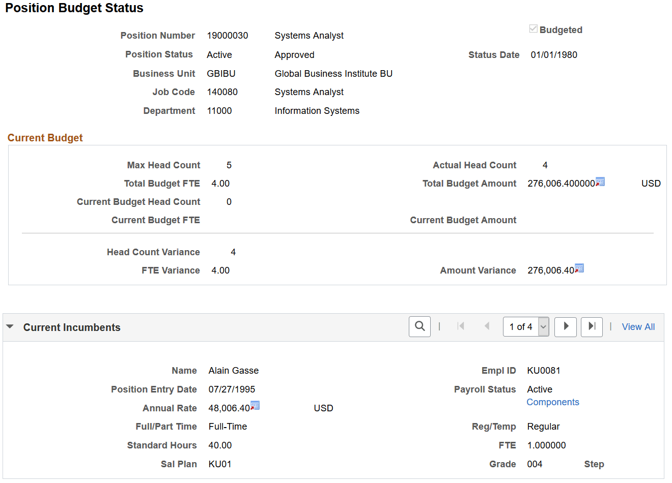

Use the Budget Status page (POSN_BUDGET_STATUS) to view a summary of budgeted and actual figures for departments.
Navigation:
Organizational Development, and then Position Management, and then Review Position/Budget Info, and then Position Budget Status, and then Position Budget Status
This example illustrates the fields and controls on the Position Budget Status page. You can find definitions for the fields and controls later on this page.
Current Budget
Field or Control Description
Total Budget FTE
Displays the total budgeted FTE for this position. This information is specified on the Position Data - Specific Data page.
Total Budget Amount
Displays the total salary amount for the incumbents assigned to this position.
Current Budget Head Count
Displays the current budgeted head count for this position. Head count budgets are defined on the Position Budget Update page.
Current Budget FTE
Displays the current budgeted FTEs for this position. FTE budgets are defined on the Position Budget Update page.
Current Budget Amount
Displays the current budgeted salary amount for incumbents assigned to this position.
Head Count Variance
Displays the difference between the Actual Head Count and the Current Budget Head Count values.
FTE Variance
Displays the difference between the Total Budget FTE and the Current Budget FTE values.
Amount Variance
Displays the difference between the Total Budget Amount and the Current Budget Amount values.
Salaries appear in the currency that you designated when creating the budget. If the currency differs from the base currency specified in the Installation Table, a converted amount appears at the top of the screen. If the actual figures are over budget, the variances are positive numbers. If the actual figures are under budget, they appear as negative amounts. And if the actual and budget amounts match, no figure appears in the variance fields.
