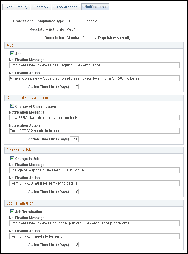

Regulatory Authority - Notifications Page
Use the Regulatory Authority - Notifications page (PCMP_REGAUTH_NOTIF) to create the following notifications: RI add, classification change, job change, or termination.
Navigation:
Set Up HCM, and then Product Related, and then Workforce Monitoring, and then Professional Compliance, and then Regulatory Authority, and then Notifications
This example illustrates the fields and controls on the Regulatory Authority - Notifications page .
Add
When you manually add a regulated individual to the Manage Professional Compliance business process (as opposed to the hire process), the professional compliance type and regulatory authority are entered, but no assignment to a compliance supervisor has been made. For this reason, RI add notifications are not sent to compliance supervisors, but to the employee's general supervisor, as defined on the JOB - Work Location page with an appropriate message so that the individual can be assigned to a compliance supervisor.
Change of Classification
During a classification change, the regulated individual is already within the Manage Professional Compliance process and assigned to a compliance supervisor. When you create a classification change notification, the system sends an email that informs the compliance supervisor of the new classification, so that the supervisor can take appropriate action.
Change in Job
When a regulated individual changes jobs, the individual is already within the Manage Professional Compliance process and assigned to a compliance supervisor. When you create a job change notification, the system sends an email that informs the compliance supervisor of the change, so that the supervisor can take appropriate action.
Make job changes in the JOB component of Administer Workforce. When a regulated individual changes jobs, the Professional Compliance handler on the WORKFORCE_SYNC service operation initiates notification based on the POS and XFR Action settings.
Job Termination
Upon termination or retirement, the regulated individual must be deactivated within the Manage Professional Compliance process. Historical information is not removed from the system, but retained for all regulated individuals. When you create a notification, an email is sent to the compliance supervisor, and an entry is made in that person's worklist including navigation to the Assign Manager/Supervisor/RI page so that the supervisor can set the regulated individual's status to Inactive.
Make terminations in the JOB component of Administer Workforce. When a regulated individual is terminated or retires, the Professional Compliance handler on the WORKFORCE_SYNC service operation initiates notification based on the TDL, TER, TWB, and TWP Action settings.
