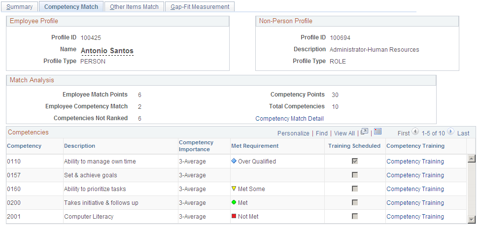

Employee Profile Matching - Competency Match Page
Use the Employee Profile Matching - Competency Match page (CM_PROFILE_MATCH) to view competency matches that display an analysis of how the employee matches the individual competencies required for a given non-person profile.
Navigation:
Workforce Development, and then Profile Management, and then Profiles, and then Profile Matching, and then Employee Profile Matching, and then Competency Match
This example illustrates the fields and controls on the Employee Profile Matching - Competency Match page. You can find definitions for the fields and controls later on this page.
Match Analysis
Field or Control Description
Employee Match Points and Competency Points
Indicates the number of competency points that an employee has out of a total possible number of competency points required by the non-person profile.
Employee Competency Match and Total Competencies
Displays the number of employee competencies that match the competencies required for the non-person profile. For example, an employee may only have 7 of the 15 competencies defined for the role.
Competencies not ranked
Displays the number of competencies required by the role that are not included in the employee's evaluations.
Competency Match Detail
Click to open the Competency Match Detail page and view the breakdown of each competency and its match within the profiles.
Competencies
Competency
Lists competencies assigned to the non-person profile, from highest to lowest importance.
Importance
Displays the importance levels that are assigned to the competencies in the non-person profile.
Met Requirement
Displays the appropriate text and icon in the field for how the person matches the competency. Values include Over Qualified, Met, Met Some, and Not Met. When a person’s profile does not have an item specified in the non-profile, no image will display for the item.
Training Scheduled
Indicates whether the employee is already scheduled for training in the competency.
Competency Training
Select this link to open the Competency Training page to see if any available training courses target the competency.

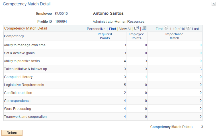

Competency Match Detail Page
Use the Competency Match Detail page (CM_PROF_MATCH_SEC) to view competency match details of the employee's ratings in each competency assigned to the non-person profile.
Navigation:
Click the Competency Match Detail link on the Competency Match page.
This example illustrates the fields and controls on the Competency Match Detail page. You can find definitions for the fields and controls later on this page.
Required Points
Each rating in a rating model has points associated with it. Required points are derived from the rating (or rather a point translation of the rating) this is assigned to the competency for the specified role. You specify the number of points for each rating by using the Review Points field on the Rating Model page.
Employee Points
Displays the employee's point rating for the competency. Employee review points are the point translation of the rating that the employee receives for the competency, and these points are specified for each rating using the Review Points field on the Rating Model page.
Importance Match
If the employee possesses the required competency and has the required rating, the employee is awarded points based on the importance of the competency.

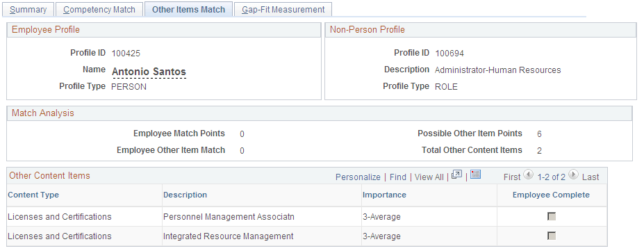

Employee Profile Matching - Other Items Match Page
Use the Employee Profile Matching - Other Items Match page (CM_PROFILE_MATCH2) to analyze other profile item matches for an employee. Review how well an employee matches individual content for a given non-person profile.
Navigation:
Workforce Development, and then Profile Management, and then Profiles, and then Profile Matching, and then Employee Profile Matching, and then Other Items Match
This example illustrates the fields and controls on the Employee Profile Matching - Other Items Match page. You can find definitions for the fields and controls later on this page.
Match Analysis
Indicates the number of employee importance points for those profile item matches between the employee and the non-person profile.
Possible Other Item Points
Indicates the total number of profile item importance points available.
Employee Other Item Match
Displays the number of employee profile items other than competencies that match the profile items required for the non-person profile.
Total Other Content Items
Displays the number of total profile items that are required for the non-person profile.
Other Items
Content Type
Lists each content type for the content item assigned to the non-person profile, from highest to lowest importance.
Description
Lists descriptions of each profile item in the non-person profile from, highest to lowest importance.
Importance
Displays importance levels assigned to the profile item in the non-person profile.
Employee Complete
Indicates whether the employee has accomplished the content item.

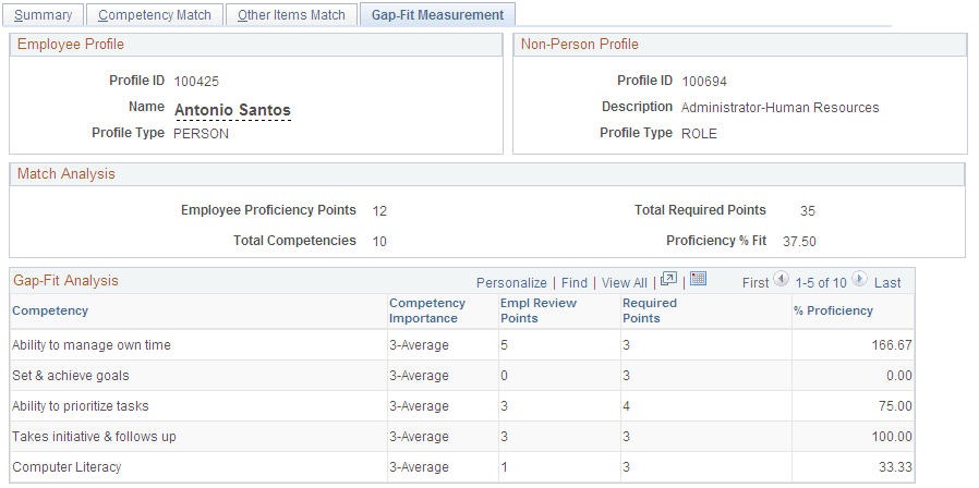

Employee Profile Matching - Gap-Fit Measurement Page
Use the Employee Profile Matching - Gap-Fit Measurement page (CM_PROFILE_MATCH3) to compare an employee's ratings in each required competency with the rating expected for the role, and view the percentage difference.
The sum of these percentages provides an overall indication of how well the employee matches the requirements.
Navigation:
Workforce Development, and then Profile Management, and then Profiles, and then Profile Matching, and then Employee Profile Matching, and then Gap-Fit Measurement
This example illustrates the fields and controls on the Employee Profile Matching - Gap-Fit Measurement page. You can find definitions for the fields and controls later on this page.
Match Analysis
Employee Proficiency Points
Indicates how many importance points the employee has been awarded for competencies.
Total Required Points
Indicates how many competency importance points are possible for the non-person profile.
Total Competencies
Displays the number of competencies that are assigned to the non-person profile.
Proficiency % Fit (proficiency percentage fit)
Displays the employee's points as a percentage of the total possible. The system only includes points associated with competencies in this calculation.
For example, if the employee has 5 points and the total possible for the non-person profile is 20 points, then the percentage fit is 25%.
Gap-Fit Analysis
Empl Review Points (employee review points)
Displays the employee's proficiency point rating for the competency. For example, if you use the PSCM rating model, a rating of 5 has an associated review point value of 5.
Required Points
Each rating in a rating model has points associated with it. Points are derived from the rating (or rather a point translation of the rating) that is assigned to the competency for the specified role. You specify the number of points for each rating by using the Review Points field on the Rating Model page.
% Proficiency (percentage proficiency)
Displays the employee's rating percentage compared to the rating required for the role. The system divides the employee review points by the required points and converts the result into a percentage. For example, if the value of the employee review points is 3 but the role requires a point value of 4, then the percentage proficiency is 75%.
If an employee's rating exactly matches the required rating, then the percentage proficiency deficiency is 100%. A percentage less than 100% indicates that the employee has not met the required rating, and a percentage greater than 100% indicates that the employee's rating exceeds the rating required for the role.
