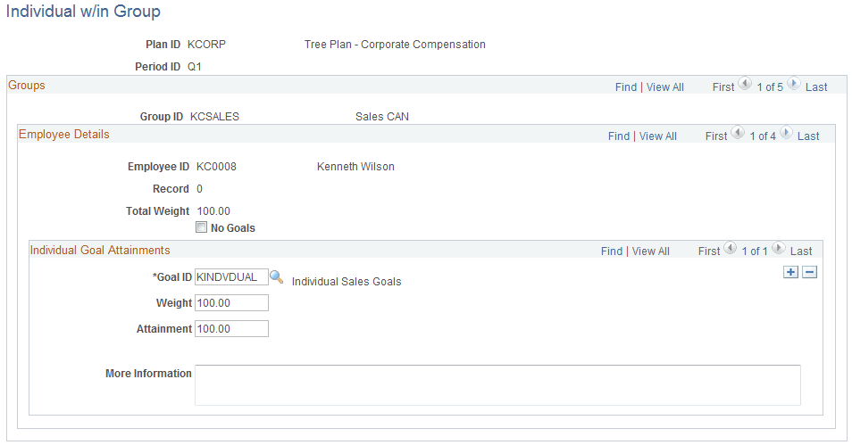

Individual w/in Group Page
Use the Individual w/in Group (individual within group) page (VC_IND_GOAL_WG_ATN) to add goals and weights, change or delete default goals and weights, and enter goal attainments for individual plan members. This page is .for plans that use groups.
Navigation:
Compensation, and then Variable Compensation, and then Define Goal Attainments, and then Individual w/in Group, and then Individual w/in Group
This example illustrates the fields and controls on the Individual w/in Group page.
The system does not automatically apply the attainment percentages of a parent group to its child groups on the tree. You must select the group ID of each group for which you want to modify default individual goals and enter attainment percentages.
The Eligibility/Proration process loads the default individual goals into this page for members of groups with default individual goals defined. Use the defaults as a starting point for updating the goals of the individual before entering goal attainments.
All fields on this page are identical to the fields on the Individual's Goals page, with the addition of the Group ID field.
Field or Control Description
Group ID
Displays the group ID of the plan members whose goal attainments you want to enter.
