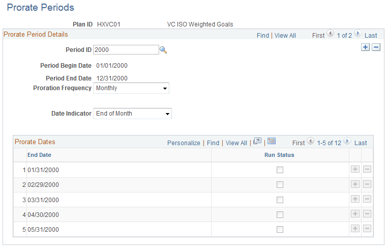

Prorate Periods Page
Prorate periods are subsets of the plan payout period. Prorate periods can have daily, weekly, or monthly frequency. Daily frequency is the most accurate, but the processing time is greater.
You must set up the variable compensation plan and its payout periods before you can define the proration periods.
Use the Prorate Periods page (VC_PRORATE_PRD) to define proration frequency parameters for the payout periods of a prorated plan.
The Determine Eligibility/Proration process evaluates eligibility as of the proration period end dates generated on this page.

This example illustrates the fields and controls on the Prorate Periods page.
Field or Control Description
Period ID
Select a payout period from the available options. The system prompts you with values from the VC_PAYPRD_TBL. The list does not include payout periods for which an award has been finalized, canceled, or manually entered. In other words, if the Award Status on the Allocate Awards page is other than Initial Calculation for any award in the plan, or if any award was manually allocated, that payout period is not available.
The system displays the payout period begin and period end dates that you defined on the Plan Payout Periods page.
Proration Frequency
Select a proration frequency from these values:
  • By Workdays (daily frequency): The Workday Rule ID field appears.
  • Calendar Days (daily frequency): The Prorate % ID field appears.
  • Monthly: The Date Indicator field appears.
  • Weekly: The Day field appears.
Workday Rule ID
If you select By Workdays as proration frequency, you must select a workday rule. The maximum number of eligible days defined in the rule you select must not be less than the number of days in the payout period.
Prorate % ID
This field appears if you select Calendar Days in the Proration Frequency field.
If you use the proration percentage calculation method, select a prorate percentage ID to associate a prorate percentage schedule with the plan for the payout period.
If you use the daily calculation method without proration percentages, leave this field blank.
Day
If you select Weekly as the proration frequency, you must select the day of the week as of which you want the system to calculate the proration. Values are the seven days of the week (Sunday through Saturday).
Date Indicator
If you select Monthly proration frequency, select a date indicator in this field. Values include:
End of Month: The system calculates eligibility as of the end of each month.
Day of Month: The Day of the Month field appears.
Day of the Month
Enter the number of the day of the month as of which you want the system to calculate eligibility. Select any number from 1 through 28. Set theDate Indicator field to End of Month if you select a number higher than 28.
Prorate Dates
End Date
After you define the proration frequency, the system displays the end date here for each proration period within the payout period that you specified.
Run Status
The system selects this check box when the Determine Eligibility/Proration process completes the eligibility calculation for the corresponding proration period.
