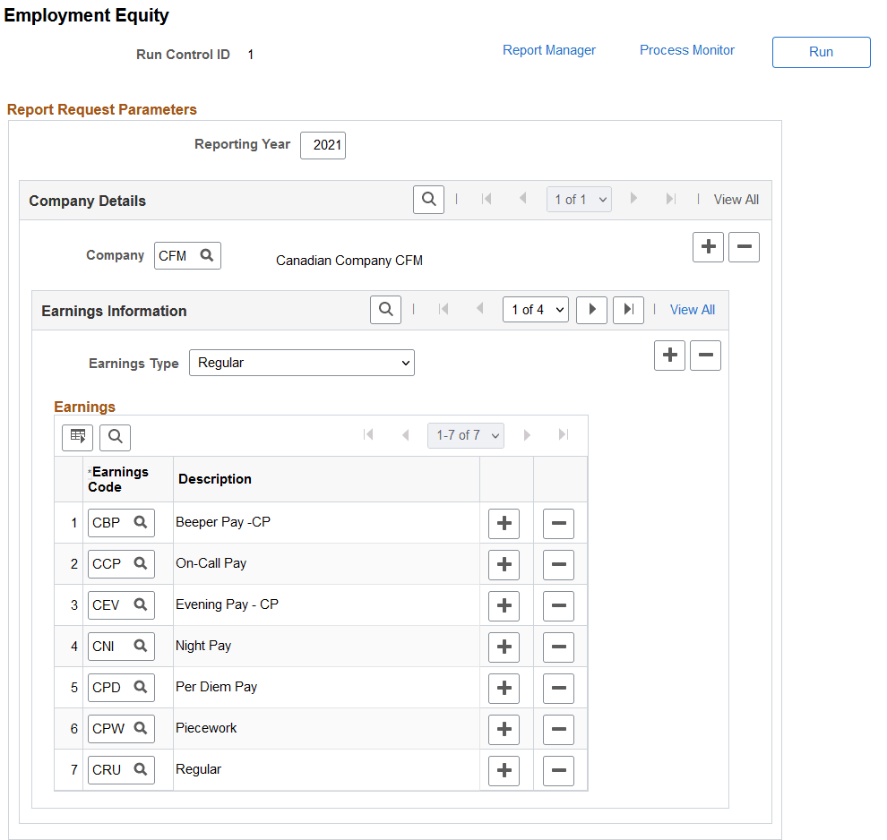

Employment Equity Page
Use the Employment Equity page (RUNCTL_PER101CN) to run the Employment Equity report (PER101CN).
The Employment Equity report (PER101CN) creates three data interface files (employee.txt, promo.txt and term.txt) for you to import the interface files into the federal government's WEIMS. For more information, see Understanding Employment Equity Report Files topic.
Navigation:
Workforce Monitoring, and then Meet Regulatory Rqmts CAN, and then Reports, and then Employment Equity, and then Employment Equity
This example illustrates the fields and controls on the Employment Equity page.
Field or Control Description
Reporting Year
Enter the reporting year for the employment equity report.
Company
Enter one or more companies for which you want to report.
Earnings Type
Select one or more earnings to include in the file for the company. Values include:
  • Bonus
  • Overtime
  • Regular
  • Special Salary - Commission
  • Special Salary - Other
Earnings Code and Description
Identify earnings codes to be included in the file.
Pay Earnings Processing
Earnings are selected for employees whose WEIMS status is 01, 02, 03, or 05. If the employee status is 04 (Other), only HR data is reported.
The earnings codes specified for each of the earnings types are matched against a view that returns PAY_EARNINGS and PAY_OTH_EARNS filtering on the Company and Earnings codes specified on the run control. The following lists the Payroll source fields based on earnings type:
