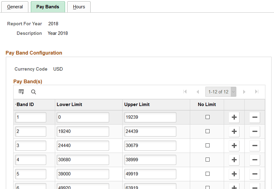

EEO-1 Compensation Data Defn - Pay Bands Page
HR_EEO1_PAYBAND
Enter pay bands for the EEO-1 compensation data for the reporting year.

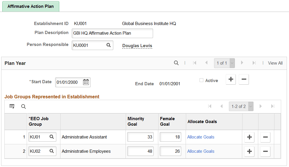

Affirmative Action Plan Page
Use the Affirmative Action Plan page (AAP_TBL) to define the affirmative action plans.
Affirmative action plans are defined by establishment ID.
Navigation:
Workforce Monitoring, and then Meet Regulatory Rqmts, and then Affirmative Action Plan, and then Affirmative Action Plan
This example illustrates the fields and controls on the Affirmative Action Plan page. You can find definitions for the fields and controls later on this page.
Field or Control Description
Plan Description
Enter a description of this affirmative action plan.
Person Responsible
Select the employee ID of the person responsible for administering this plan.
Plan Year
Start Date, End Date, and Active
Enter the start date of this plan. The system calculates the end date and selects the Active check box if this is the current year plan.
Job Groups Represented in Establishment
EEO Job Group, Minority Goal and Female Goal
Select an EEO job group and enter the minority goal and female goal for that job group.
Allocate Goals
Click the Allocate Goals link to accessEthnic Group, Total Goal and Female Goal fields.
Allocate Goals
Enter the plan's total and female goals for the selected ethnic group. Click the Roll Up Values links to add the goals for the Minority Goal and Female Goal. Click theDone button to return to the main page. These values will be rolled forward to the EEO Job Group Goals in theJob Groups Represented in Establishment group box.

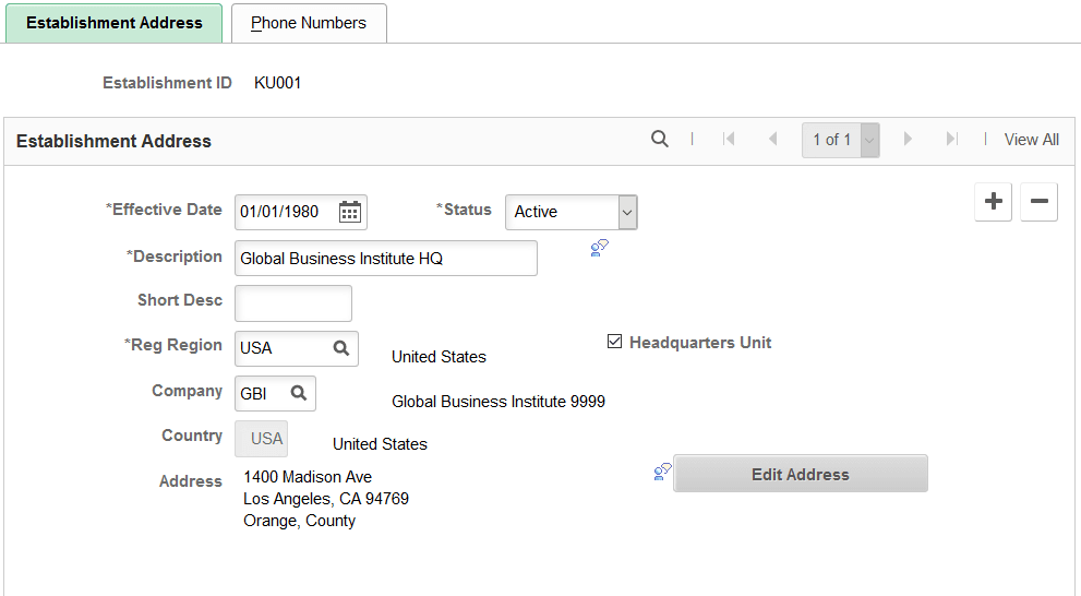

Establishment Address Page
Use the Establishment Address page (ESTAB_TBL1_GBL) to Identify the establishment, indicate its regulatory region, and enter the address and other country-specific information.
Set parameters for electronic filing.
Navigation:
Workforce Monitoring, and then Meet Regulatory Rqmts, and then Define Regulatory Rqmts Data, and then Establishments, and then Establishment Address
This example illustrates the fields and controls on the Establishment Address page (1 of 3).
This example illustrates the fields and controls on the Establishment Address page (2 of 3) for the USA section.
This example illustrates the fields and controls on the Establishment Address page (3 of 3) for the USA section.

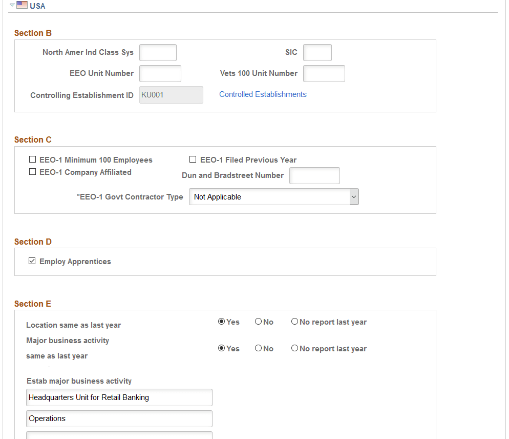

Beginning in 2005, the U.S. Equal Employee Opportunity Commission only accepts EEO-1 Report submissions through their web-based filing system. Previously, the Commission accepted computer-generated printouts of the EEO-1 Report. For employers required to submit the annual EEO-1 Report, PeopleSoft provides a process for submitting the report using a Data File uploaded through the EEO-1 Web Application. While the submission of the EEO-1 report using Alternate Reporting Format (ARF) is voluntary, employers who elect to use this method must comply with all of its requirements without exception.
Establishment ID
In order for the system to select a valid list of EEO-1 employees, this field must not be blank on the employee's Job record.
Section C
EEO-1 Govt Contractor Type
Select a government contractor type. In order for the system to select a valid list of EEO-1 establishments, this field value should be any value other than Not Applicable.

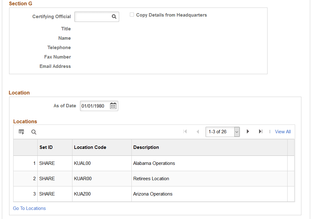

Section G
Certifying Official
Select a certifying official to populate the certification information of the EEO-1 report. Section G certification is associated with each establishment ID for the company. This allows unique certifying official data to be associated with the EEO-1 report for each establishment.
Copy Details From Headquarters
Select this check box to populate the certification information of the EEO-1 report from headquarters data if one certifying official is appointed to complete all establishment EEO-1 reports.

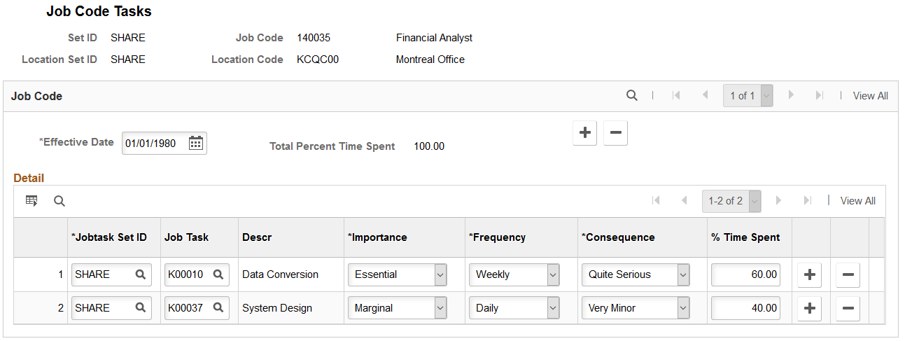

Job Code Tasks Page
Use the Job Code Tasks page (JOBCODE_TASK_TABLE) to define job tasks associated with each job code.
Navigation:
Workforce Monitoring, and then Meet Regulatory Rqmts, and then Define Regulatory Rqmts Data, and then Job Code Tasks, and then Job Code Tasks
This example illustrates the fields and controls on the Job Code Tasks page. You can find definitions for the fields and controls later on this page.
Job Code Tasks page
Total Percent Time Spent
The system calculates and displays this when you move out of the % Time Spent field. The total cannot exceed 100%.
Jobtask Set ID
Select a jobtask set ID. Values come from the TableSet ID page.
Job Task
Select a job task. Values come from the Job Tasks page.
Importance
Select the importance of the job task to the particular job code.
Frequency
Enter how often the job task occurs for each job code. Values come from the Frequency table.
Consequences
Select the result that occurs if the job task isn't performed.
% Time Spent (percentage time spent)
Enter the percentage of time that is spent on the job task.

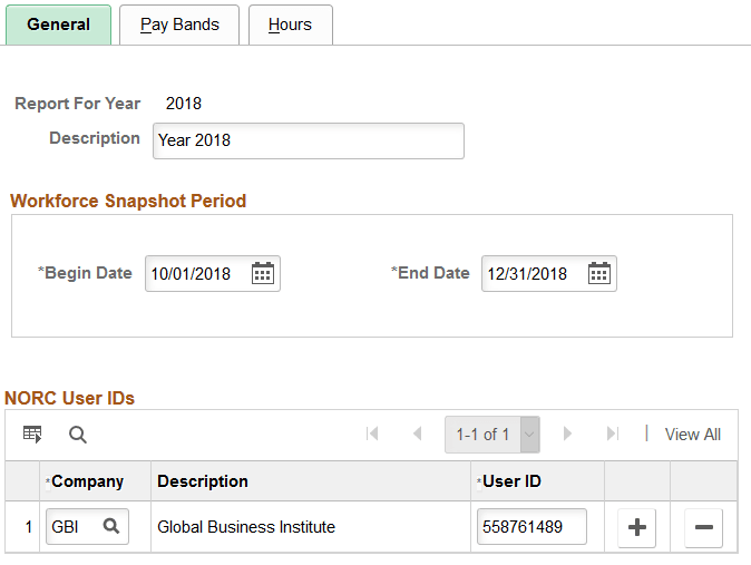

EEO-1 Compensation Data Defn - General Page
Use the EEO-1 Compensation Data Defn - General page (HR_EEO1_GENERAL) to define a workforce snapshot period for an EEO-1 compensation data reporting year.
Navigation:
Workforce Monitoring, and then Meet Regulatory Rqmts, and then Define Regulatory Rqmts Data, and then EEO-1 Compensation Data Defn, and then General
This example illustrates the fields and controls on the EEO-1 Compensation Data Defn - General page.
For general information on EEO-1 compensation data reporting, see the Understanding EEO-1 Compensation Wage and Hour Data topic.
Copy Configuration button
This button is available when you are adding a new report.
Click to copy the report parameters from a previous year report.
Workforce Snapshot Period
The reporting period is used to identify the list employees that are to be part of the report.
Begin Date and End Date
Enter the quarter dates specified by EEOC for the reporting year.
NORC User IDs
Use this section to enter the user information assigned by NORC (National Opinion Research Center).
You must enter at least one company and user ID.
Company
Enter each company reporting to NORC for EEO-1 compensation data reporting.
User ID
Enter the user ID assigned by NORC for the company.
Use the EEO-1 Compensation Data Defn - Pay Bands page (HR_EEO1_PAYBAND) to enter pay bands for the EEO-1 compensation data for the reporting year.
Navigation:
Workforce Monitoring, and then Meet Regulatory Rqmts, and then Define Regulatory Rqmts Data, and then EEO-1 Compensation Data Defn, and then Pay Bands
This example illustrates the fields and controls on the EEO-1 Compensation Data Defn - Pay Bands page.
EEO-1 Compensation Data Defn - Pay Band page
Band ID
Enter a pay bands as specified by the EEOC.
Lower Limit and Upper Limit
Enter the lower and upper limits for each pay band based on the information provided by the EEOC.
When the highest pay band has no upper limit, leave the Upper Limit field blank and select the No Limit check box for that pay band.
No Limit
Select to indicate that there is no upper limit for the highest pay band. When this option is selected, the Upper Limit field for this pay band should be left blank.

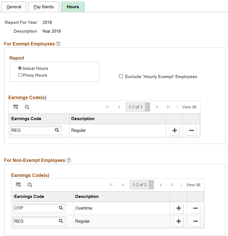

EEO-1 Compensation Data Defn - Hours Page
Use the EEO-1 Compensation Data Defn - Hours page (HR_EEO1_ERNCD) to configure the hours worked in the EEO-1 reporting year.
Navigation:
Workforce Monitoring, and then Meet Regulatory Rqmts, and then Define Regulatory Rqmts Data, and then EEO-1 Compensation Data Defn, and then Hours
This example illustrates the fields and controls on the EEO-1 Compensation Data Defn - Hours page.
The hours worked is calculated for the entire reporting year.
For Exempt Employees - Report
Use this section to configure the logic for calculating hours worked by FLSA exempt employees.
For exempt employees, employers must report actual hours worked when accurate records are maintained, or a proxy of 40 hours per week for full‑time employees and 20 hours per week for part‑time employees.
Actual Hours
When you select this option, the page displays the For Exempt Employees - Earnings Code(s) grid for entry.
Select this option to calculate the hours worked based on earnings codes you enter in the For Exempt Employees - Earnings Code(s) grid.
Proxy Hours
When you select this option, the page displays the For Exempt Employees - Proxy Hours group box for entry.
Select this option to report the default proxy hours per week. The proxy hours specified per week for full- and part-time employees is multiplied by the number of weeks the employee worked to calculate the hours worked for the year.
Exclude ‘Hourly Exempt’ Employees
Select this check box to exclude hourly exempt employees from the list of exempt employees.
Deselect to include hourly exempt employees in the list of exempt employees. This is the value provided by default.
This section is available when you select the Actual Hours option in the Report group box. Use this section if you are reporting actual hours worked.
Earnings Code
Enter the earnings codes that should be used to calculate the hours worked for exempt employees.
This section is available when you select the Proxy Hours option in the Report group box. Use this section if you need to enter proxy hours instead of actual hours.
For Full Time Employees
Enter the proxy hours for full-time exempt employees for your company. This number is typically 40 but may vary for your organization.
For Part Time Employees
Enter the proxy hours for part-time exempt employees for your company. This number is typically 20 but may vary for your organization.
For Non-Exempt Employee - Earnings Code(s)
Use this section to configure hours worked by FLSA non-exempt employees for the year.
Earnings Code
Enter the earnings codes that should be used to calculate the total hours worked by FLSA non-exempt employees.
