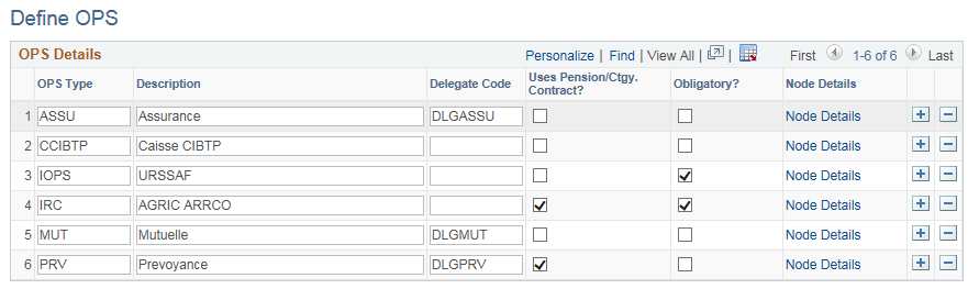

Define OPS Page
OPS_SETUP_FRA
Define the OPS type. You can also view the OPS types and corresponding Delegates that are already defined in the system.

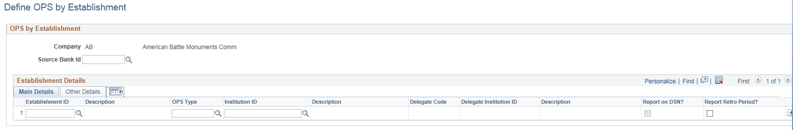

Define OPS by Establishment Page
OPS_ESTAB_SETUP
Use this page to enter the details of OPS types that doesn't require contract. If there is contract associated, the details about the OPS is captured in Pension/Contingency Contracts page.

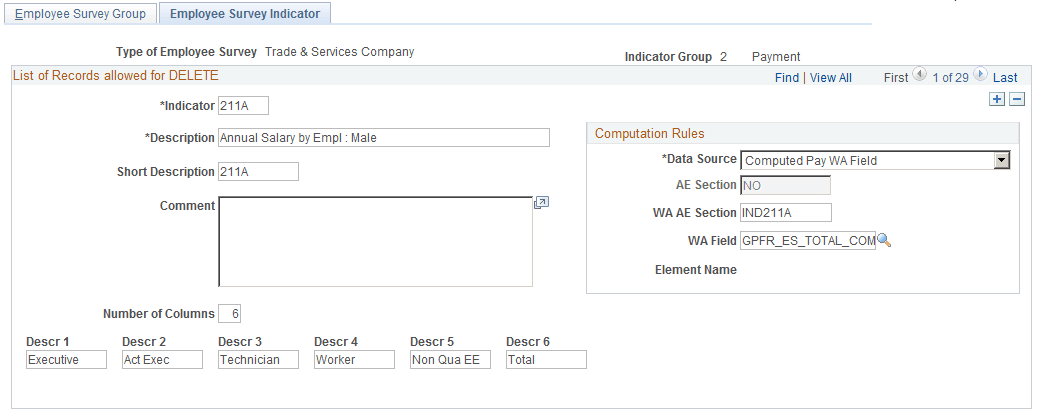

Employee Survey Indicator Page
Use the Employee Survey Indicator page (INDIC_SHEETTBL_FRA) to update the indicators and link the indicators with the relevant application engine section.
Navigation:
Set Up HCM, and then Product Related, and then Workforce Monitoring, and then Regulatory Requirements FRA, and then Define Emply Survey Indicators, and then Employee Survey Indicator
This example illustrates the fields and controls on the Employee Survey Indicator page. You can find definitions for the fields and controls later on this page.
Field or Control Description
Indicator
The code is defined in the employee survey legal requirement.
Number of Columns
Displays the total number of columns and the corresponding column descriptions that are entered on the Employee Survey Group page. The number of Descr. (description) fields that appear at the bottom of the page is linked to the value that you enter in the Number of Columns field.
The descriptions that you enter are the headings for the categories, or columns, on the report. In this example, the Payment group displays the following columns in the report: Executive, Act Exec, Technician, Worker, Non Qua EE and Total.

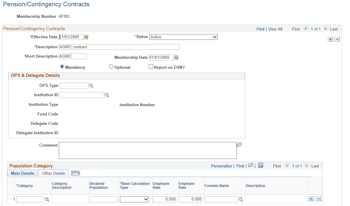

Pension/Contingency Contracts Page
Use the Pension/Contingency Contracts page (CNTRCT_FUND_FRA) to set up contract information for pension/contingency contracts.
Define your fund codes and institutions before you set up contract information.
Navigation:
Set Up HCM, and then Product Related, and then Workforce Monitoring, and then Regulatory Requirements FRA, and then Pension/Contingency Contracts, and then Pension/Contingency Contracts
This example illustrates the fields and controls on the Pension/Contingency Contracts page (1 of 2). You can find definitions for the fields and controls later on this page.
Pension/Contingency Contracts Page_1
This example illustrates the fields and controls on the Pension/Contingency Contracts page (2 of 2). You can find definitions for the fields and controls later on this page.
Pension/Contingency Contracts Page_2
Institution Nbr (institution number)
Select the institution associated with the membership number.
See Institution Type Page.
Institution Type
Displays the institution type that is defined on the Institution Type page.
Fund Code
Displays the institution's fund code that is defined on the Institution Type page.
Membership Date
Enter the date that the contract was initially signed.
Mandatory, and Optional
Select Mandatory if the contract applies to all employees in the companies and establishments selected. Select Optional if the contract applies to selected employees only.
If the institution type is ARRCO or AGIRC, the system selectsMandatory and the fields are display-only.
If a contract is optional, this affects the calculation of social and fiscal reinstatement in Global Payroll for France.
See PeopleSoft Global Payroll for France: Understanding ARRCO, AGIRC, and Contingency Fund Contributions.
Report on DSN?
Select the check box if you want to report the corresponding Membership ID as part of DSN.
OPS & Delegate Details
Use this area to enter the details about the OPS and its delegates that have contracts with the establishment.
OPS Type
Select the OPS type. The list displays only the OPS Types that are defined under Define OPS page with the field Uses Pension / Ctgy Contract? checked as yes.
Institution ID
Select the Institution ID based on the selected OPS type. Institution IDs are defined using the Pension/Ctgcy Institutions page.
Delegate Institution
Select the delegate Institution ID. This field is enabled only if you select Prevoyance as the OPS Type.
Population Category
This scroll area is available for entry if the institution type is Contingency and you have PeopleSoft Global Payroll for France installed. Use it to identify the population that is eligible for the contingency contract and define how contributions are calculated.
Category
Select the population category code that is eligible for the contract. Population category codes are defined on the Population Category page.
An employee's job code determines if the employee is eligible for a contract. Job codes are assigned an INSEE code, which in turn is linked to a population category code.
Declared Population
Use this field to override the default population category code defined in the Category field if the institution requires a specific code in the DUCS declaration.
Base Calculation Type
Select the base calculation type.
If contributions are calculated by multiplying a base by a rate, select the funding base type which is used by Global Payroll for France to calculate contributions. Enter the rate values in the Employee Rate andEmployer Rate fields.
If contributions are not calculated by multiplying a base by a rate, select Other and select the formula in theFormula Name field.
Employee Rate
Enter the employee rate. This value is multiplied by the base you specified in the Base Calculation Type field to calculate the employee contributions. This field is not available if you select Other in the Base Calculation Type field.
Employer Rate
Enter the employer rate. This value is multiplied by the base you specified in the Base Calculation Type field to calculate the employer contributions. This field is not available if you select Other in the Base Calculation Type field.
Formula Name
Select the formula that calculates employee and employer contributions. This field is only available if you select Other in the Base Calculation Type field. If this field is left blank and the Base Calculation Type is Other, the system issues a warning message.
See PeopleSoft Global Payroll: Defining Formula Elements.
Companies
Company
Select the company that subscribes to the contract. This field is available if the contract is mandatory. If it is an optional contract you assign the contract to employees using the Update Contracts component (CONTRACT_DATA)
Payment Method
Select the payment method used by the company for settlement.
Deposit Schedule
Select the Deposit Schedule applicable for the selected company. This value is unique for a company.
Note: The naming convention used for Deposit Schedule is mentioned in the Deposit Schedule section.
Source bank ID
Select the source bank ID for the selected company. Source Bank Ids are defined in the Source Bank Accounts page.
Payer Establishment
Select the establishment corresponding to the selected company that makes the payment.
Case Code
Select the case code corresponding to the selected OPS.
Establishments
Select the establishments that subscribe to the contract. This field is available if the contract is mandatory.
If the contract is mandatory and you leave the Company and Establishment ID fields blank, the system issues an error message.
Define OPS Page
Use Define OPS page(OPS_SETUP_FRA) to define new OPS types. You can also view the existing list of OPS and corresponding delegates.
Navigation:
Set Up HCM, and then Product Related, and then Workforce Monitoring, and then Regulatory Requirements FRA, and then Define OPS
This example illustrates the fields and controls on the Define OPS page. You can find definitions for the fields and controls later on this page.
Define OPS Page
OPS Type
Enter the OPS type. Available values are IRC (Agirc Arrco), IOPS (URSSAF), MUT (Mutuelle), ASSU (Assurance), PRV (Prevoyance) and CIBTP (Caisse).
Delegate Code
Enter the delegate code used for the corresponding OPS Type.
Delegate Code refers to the delegate institution affiliated to an OPS and is authorized to transact on behalf of the company/establishment. Delegate Institution acts as a mediator between a company/establishment and the OPS.
Use Pension/Ctgcy Contract?
Select Yes or No to indicate whether the OPS has a contract (Membership ID) with establishments defined under Pension/Contingency Contract component.
If the value is No, you need to capture Institution ID / Delegation ID in the OPS by Establishment page.
Obligatory
Select Yes or No to indicate whether the reporting of selected OPS is mandatory as per French law. If the value is Yes, you need to report all correlated nodes in DSN.
Node Details
Click the Node Details link to access the OPS Node Details page to select the nodes to be reported in DSN.
By default, all the nodes will be selected. You can deselect it only if the OPS is not mandatory by French law.
Use Define OPS By Establishment page(OPS_ESTAB_SETUP) to define OPS parameters for each establishment within a company. In this page, you can enter only the details of OPS types that are not bound by a contract.
Navigation:
Set Up HCM, and then Product Related, and then Workforce Monitoring, and then Regulatory Requirements FRA, and then Define OPS by Establishment
This example illustrates the fields and controls on the Define OPS by Establishment page. You can find definitions for the fields and controls later on this page.
OPS by Establishment: Main Details Tab
Establishment ID
Select the establishments that are mapped to the selected company.
OPS Type
Select the OPS Type.
Institution ID
Select the Pension/Ctgcy Institution based on the selected OPS Type.
Delegate Code
Select the Delegate Code.
Only the delegate codes mapped for the selected OPS type will be listed.
Delegate Institution ID
Select the Pension/Ctgcy Institutions based on the selected Delegate Code.
Report on DSN?
Select the check box to report the corresponding OPS as part of DSN.
Report Retro Period
Select the check box to enable reporting of Retro periods under the S21.G00.22 node.
OPS by Establishment: Other Details Tab
Case Code
Select the Case Code for each OPS.
Payer Establishment
Select the establishment that makes the payment.
If no value is entered against Payer Establishment, system assumes that the payment is not done through DSN and the node S21.G00.20 and S21.G00.55 will not be reported in DSN.
Payment Method
Select the payment method. List of values includes Bank Transfer, Cash, Check etc
Deposit Schedule
Select the required deposit schedule.
The minimum of Debit Date based on current month will be reported under the node/attribute S21.G00.20.011.
Source Bank ID
Enter the source bank ID.
This field will be enabled only if the Payer Establishment is defined and if the Payer Establishment is the same as the Establishment ID selected.
