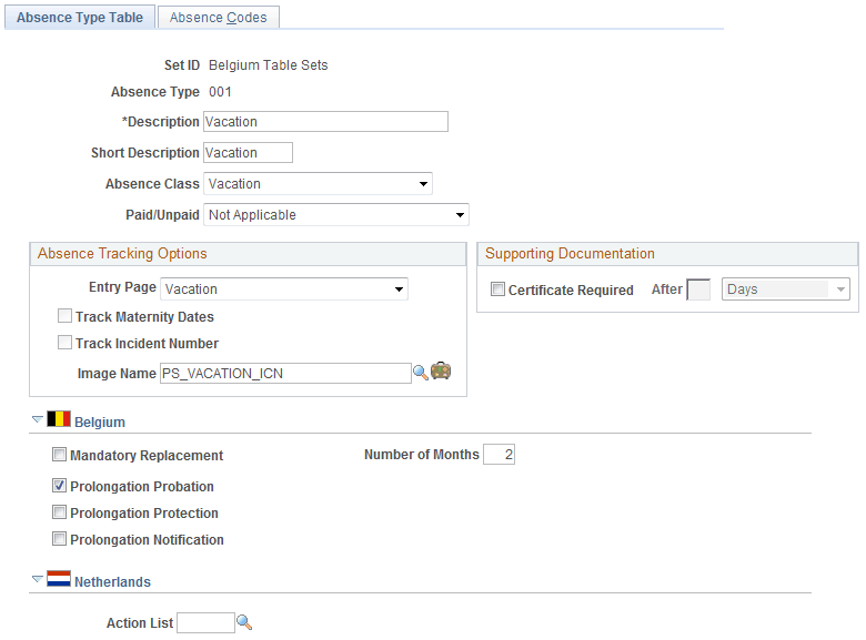

Absence Type Table Page
Use the Absence Type Table page (ABS_TYPE_TABLE) to define the types of absences that a person takes.
Navigation:
Set Up HCM, and then Product Related, and then Workforce Administration, and then Absence, and then Absence Type Table, and then Absence Type Table
This example illustrates the fields and controls on the Absence Type Table page. You can find definitions for the fields and controls later on this page.
Field or Control Description
Absence Type
Displays the type of absence that you entered to access this page.
Note: Customers using Global Payroll and/or Absence Management must associate the relevant Absence Take to the Absence Type in order to trigger the same functionality.
Absence Class
Select types of absences that you want to group for reporting purposes. Generally, the absence class is a category to which the absence type belongs. For example, if you track three different types of sicknesses, you could categorize them all under the absence class Sickness for reporting purposes.
Paid/Unpaid
Select a value to indicate whether people using this absence type are paid while absent.
Note: Indicating that an absence type is paid does not mean that the system automatically generates a payment for this type of absence. You must set up the payments through the payroll system.
Absence Tracking Options
The options in the Absence Tracking Options group box control how and where absence data is processed on the Absence Data, Vacation, UK Maternity Leave, or UK Paternal Leave pages.
Entry Page
Select a value to indicate the default for this absence type. Options are:
General Absence: Track information on all absences of this type.
UK Maternity Leave: Track UK maternity leave only.
UK Paternal Leave: Track UK paternal leave only.
Vacation: Use for other types of leave that are not categorized by the preceding two options.
Track Maternity Dates
Select this option to track maternity absence on the Absence Data page. The page includes a Maternity link that enables you to enter additional maternity data, such as expected and actual birth dates.
Track Incident Number
Select this option to track incidents on the Absence Data page. This option enables you to associate incidents that you create in PeopleSoft Health and Safety with absences that you enter as part of absence monitoring.
Image Name
Displays a graphical representation of the symbol to be used to denote the selected absence type on the absence calendar. PeopleSoft provides images for Sickness, Vacation, and Maternity for certain setIDs.
Supporting Documentation
Certificate Required After
Select this check box and enter the duration for which you require a certificate (if certification is required). In companies in many countries, people must produce a medical certificate or some other form of supporting documentation if the absence exceeds a specific number of days.
(BEL) Belgium
Enter data that is required to define absence types for Belgian companies.
Mandatory Replacement
Select this option to indicate that a replacement is required for this absence type.
Number of Months
If a replacement is required, indicate the length of time that the replacement can hold the position.
Prolongation Probation
Select this option if the absence affects a probation period. This option indicates that you may need to take the absence into account and extend the probation period.
Prolongation Protection
Select this option if the absence affects a protection period. This option indicates that you may need to take the absence into account and extend a protection period.
Prolongation Notification
Select this option if the absence affects a notification period.

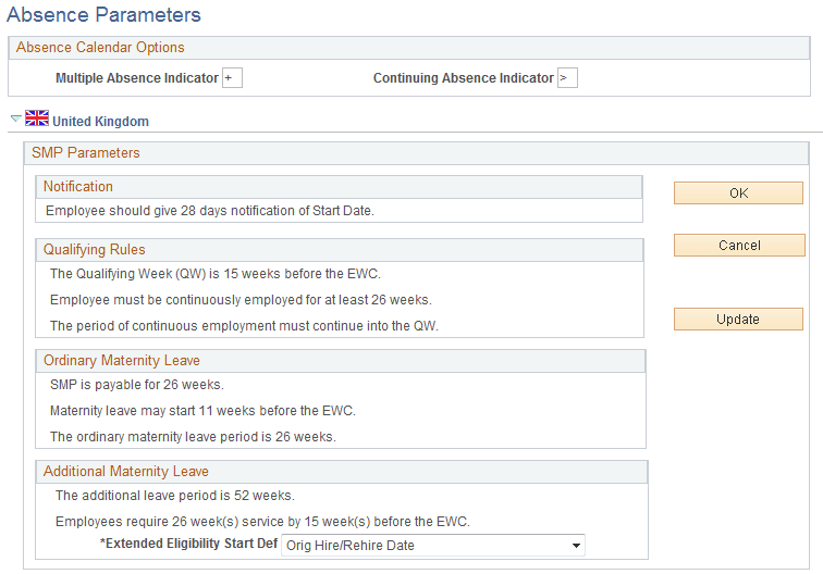

Absence Calendar Options
Multiple Absence Indicator
Displays the symbol that indicates multiple absences. You can change this symbol for different regulatory regions.
Continuing Absence Indicator
Displays the symbol that indicates an ongoing absence. You can change this symbol for different regulatory regions.

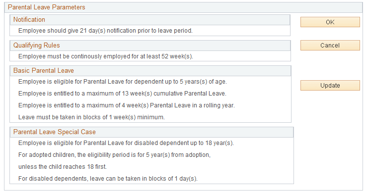

(GBR) United Kingdom
Use the statutory maternity pay (SMP) parameters and parental leave parameters to define statutory maternity pay and parental leave pay parameters for UK companies.
Update
Click to edit the fields in the United Kingdom collapsible section. By default, the fields (which are prescribed by UK regulations) are display-only, except for the Extended Eligibility Start Definition field.
Extended Eligibility Start Def. (Extended Eligibility Start Definition)
Select Orig Hire/Rehire Date to begin eligibility from the hiring date, or the rehire date, whichever is later.
Select Service Date to begin eligibility from the worker's service date.
In either case, the system uses the value stored in the worker's Employment Data page.
These values are for tracking purposes only. The PeopleSoft HR system does not calculate SMP or payments of parental leave. You must calculate SMP and parental leave, if paid, in your payroll or other external system.
