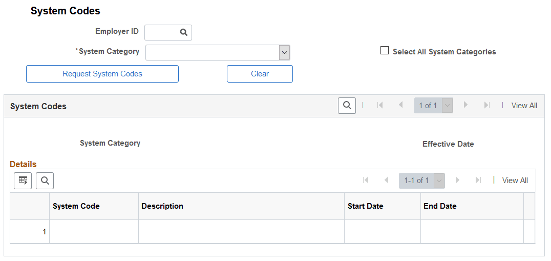

System Codes Page
Use the System Codes page (WCB_SYSTEM_CD) to request system codes.
Navigation:
Set Up HCM, and then Product Related, and then Workforce Monitoring, and then Health and Safety, and then WCB Web Service CAN, and then System Codes, and then System Codes
This example illustrates the fields and controls on the System Codes page. You can find definitions for the fields and controls later on this page.
System Codes page
Use this page to request system codes. It is necessary to request system codes only once during implementation unless new system codes are added.
Field or Control Description
Employer ID
Select the ID of the employer for which you are requesting system codes.
System Category
Select the system category for which you are requesting codes. This field becomes unavailable for edit if the Select All System Categories check box is selected.
Select to request system codes for all valid system categories.
Request System Codes
Click to initiate the system codes request to the WCB. The WCB sends a response message containing the valid system code values for the selected system category.
Clear
Click to deselect the displayed information in the System Codes group box.
System Code
Displays the system codes of the system category that you select.
Description
Displays the description of the system code.
Start Date
Indicates the date on which the system code became active.
End Date
Indicates the date on which the system code became inactive.
One of the system codes is SEXTY, which is the gender code. The PeopleSoft system derives the gender of an Empl ID from the Personal Data table, so the gender values of Male and Female are hard-coded. These values are the same as those currently delivered by the WCB, but if these values change or new values are added, you need to update the hard coded PeopleSoft values accordingly.

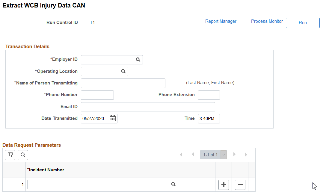

Extract WCB Injury Data CAN Page
Use the Extract WCB Injury Data CAN page (RUNCTL_WCB_501) to run the OHS501BC SQR process to populate staging tables with WCB injury data.
Navigation:
Workforce Monitoring, and then Health and Safety, and then Collect Health/Safety Data, and then Extract WCB Injury Data CAN, and then Extract WCB Injury Data CAN
This example illustrates the fields and controls on the Extract WCB Injury Data CAN page. You can find definitions for the fields and controls later on this page.
(CAN) Use this page to run the OHS501BC SQR process, which extracts injury data to staging tables, where it can then be transmitted to the WCB.
Transaction Details
Employer ID
Enter the employer ID assigned by the WCB.
Operating Location
Enter your organization's operating location ID.
Name of Person Transmitting
Enter the name of the primary point of contact for the transmitting organization.
Phone Number
Enter the phone number of the primary point of contact for the transmitting organization.
Phone Extension
Enter the phone extension of the primary point of contact for the transmitting organization.
Email ID
Enter the email address of the primary point of contact for the transmitting organization.
Date Transmitted
Enter the date on which the injury report data was extracted.
Time
Enter the time at which the injury report data was extracted.
Data Request Parameters
Use this group box to select the incidents for which you want to extract injury data.
