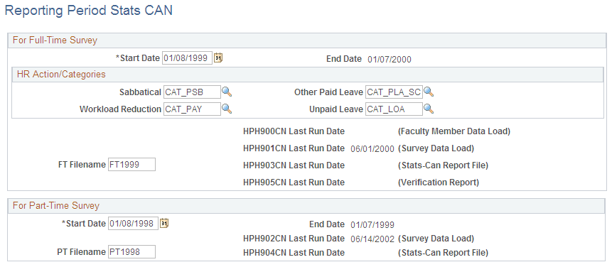

Reporting Period Stats CAN Page
Use the Reporting Period Stats CAN (reporting period Statistics Canada) page (HP_RPTNG_PRD_PNL) to create and maintain report period dates and parameters for the survey run controls.
Update the reporting period each reporting year.
Navigation:
Set Up HCM, and then Product Related, and then Workforce Development, and then Faculty Events, and then Reporting Period Stats CAN, and then Reporting Period Stats CAN
This example illustrates the fields and controls on the Reporting Period Stats CAN page.
For Full-Time Survey
Field or Control Description
Start Date and End Date
Enter the start date of the report period for the full-time survey. There are different report layouts for start dates before October 1, 2009 and for start dates equal to or after that date.
The system calculates the end date to be one day less than a year from the start date.
HR Action/Categories
Sabbatical, Other Paid Leave, Workload Reduction, and Unpaid Leave
Select the HR categories that represent Sabbatical, Workload Reduction, Other Paid Leave, or Unpaid Leave. This determines how the system counts HR actions that fall into these categories when creating the survey.
FT Filename (full-time filename)
Enter the name of the FT survey report flat file. Do not include a file suffix.
For Part-Time Survey
Enter the start date of the report period for the PT survey (part-time survey).
PT Filename (part-time filename)
Enter the name of the PT survey report flat file.
