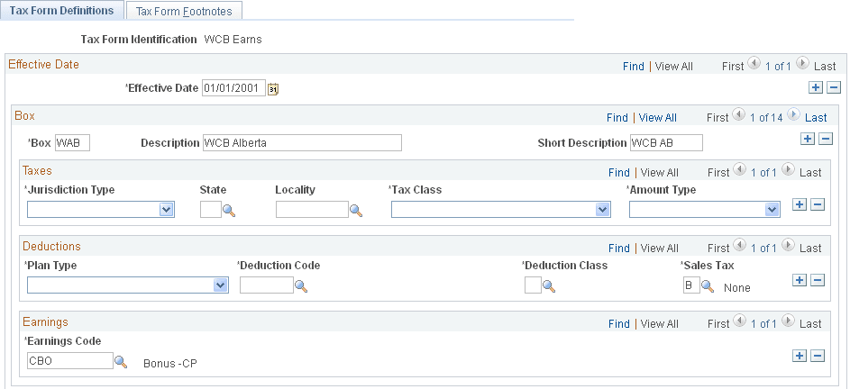

Use the Tax Form Definitions page (TAXFORM_DEFN_TBL) to define WCB assessable earnings.
Navigation:
Payroll for North America, and then Year-End Processing CAN, and then Define Annual Tax Reporting, and then Tax Form Definitions, and then Tax Form Definitions
This example illustrates the fields and controls on the Tax Form Definitions page.
To define WCB assessable earnings:
  1. Establish a new Tax Form ID—WCB Assessable Earnings—and the associated tax form Boxes for each province on the Tax Form Definition page.
    The Boxes reflect the two-letter province code, preceded by a W.
  2. Define and associate the assessable Earnings and Deduction Codes for each province with the WCB Assessable Earnings Tax Form ID.
    Select the applicable provinces and define the assessable earnings.
    The Earnings Codes defined as Regular Hours and Overtime Hours on the Pay Group table are automatically accumulated by the system as assessable earnings without defining them on the Tax Form Definitions page.
  3. Associate the WCB Assessable Earnings tax form ID with the appropriate Plan Type, Deduction Code, Deduction Class, Sales Tax, and Earnings Code.
    The earnings codes defined as Regular Hours and Overtime Hours on the Pay Group table are automatically accumulated by the system as assessable earnings without defining them on the Tax Form Definitions page.
