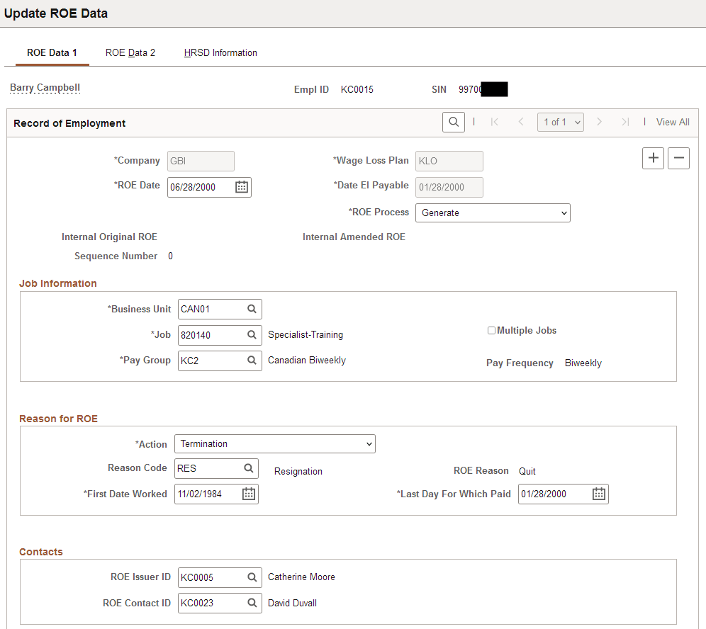

ROE Data 1 Page
(CAN) Use the ROE Data 1 (Record of Employment data 1) page (ROE_DATA1) to manually create a ROE and enter employment-related details.
Navigation:
Payroll for North America, and then Periodic Payroll Events CAN, and then Record of Employment , and then Update ROE Data, and then ROE Data 1
This example illustrates the fields and controls on the ROE Data 1 page.
ROE Data 1 page
Field or Control Description
Company
Enter the company as entered in the Job record.
Wage Loss Plan
Enter the wage loss plan as entered in the employee's Canadian Income Tax Data record.
ROE Date (Record of Employment date)
This date is for internal reference only. The default is the current date. During automated ROE creation, the default is the system date.
Date EI Payable (date Employment Insurance payable)
Enter the last date to which the EI premium is paid.
During manual ROE creation, the default comes from the Add − ROE Data dialog box. During automated ROE creation, the default is the end date of the last Insurable Earnings Balance record or the date in the Last Day For Which Paid field, whichever is earlier.
ROE Process
Identifies the process status of the ROE data records:
Complete: The final ROE has been created.
Delete: The ROE is ready to be deleted.
Generate: The ROE is ready to be included in the XML file creation
Hold: The ROE has been created but is not yet ready for submission to Service Canada.
Note: After ROE data records have been created and you have confirmed that all information is correct, you must update all acceptable records from Hold to Generate so that the ROE process can create the records in the ROE Web file format for submission to Service Canada.
XML File Created: The system assigns this status when the Create ROE Web Export File (PAY105CN) has been run in Final Data Export mode.
XML File Failed: The system assigns this status when the Import ROE Web Bulk File (PAY107CN) from Service Canada is run and failed ROE data records exist. Failed records have not followed the application rules provided in Appendix of the Service Canada web site. For example, an invalid Social Insurance Number would result in a failed record.
See Record of Employment on the Web (ROE Web) - Technical Specifications to develop an XML Interface on the Service Canada web site. As of the date of this publication, see Appendix D: ROE Payroll Extract File Transfer - XML File Layout and Edit Version 2.0.
XML File Rejected: The system assigns this status when the Import ROE Web Bulk File (PAY107CN) from Service Canada is run and rejected ROE data records exist. Rejected records contain an invalid CRA Business Number.
ROE Message
When the ROE Process field has a status of Complete, the ROE Process field disappears and the ROE Message field appears with a value of Complete.
Internal Original ROE
The system generates this number when it prints the final ROE and stamps it onto relevant Insurable Earnings Balance records.
Internal Amended ROE
The manual ROE creation process does not support amended ROEs. Leave this field empty if using the manual ROE creation process.
The system generates this number during the automated ROE creation process if the Final Data Export check box is selected on the Create ROE Web Export File run control page. The system also stamps the number onto the relevant Insurable Earnings Balance records. The system generates the Internal Original ROE number if the record is an amendment or replacement to an existing ROE.
Sequence Number (sequence number)
Leave this field empty because the manual ROE creation process does not support amended ROEs. During automated ROE creation, the system assigns a sequential number to identify different versions of an amended ROE.
Job Information
Business Unit, Job, and Pay Group
Enter this information as entered in the Job record.
Multi-Job (multiple jobs)
Select this check box if the employee has multiple jobs.
Pay Freq (pay frequency)
The system populates this entry according to the pay group.
Reason for ROE
Action and Reason Code
Note: You must make a selection for the Reason Code field. It populates block 16 on the ROE form.
First Date Worked
This date appears in block 10 of the ROE form.
This date appears in block 11 of the ROE form.
Contacts
ROE Issuer ID (Record of Employment issuer ID)
Select the employee ID of the person who issued the ROE.
ROE Contact ID (Record of Employment contact ID)
Select the employee ID of the person who can be contacted for additional information.

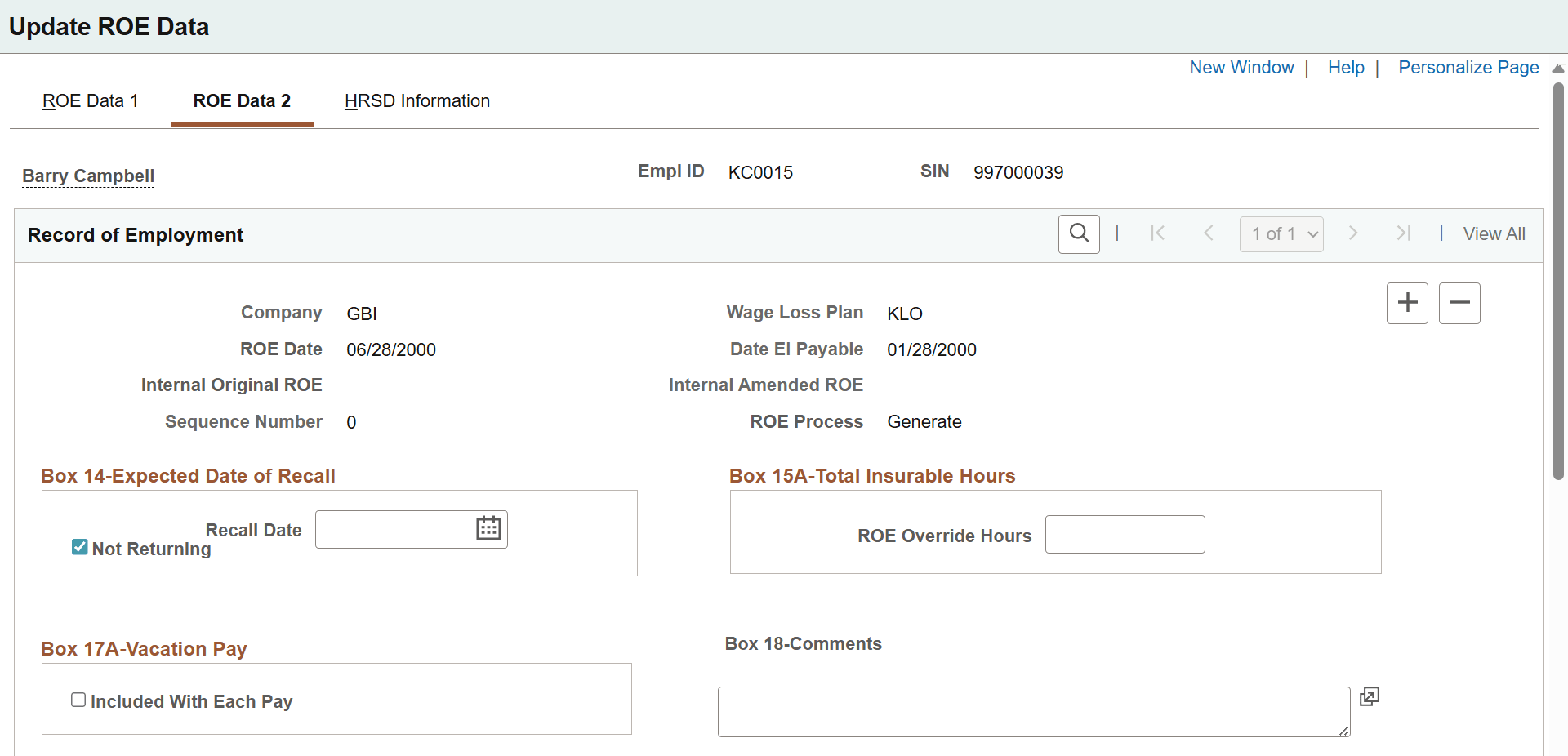

ROE Data 2 Page
(CAN) Use the ROE Data 2 (Record of Employment data 2) page (ROE_DATA2) to enter more employment-related details, after you finish entering data on the ROE Data 1 page.
Navigation:
Payroll for North America, and then Periodic Payroll Events CAN, and then Record of Employment, and then Update ROE Data, and then ROE Data 2
This example illustrates the fields and controls on the ROE Data 2 page (1 of 2).
This example illustrates the fields and controls on the ROE Data 2 page (2 of 2).
Box 14-Expected Date of Recall
Recall Date
Enter the expected return date as entered in the Employment Data record.
Not Returning
Select this check box if the employee is not returning to work (for example, the employee is retired or terminated).
If the Not Returning check box is deselected and the Recall Date field is empty, the system selects the Unknown check box in block 14 on the ROE form.
Box 15A-Total Insurable Hours
ROE Override Hours (Record of Employment override hours)
Enter the ROE override hours if you must correct the ROE insurable hours.
Box 17A-Vacation Pay
Select the Included With Each Pay check box if vacation pay is included in paychecks each pay period.

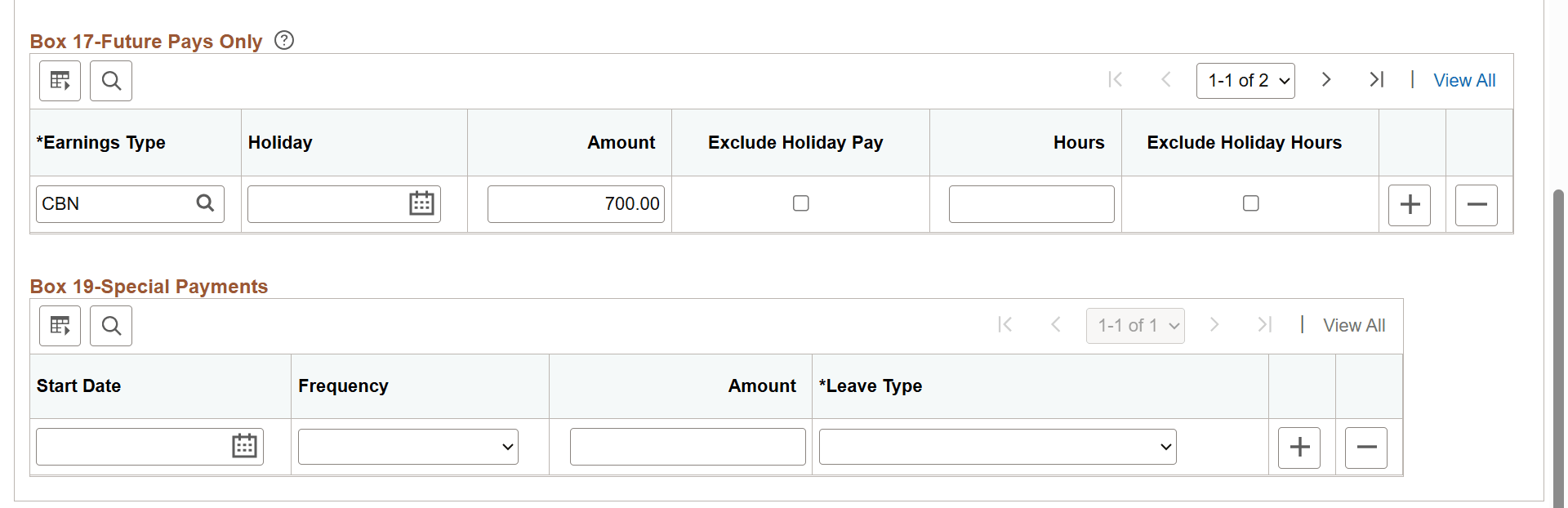

Box 17-Future Pays Only
Enter earnings paid to the employee after the employee's final pay period.
Earnings Type
You must define the earnings code on the Tax Form Definition page.
Holiday
This field is used for box 17B, Statutory Holiday.
Amount
Enter the amount that you paid to the employee after the final period.
The system does not automatically add this amount to balances for year-end reporting. When you use this field, you are responsible for ensuring that the applicable balance records are updated to reflect these amounts.
Exclude Holiday Pay
Select the Exclude Holiday Pay check box to exclude the amount reported for Statutory Holiday on ROE Data Block 17B from adding it to Block 15C (1).
Deselect the Exclude Holiday Pay check box to include the amount in Statutory Holiday on ROE Data Block 17B to Block 15C (1). By default, this check box is deselected.
Hours
This field is optional. When the number of hours is entered, it will be used to adjust the Total Insurable Hours reported on Box 15A for the employee, based on the Exclude Holiday Hours option selection.
Select the Exclude Holiday Hours check box to have the number of hours deducted from Total Insurable Hours reported on Box 15A.
Deselect the Exclude Holiday Hours check box to have the number of hours added to Total Insurable Hours reported on Box 15A.
Note: The Exclude Holiday Hours field applies to employees whose departure is Final (with the Not Returning check box selected). If you clear the Not Returning check box while Exclude Holiday Hours is selected and attempt to save the page, an out-of-sync message appears, indicating that holiday hours should be excluded only for employees who are not returning to work. The page cannot be saved until you review and update your selections properly.
Block 17 on the ROE form reports payments or benefits (other than regular pay) paid in, or in anticipation of the final pay period, or payable at a later date.
The following table describes how the system reports the earnings. You must first define all earnings on the Tax Form Definitions page (TAXFORM_DEFN_TBL):
Box Earnings Paid in Final Pay Period Earnings Paid After Final Pay Period
Box 17A
Vacation Pay
Earnings are reported in boxes 15C.
You must select the check box in Box 17A to indicate that vacation pay for the employee is included in every pay period.
You must enter additional vacation earnings manually on the ROE Data 2 page, Box 17. These earnings are reported in Box 15C.
Box 17B
Statutory Holiday Pay
For the earnings to be reported in box 17B, you must also enter the same earnings information on the ROE Data 2 page.
You must enter the earnings manually on the ROE Data 2 page, box 17. These earnings are reported in box 17B only.
You must enter the date of the holiday for which the employee is paid.
Box 17C
Other Monies
Earnings are reported in boxes 15C and 17C.
You must enter the earnings manually on the ROE Data 2 page, box 17. These earnings are reported in box 15C and 17C.
See also Defining Earnings for Translation to the ROE Form.
Box 18-Comments
These comments appear in block 18 on the ROE form. Use Box 18 only in extenuating circumstances where the reason codes provided are not sufficient to explain the need to issue a ROE. Comments entered in this box usually cause Service Canada to process the claim manually, delaying processing time.
Box 19-Special Payments
This group box corresponds to block 19 on the ROE form. Complete these fields only if the employee receives paid sick, maternity, parental leave, or group wage loss indemnity payments after the last day worked. These fields appear on the ROE form as you enter them here. The system does not validate them.
