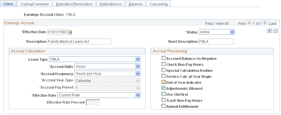

Earnings Accruals USF - Class page
Use the Earnings Accruals USF - Class page (GVT_ERN_ACR_CLASS) to define accrual class properties and key features, including the rules for calculating leave based on time in service and frequency of accrual.
Navigation:
Set Up HCM, and then Product Related, and then Payroll for North America, and then Compensation and Earnings, and then Earnings Accruals USF, and then Class
This example illustrates the fields and controls on the Earnings Accruals USF - Class page.
Accrual Calculation
This information enables the system to record the frequency of accrual and the units of leave time earned by members of the accrual class.
Field or Control Description
Leave Type
Note: Although you can define many different types of leave in the Earnings Accrual Class component, different accrual types require different rules. For example, because compensatory time does not accrue at regular rates based on years of service, you do not use the Earnings Accruals USF - Rates/Bonus page to link compensatory time earnings to service time. However, you do use this page for annual leave, which does vary according to years of service.
Accrual Units
Select the unit of time that the system uses to track, store, and quote the service intervals on which it bases accruals: Hours, Months, or Years.
Note: This value becomes the default on the Rates/Bonus page, where you associate accrual rates to time in service.
Accrual Frequency
Select the rate at which leave is earned and tabulated:
Hrs/Year (hours/year): When you select this value, the Accrual Year Type field becomes available for entry.
Hrs/Hour (hours/hours): Select this value to have employees earn leave at a rate of hours each hour.
Hrs/Month (hours/month): When you select this value, the Accrual Pay Period field becomes available for entry.
Hours/Pay Pd (hours/pay period): Select this value to have employees earn leave at a rate of hours in each pay period.
Hrs/Week (hours/week): Select this value to have employees earn leave at a rate of hours each week.
Note: This value becomes the default on the Rates/Bonus page.
Accrual Year Type
Select the type of dates to use as the beginning and ending dates of the year:
Calendar: The calendar year normally begins January 1 and ends December 31.
Fiscal: The fiscal year normally begins October 1 of a year and ends September 30 of the following year.
Leave: The leave year normally begins with the first full pay period that begins and ends within the calendar year. However, because the length of the leave year is 26 pay periods, the end date falls within the following year.
Pay: The pay year normally begins with the first full pay period that begins and ends within the calendar year, and it ends with the last pay period that begins and ends in the year.
Note: Before using these accrual year types, you must define them in the Pay Calendar table. You can modify the standard definitions as needed.
Accrual Pay Period
Select the pay period in which you want to grant leave earnings. For example, if the month contains multiple pay periods and you decide to distribute earnings after the first week, enter any value from 2 to 5 in the Accrual Pay Period field (with 2 indicating week two, 3 indicating week three, and so on). The default is 1 (week one).
Effective Rate
Select the disposition of excess leave balances: Current Rate, Rate Earned, or Current Rate Percent. Convert leave to pay using the pay rate in effect when the leave was originally accrued, the current rate of pay at the time of expiration, or a percentage of the current rate. When you select Current Rate Percent, the Effective Rate Percent field becomes available for entry.
Enter the percentage to use as the basis of calculations.
Accrual Processing
Use this group box to indicate how to process, calculate, and adjust accruals, and to establish a schedule for disposing of dated leave balances.
Accrued Balance Go Negative
For your information only.
Check Non-Pay Hours
Select to tabulate the number of nonpay hours to determine whether to grant accrual earnings. For example, suppose the standard hours for an employee are 80 hours per pay period. The employee has 70 nonpay hours going into a new pay period and takes an additional 10 hours of nonpaid time. The system adds the total number of nonpay hours (80), determines that this number equals the total of standard hours, and blocks any additional leave accrual for that pay period.
Special Calculation Routine
Not currently used by U.S. federal government customers.
Service Calc at Year Begin (service calculation at year begin)
Select to calculate leave hours according to length of service as of January 1 of the current year. To calculate leave hours according to the length of service as of the leave accrual process date, deselect this check box. The system uses the service date in the employee's Job Data component for this calculation.
End of Year Indicator
Select to expire restored leave at the end of the expiration year (Dec. 31). For example, if you restore an employee's leave on Jan. 15, 1998 and the leave expires in 24 months, the system extends the expiration date beyond the two-year limit to the end of the year in which the leave expires (December 31, 2000). This is for restored leave only.
Adjustments Allowed
Select to adjust leave at the line-item level on the Accrual Ledger page. Otherwise, the Accrual Adjustment button is not available.
Use Old First
Select when processing ceilings, carry overs, and expirations. The system reviews historic rows of leave and uses the oldest available leave first.
Track Non-Pay Hours
Select to track nonpay hours for a WGI. Nonpaid hours will be tracked on the accrual non pay ledger.
Annual Entitlement
Select to activate the annual entitlement calculation. After each pay period, the system calculates the employee's annual accrual entitlement balance along with the next pay period's accrual. This provides the information to determine how many leave hours employees can use before exceeding their full annual accrual entitlement. The number of hours to which an employee is entitled for the remainder of the year appears on the Accrual Summary page. Calculation formulas are provided in the overview.
See Understanding Earnings Accrual Classes.
