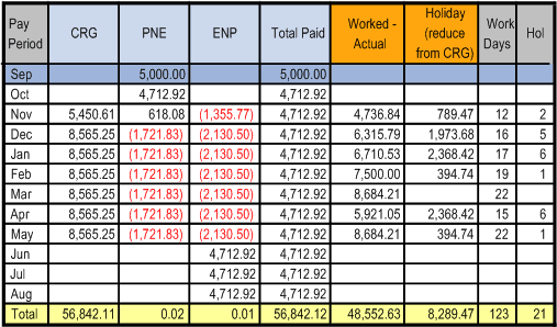

The following table shows the recalculated contract pay projections with worked earnings calculated using the Prorate method. The total worked earnings for each pay period is the sum of the Worked - Prorate earnings and the Holiday earnings. Because CRG shown in this table hasn't been reduced for holiday pay, the CRG also represents the worked earnings.
This diagram shows recalculated contract pay projections with worked earnings calculated using the daily rate Prorate method.
Employee starts work late and partial period is prorated: proration method

Worked Earnings per Pay Period
The daily rate for the contract is unchanged, so the worked earnings per pay period are reduced for November, when the employee worked fewer days than the original contract called for, but are the same for all other months.
The following table shows the recalculated contract pay projections with worked earnings calculated using the Actual method. The total worked earnings for each pay period is the sum of the Worked - Actual earnings and the Holiday earnings.
This diagram shows recalculated contract pay projections with worked earnings calculated using the daily rate Actual method.
Employee starts work late and partial period is prorated: actual method
