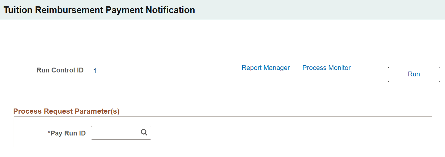

Tuition Reimbursement Payment Notification Page
Use the Tuition Reimbursement Payment Notification page (RUNCTL_PYTR_NOTIFY) to notify the HR system that tuition reimbursement payments have been processed successfully in Payroll for North America.

This example illustrates the fields and controls on the Tuition Reimbursement Payment Notification page.
Field or Control Description
Pay Run ID
Select the pay run ID that is associated with tuition reimbursement data that you want to send to the HR system. This process runs successfully only if on-cycle and off-cycle are confirmed for the selected pay run ID. If necessary, you can run this process more than once for the same pay run ID.
