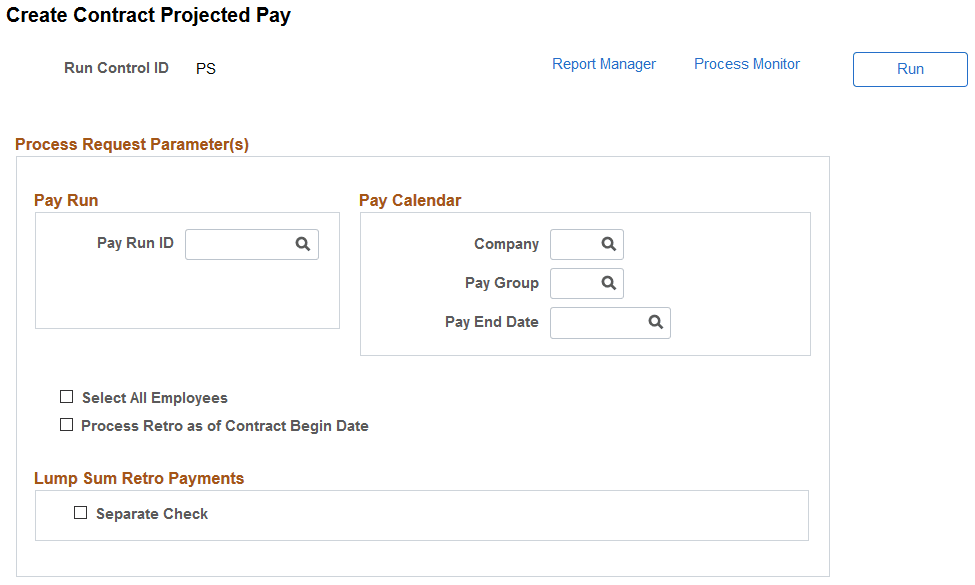

Create Contract Projected Pay Page
(E&G) Use the Create Contract Projected Pay page (RUNCTL_PAYINIT3) to run the Contract Additional Pay process to generate Contract Pay records.
Run this process before creating paysheets.
Navigation:
  • Payroll for North America, and then Payroll Processing USA, and then Create and Load Paysheets, and then Create Contract Projected Pay, and then Create Contract Projected Pay
  • Payroll for North America, and then Payroll Processing CAN, and then Create and Load Paysheets, and then Create Contract Projected Pay, and then Create Contract Projected Pay
This example illustrates the fields and controls on the Create Contract Projected Pay page.
Field or Control Description
Pay Run ID
If you are running the process by on-cycle run, enter the pay run ID that you are processing.
Company, Pay Group, and Pay End Date
If you are running the process by off-cycle pay calendar, enter the company, pay group, and pay end date of that you are processing.
Select All Employees
Select this check box to force a recalculation of the contract projected payment for all employees in the pay run.
Process Retro as of Contract Begin Date
Indicates if the pay rate change on the JOB row associated with an EffSeq is used in the calculation of pay adjustments. This checkbox is deselected by default.
When the Contract Projected Pay program is executed, and the Process Retro as of Contract Begin Date checkbox is selected, the pay adjustment will be calculated in the following scenario:
  • The Contract Renewal Process adds a new row in Job effective 01/01/20xx; and
  • There is an increase in the compensation rate effective 01/01/20xx, EffSeq 1.
When the Contract Projected Pay program is executed, and the Process Retro as of Contract Begin Date checkbox is deselected, the pay adjustment will not be calculated in the scenario above.
Separate Check
Select if you are running this process for a lump sum payment to be paid using a separate check.
