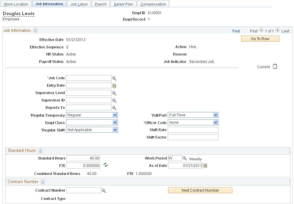

Job Information Page
Use the Job Information page (JOB_DATA_JOBCODE) to enter information about a person's job, including status, employee class, shift, or standard hours.
Navigation:
  • Workforce Administration, and then Job Information, and then Add Employment Instance, and then Job Information
  • Workforce Administration, and then Job Information, and then Job Data, and then Job Information
This example illustrates the fields and controls on the Job Information page (1 of 2).
This example illustrates the fields and controls on the Job Information page (2 of 2).
This step is employee-specific. Complete the USA section of the Job Information page when you hire an employee.
Field or Control Description
FLSA Status (Fair Labor Standards Act status)
Only nonexempt employees are entitled to FLSA calculation.
Work Day Hours
Displays the number of hours an employee is scheduled to work on a normal day, which the system uses to calculate the FLSA Basic Rate Formula.
Do not enter a salaried employee's compensation rate as an hourly rate (hourly frequency) in the Compensation Rate field on the Job Data - Compensation page. Under some conditions, doing so causes the system to pay minimum wage in place of the FLSA rate.
