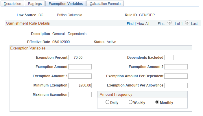

Exemption Variables Page
(CAN) Use the Exemption Variables page (GARN_RULE_TBL3_CN) to view or enter amounts for exemption variables to be used in the calculation formula for the rule.
Navigation:
Set Up HCM, and then Product Related, and then Payroll for North America, and then Garnishments, and then Rules Table CAN, and then Exemption Variables
This example illustrates the fields and controls on the Exemption Variables page for Canada.
Exemption Variables (CAN) page
Exemption Variables
View or enter values for the variables that you need in the calculation formula for this rule.
Field or Control Description
Dependents Excluded
Specify the number of dependents to exclude before applying the exempt amount per dependent. For example, for an exemption of 30 CAD per dependent when an employee has more than two dependents, enter 2 in this field, and enter 30 in the Exempt Amount Per Dependent field.
Exemption Amount
Enter the exemption amount for the debtor.
Exemption Amount 2
Enter the exemption amount for the debtor’s first dependent.
Exemptions Amount 3
Enter the exemption amount for each of the debtor’s additional dependents.
Minimum Exemption and Maximum Exemption
If you enter values for these options and specify the Min/Max Check condition for a step in the calculation formula, the system compares the calculation results for the step to the minimum and maximum exemption amounts that you enter here. If the amount is less then the minimum, the system uses the minimum. If the amount is greater than the maximum, the system uses the maximum.
Amount Frequency
Select the frequency that applies to the exemption variable amounts for this garnishment rule. The default frequency is Monthly.
If your selections on this page do not match the pay group pay frequency, the system automatically performs a conversion.

New Garnishment Rule(s)
For each new rule that you want to create based on the current rule, enter the law source, rule ID, and effective date.
You can clone one law source and rule ID combination into multiple combinations of law source and rule ID by adding rows and entering the identifiers.
You must enter an effective date for each new rule that you create. You can enter the same effective date for multiple rules as long as the law source and rule ID combination is unique.
