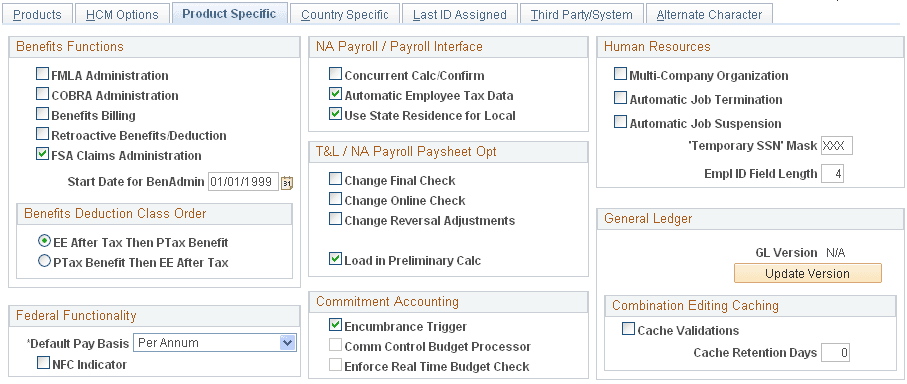

Installation Table - Product Specific Page
Use the Installation Table - Product Specific page (INSTALLATION_TBL1A) to select Time and Labor options for paysheet load.
Navigation:
Set Up HCM, and then Install, and then Installation Table, and then Product Specific
This example illustrates the fields and controls on the Installation Table - Product Specific page.
Options in the T&L/NA Payroll Paysheet Opt (Time and Labor and North American payroll paysheet options) group box relate specifically to the functioning of the integration between Time and Labor and Payroll for North America.
Field or Control Description
Change Final Check, Change Online Check, and Change Reversal Adjustments
We recommend that you do not select these options because they control whether users can make paysheet changes to data that is retrieved from Time and Labor. If you select these options, any changes made directly to the paysheets aren't transmitted back to Time and Labor.
Load in Preliminary Calc(load in preliminary calculations)
The Pay Calculation process uses the value of the Load in Preliminary Calc field to determine whether to load new available time (additional time that was worked before the job change but not previously entered on paysheets):
  • If you select this check box, the system loads all valid available time to the new paysheets, including new available time.
  • If you deselect this check box, the process does not load any new available time to paysheets except as noted below.
Note: If an employee had a Job data change that caused paysheets to be rebuilt, the Pay Calculation process attempts to reload all valid time and rejects time that is no longer valid as a result of the job change. This is true regardless of the setting of the Load in Preliminary Calc field. As a result, some new time might be loaded for employees who had a Job data change, even when this option is not selected on the Installation table.

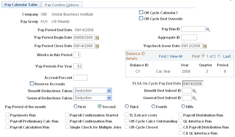

Pay Calendar Table Page
Use the Pay Calendar Table page (PAY_CALENDAR_TABLE) to view whether the Labor Distribution process has been run.
Navigation:
Set Up HCM, and then Product Related, and then Payroll for North America, and then Payroll Processing Controls, and then Pay Calendar Table, and then Pay Calendar Table
This example illustrates the fields and controls on the Pay Calendar Table page.
The system selects the TL Extract costs (time and labor extract costs) display-only check box if the labor distribution process has been run for the specified pay calendar.
