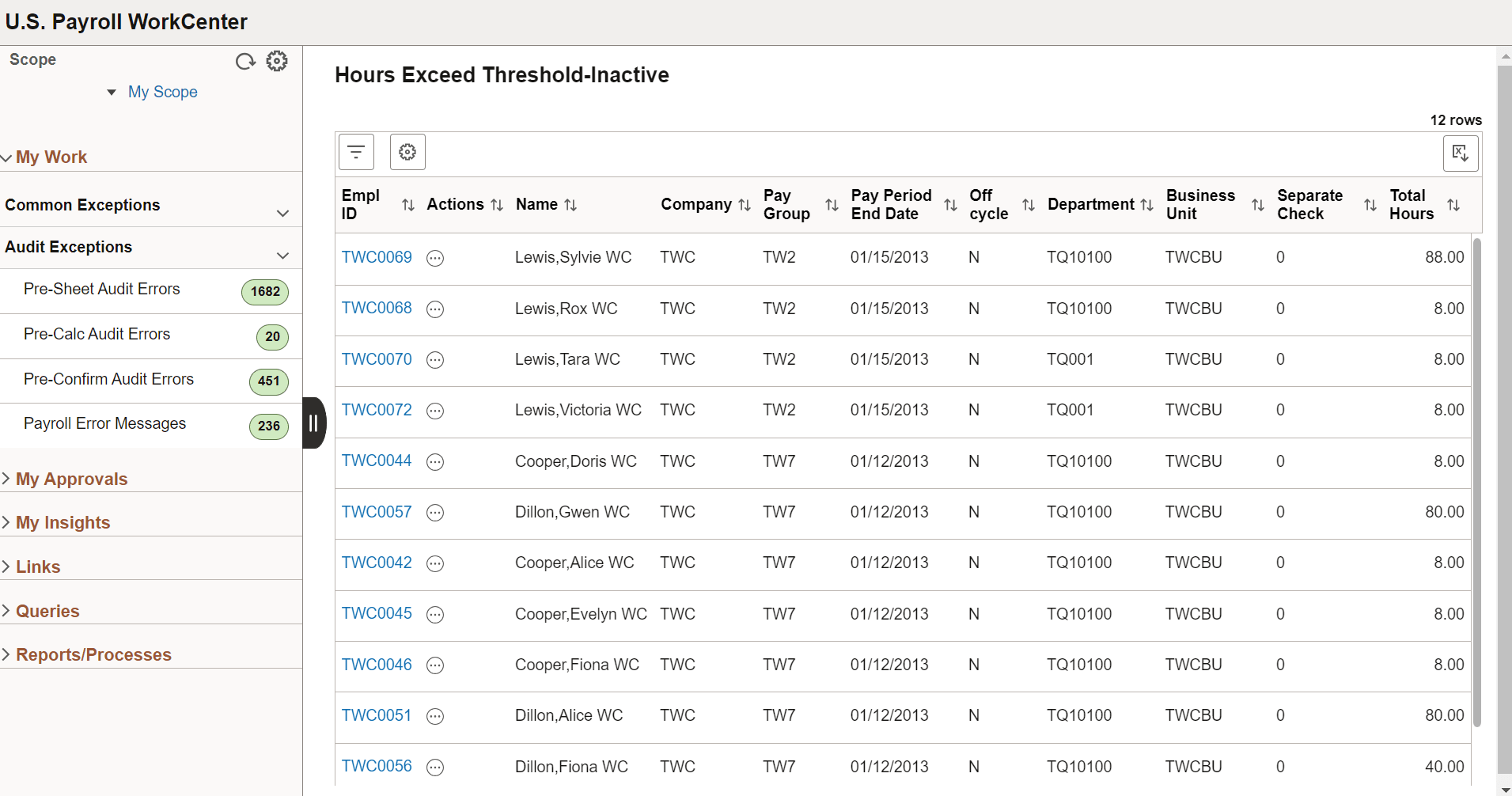

U.S. Payroll WorkCenter landing page
PeopleSoft delivers a Fluid WorkCenter for US payroll. The WorkCenter is preconfigured with work items, links, queries and reports, providing administrators access to real-time information and analytical sources based on their role-based security, and the ability to perform Payroll business process tasks from one central area.
Users can personalize display options and add links to their own WorkCenter for maximum efficiency. For more information, see Application Fundamentals: Setting Up and Personalizing PeopleSoft Fluid WorkCenters.
The WorkCenter page is divided into two areas: the navigation panel on the left and the transaction panel on the right.

The My Work group box provides Payroll work item links for exceptions in these group sections:
  • Common Exceptions
  • Audit Exceptions
Work item links are grayed out if no data is available for display.
System administrators can manage links and configuration options for the My Work group box on the Enterprise Components: Configure Pagelets - My Work Page. The configuration ID for the Fluid U.S. Payroll WorkCenter is PYUSA_FL.

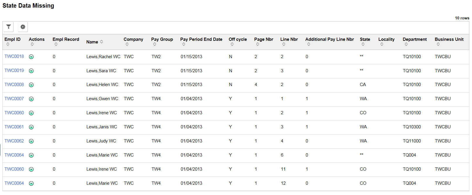

State Data Missing Page
Use the State Data Missing page (HWC_RSLT_FL) to view the list of employees with discrepancies by comparing the state tax information from the employee’s pay earnings record and the employee’s tax distribution and state tax data record.
Navigation:
Click the State Data Missing link in the My Work group box of the Payroll WorkCenter.
This example illustrates the State Data Missing page.

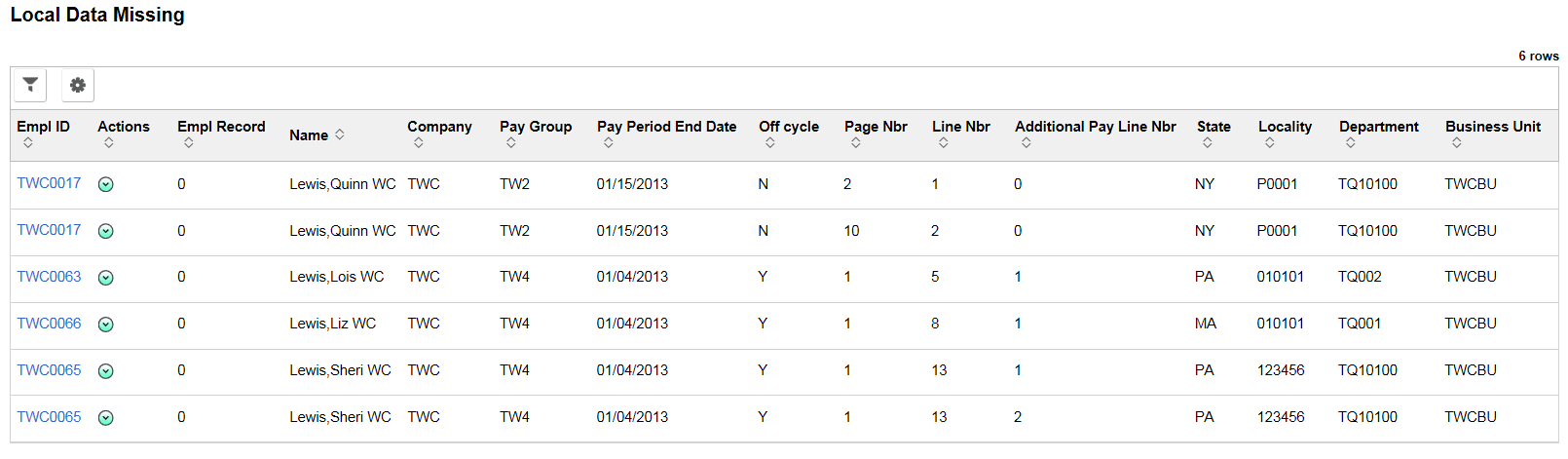

Local Data Missing Page
Use the Local Data Missing page (HWC_RSLT_FL) to view the list of employees with local tax data discrepancies.
Once the paysheets are created, the system searches through paylines to find employees with local tax information, and compares their state and local tax data record to the payline information to identify employees whose data does not match.
Navigation:
Click the Local Data Missing link in the My Work group box of the Payroll WorkCenter.
This example illustrates the Local Data Missing page.

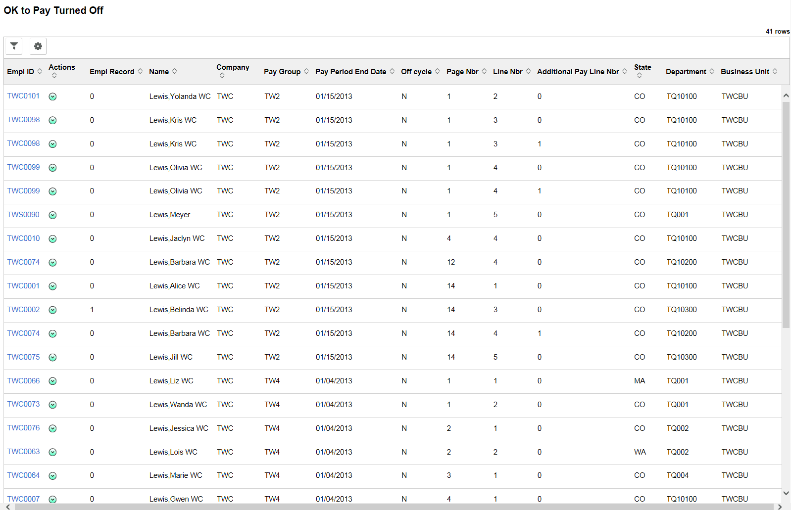

OK to Pay Turned Off Page
Use the OK to Pay Turned Off page (HWC_RSLT_FL) to view the list of employees whose OK to Pay option is deselected.
Navigation:
Click the OK to Pay Turned Off link in the My Work group box of the Payroll WorkCenter.
This example illustrates the OK to Pay Turned Off page.

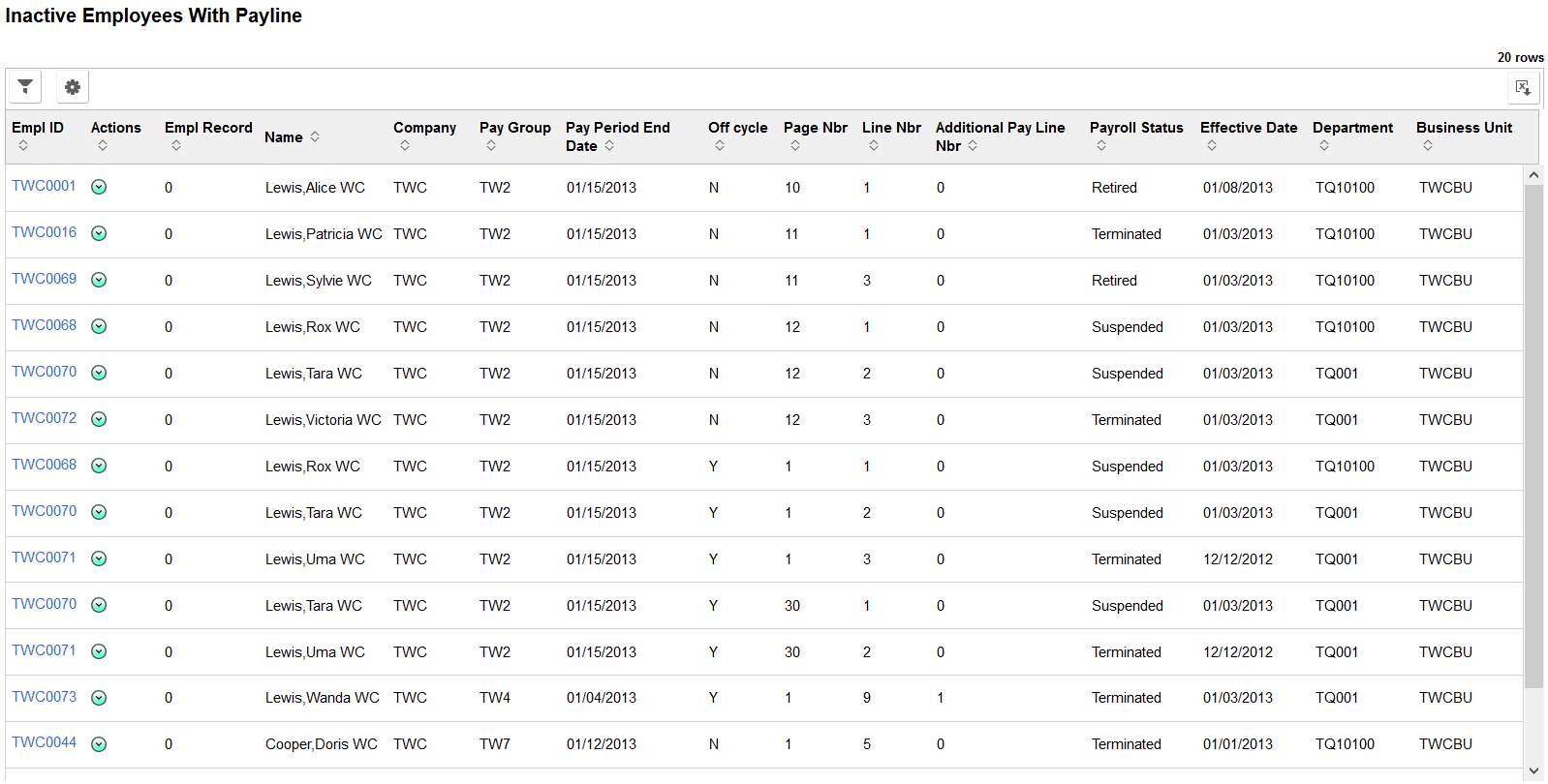

Inactive Employees With Payline Page
Use the Inactive Employees Without Payline page (HWC_RSLT_FL) to view the list of employees who are in an inactive payroll status and have a payline, which could result in possible overpayment. The list is displayed in the WorkCenter based on the configured pay groups and selected scope.
Navigation:
Click the Inactive Employees With Payline link in the My Work group box of the Payroll WorkCenter.
This example illustrates the Inactive Employees With Payline page.

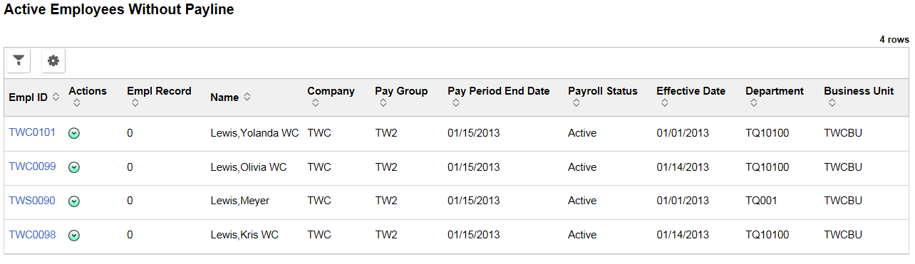

Active Employees Without Payline Page
Use the Active Employees Without Payline page (HWC_RSLT_FL) to view the list of employees who are in the Active payroll status and do not have a payline. The list is displayed in the WorkCenter based on the configured pay groups and selected scope.
The system determines the pay period begin and end dates of the open pay calendar for the company and pay group being processed, then uses the pay period begin date to search Job data records and identify employees who had an Active payroll status after that date.
Navigation:
Click the Active Employees Without Payline link in the My Work group box of the Payroll WorkCenter.
This example illustrates the Active Employees Without Payline page.

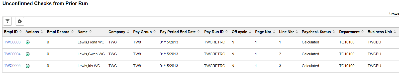

Unconfirmed Checks from Prior Run Page
Use the Unconfirmed Checks from Prior Run page (HWC_RSLT_FL) to view the list of checks from the previous pay period that were calculated but not confirmed. The list is displayed in the WorkCenter based on the configured pay groups and selected scope.
Navigation:
Click the Unconfirmed Checks from Prior Run link in the My Work group box of the Payroll WorkCenter.

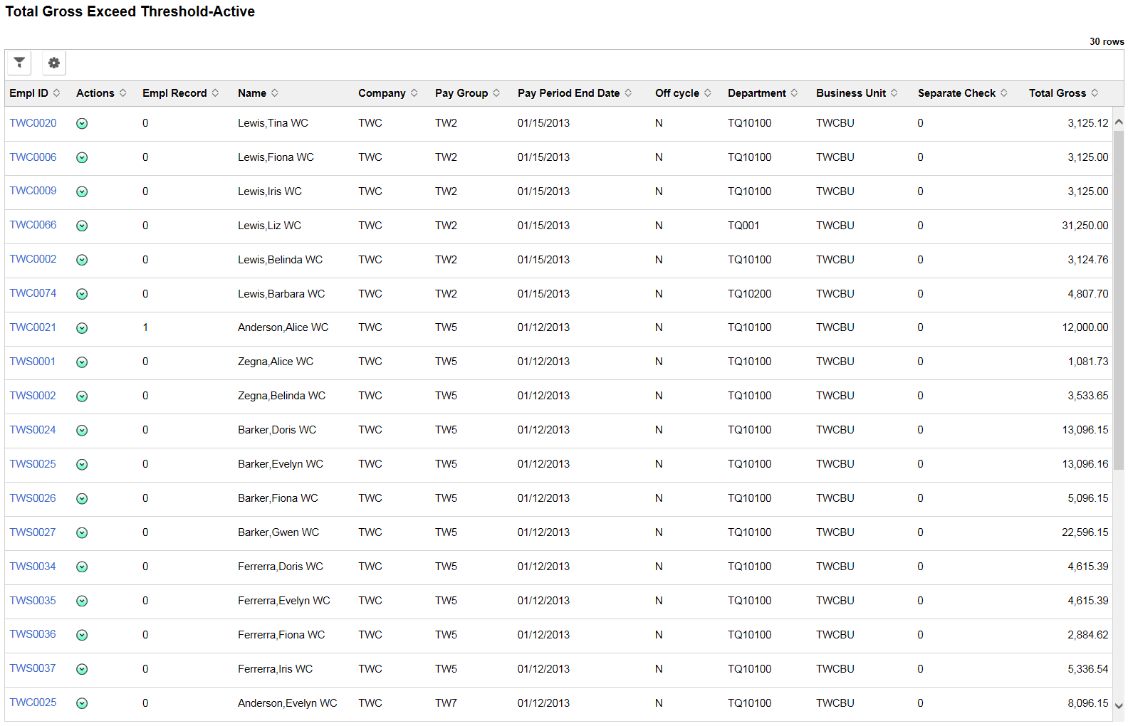

Total Gross Exceed Threshold-Active Page
Use the Total Gross Exceed Threshold-Active page (HWC_RSLT_FL) to view the list of active employees whose total gross earnings on the calculated check for the current pay period are greater than the threshold amount. The list is populated in the WorkCenter based on the configured pay groups and selected scope.
Navigation:
Click the Total Gross Exceed Threshold-Active link in the My Work group box of the Payroll WorkCenter.

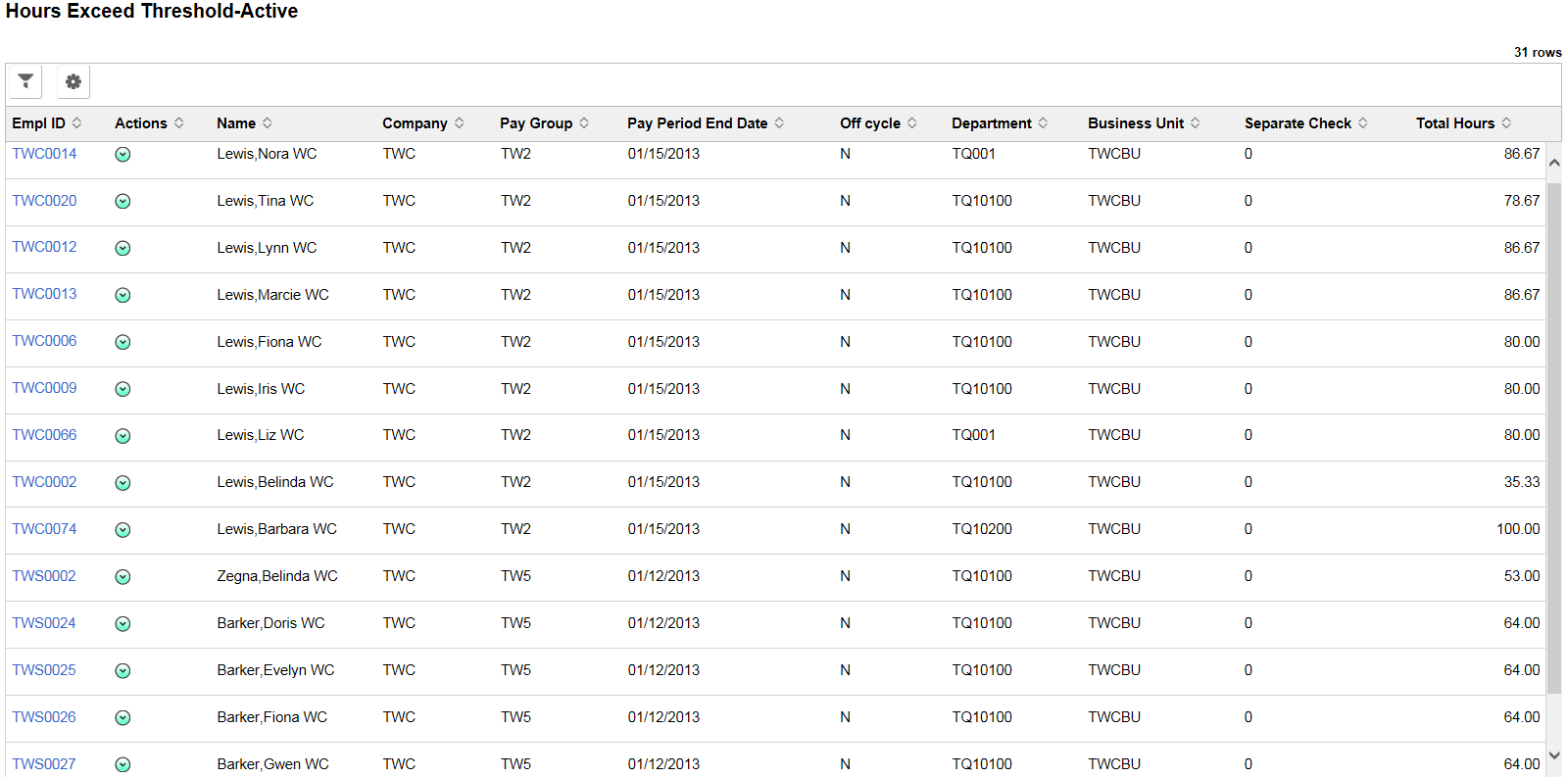

Hours Exceed Threshold-Active Page
Use the Hours Exceed Threshold-Active page (HWC_RSLT_FL) to view the list of active employees whose total number of work hours exceeds the threshold amount defined for the company and pay group.
After pay calculation, the system searches for active employees whose total hours for the pay period (including regular hours, overtime, double time, and straight overtime) are greater than the threshold hour amount defined for the company and pay group. The list is populated in the WorkCenter based on the configured pay groups and selected scope.
Navigation:
Click the Hours Exceed Threshold-Active link in the My Work group box of the Payroll WorkCenter.
This example illustrates the Hours Exceed Threshold-Active page.

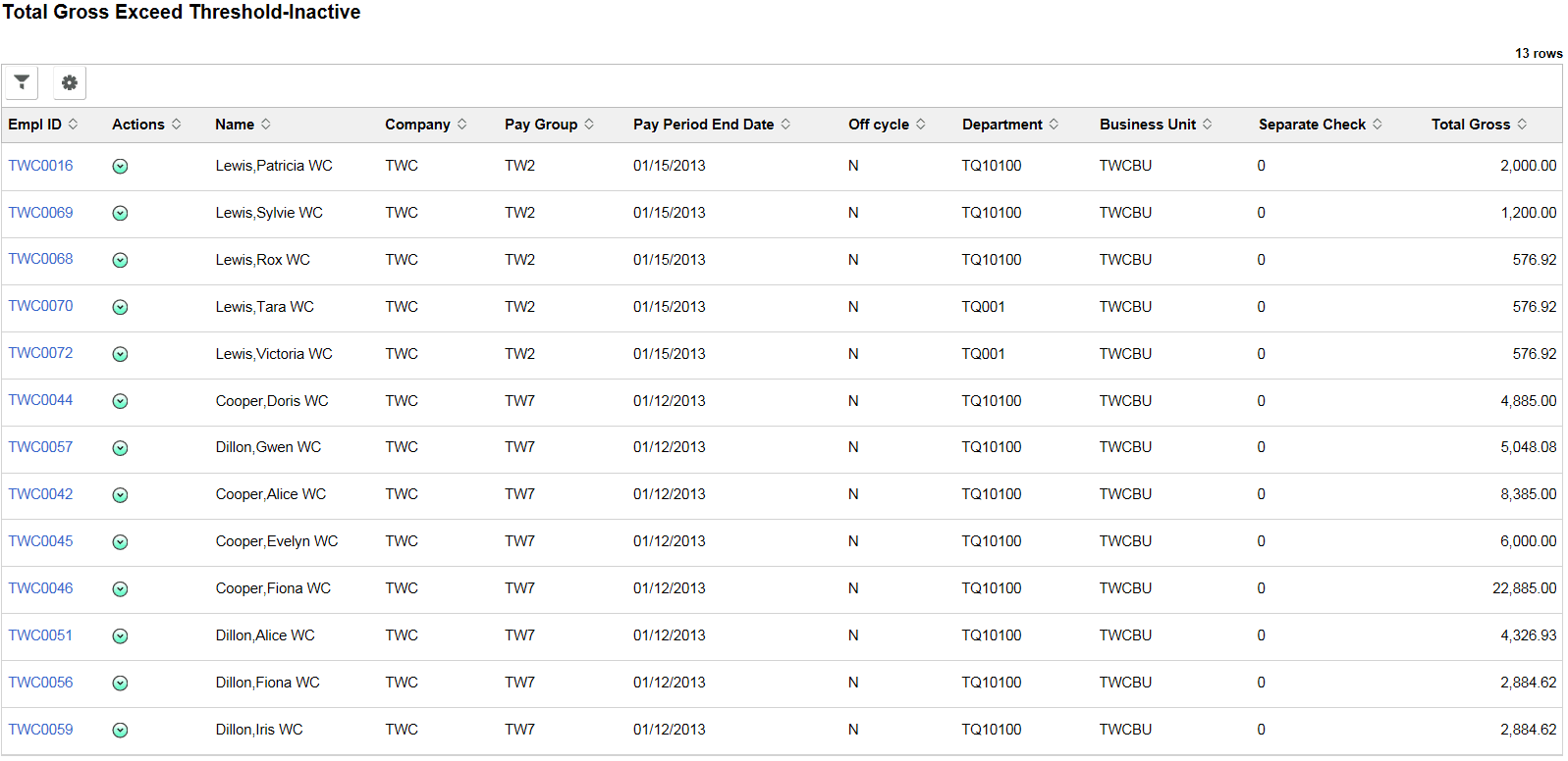

Total Gross Exceed Threshold-Inactive Page
Use the Total Gross Exceed Threshold-Inactive page (HWC_RSLT_FL) to view the list of inactive employees whose total gross earnings (including vacation payouts and severance pay) on the calculated check for the current pay period are greater than the threshold amount. The list is populated in the WorkCenter based on the configured pay groups and selected scope.
Navigation:
Click the Total Gross Exceed Threshold-Inactive link in the My Work group box of the Payroll WorkCenter.

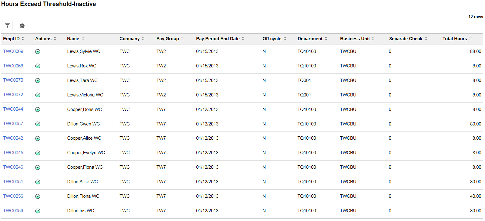

Hours Exceed Threshold-Inactive Page
Use the Hours Exceed Threshold-Inactive page (HWC_RSLT_FL) to view the list of inactive employees whose total number of work hours exceeds the threshold amount defined for the company and pay group.
After pay calculation, the system searches for inactive employees whose total hours for the pay period (including regular hours, overtime, double time, and straight overtime) are greater than the threshold hour amount defined for the company and pay group. The list is populated in the WorkCenter based on the configured pay groups and selected scope.
Navigation:
Click the Hours Exceed Threshold-Inactive link in the My Work group box of the Payroll WorkCenter.

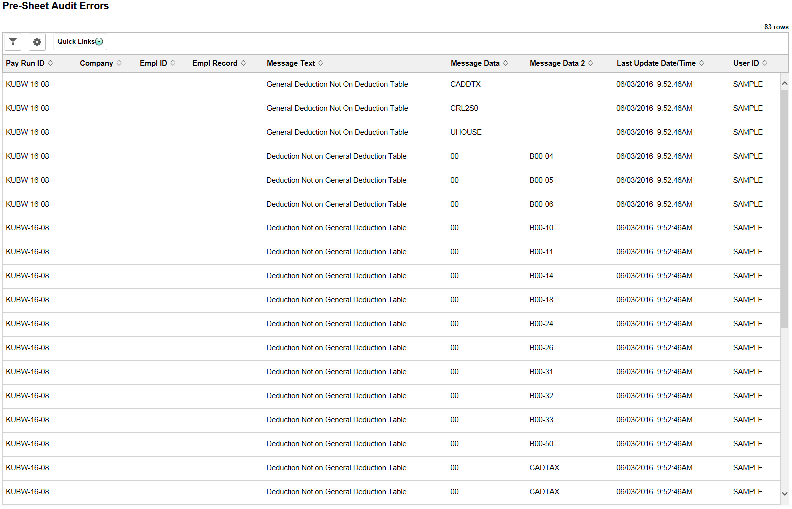

Pre-Sheet Audit Errors Page
Use the Pre-Sheet Audit Errors page (HWC_RSLT_FL) to view the audit error results generated from the Presheet Audit Report (PAY034).
Navigation:
Click the Pre-Sheet Audit Errors link in the My Work group box of the Payroll WorkCenter.
This example illustrates the Pre-Sheet Audit Errors page.

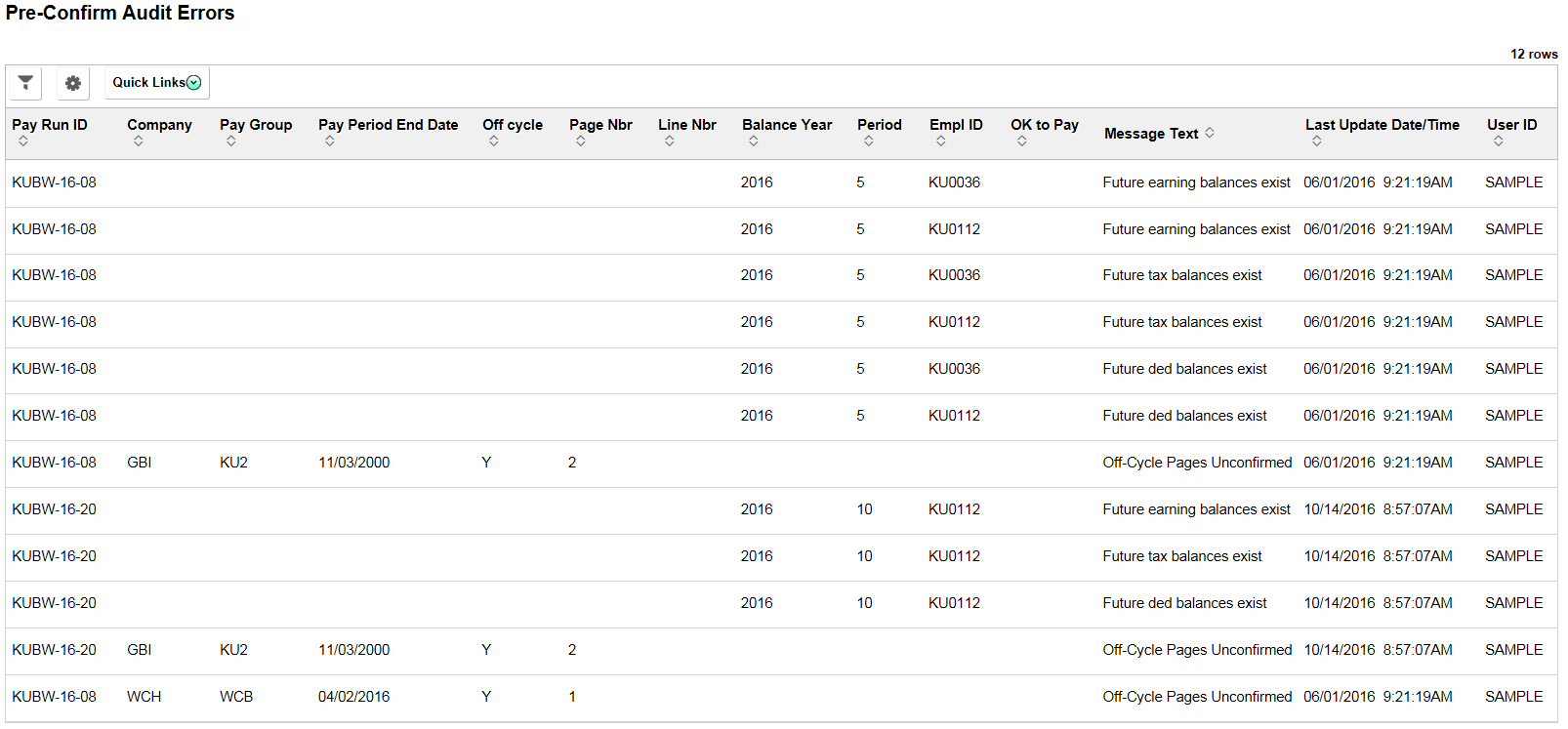

Pre-Confirm Audit Errors Page
Use the Pre-Confirm Audit Errors page (HWC_RSLT_FL) to view the audit error results generated from the Preconfirm Audit Report (PAY036).
Navigation:
Click the Pre-Confirm Audit Errors link in the My Work group box of the Payroll WorkCenter.
This example illustrates the Pre-Confirm Audit Errors page.

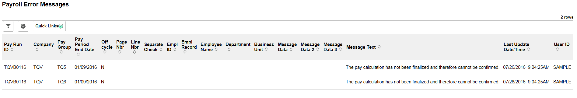

Payroll Error Messages Page
Use the Payroll Error Messages page (HWC_RSLT_FL) to view errors that occur during payroll processing. This page displays the results generated from the Payroll Error Message Report (PAY011).
Navigation:
Click the Payroll Error Messages link in the My Work group box of the Payroll WorkCenter.
