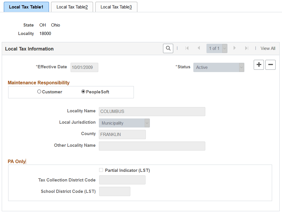

Local Tax Table1 Page
Use the Local Tax Table 1 page (LOCAL_TAX_TABLE1) to view information about the geographic area associated with a locality code.
Navigation:
Set Up HCM, and then Product Related, and then Payroll for North America, and then Local Taxes, and then Tax Table
This example illustrates the fields and controls on the Local Tax Table1 page.
Field or Control Description
Customer or PeopleSoft
All entries that Oracle delivers are the maintenance responsibility of PeopleSoft. However, if you add a locality to this table, the system marks it as Customer, indicating that it is your organization's maintenance responsibility.
Locality Name
The municipality name from the register (except for school district entries, which are school district name). Combined jurisdictions have the appendage M+SD.
Local Jurisdiction
Reserved for future use.
Other Locality Name
For Pennsylvania localities, combined entries display the school district name.
PA Only
Partial Indicator (LST) (Local Services Tax)
(Used for Local Services Tax only.) This check box is selected to indicate a Pennsylvania municipality that is co-terminus with multiple school districts, meaning the boundary of the municipality overlaps the boundaries of multiple school districts. For example, in Westmoreland County, the City of Greensburg is co-terminus with both the Greensburg Salem School District and the Hempfield Area School District. Be sure to use the Local Tax Table entry that represents the correct municipality/school district combination.
Tax Collection District Code
The 2-digit location code under which local earned income taxes are reported by the employer according to PA Act 32.
School District Code (LST) (Local Services Tax)
(Used for Local Services Tax only.) For Pennsylvanian localities, the appropriate school district code appears here.

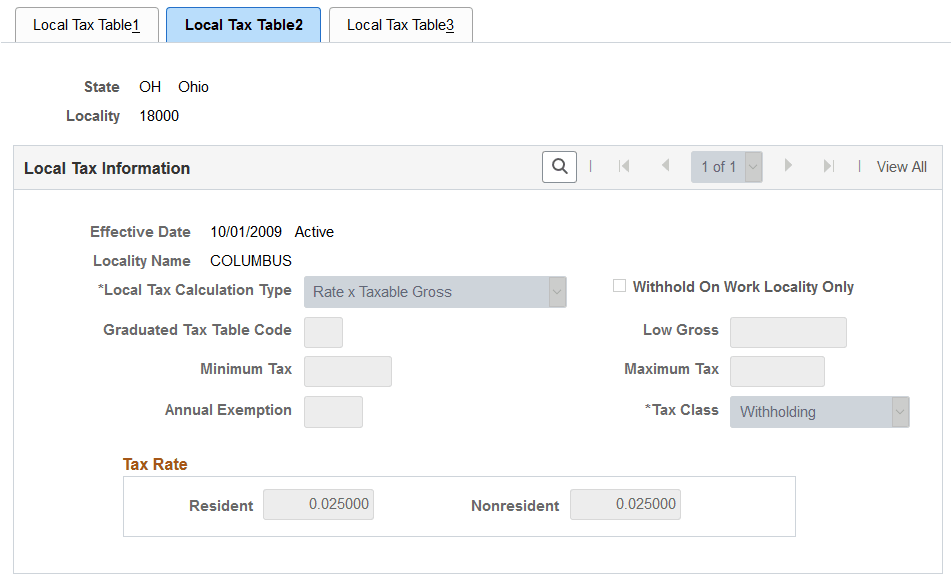

Local Tax Table 2 Page
Use the Local Tax Table 2 page (LOCAL_TAX_TABLE2) to view the method used to calculate local withholding taxes, tax rates, and other constants.
Navigation:
This example illustrates the fields and controls on the Local Tax Table2 page.
Local Tax Calculation Type
Indicates the calculation method used to determine the amount of local income tax withheld.
Withhold On Work Locality Only
When this check box is selected for a locality, only wages earned in that locality are considered taxable for residents of the locality. No resident tax is withheld from wages paid for work performed outside of the locality.
Graduated Tax Table Code
This option takes effect if the locality requires that tax tables be referenced during calculation, as do New York City, Yonkers, and Maryland counties. In this case, the graduated tax table code entered here links the record to the appropriate entry in the PeopleSoft Federal/State Tax table where the graduated tax rates are stored.
Tax Rate
Resident
This field displays the tax rate for residents of the locality.
Nonresident
This field displays the tax rate for nonresidents in the locality.

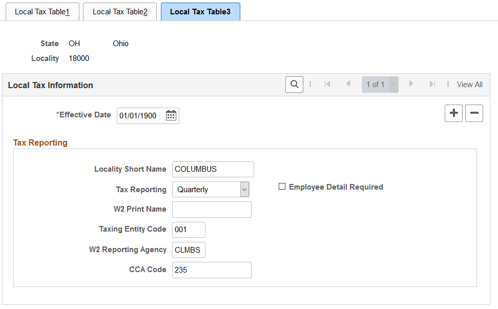

Local Tax Table3 Page
Use the Local Tax Table3 page (LOCAL_TAX_TABLE3) to enter data on the locality's tax reporting requirements.
Navigation:
This example illustrates the fields and controls on the Local Tax Table3 page.
Information on this page is used in quarterly and year-end reporting.
Locality Short Name
The value in this field is printed as the locality name on Form W-2 if the W2 Print Name field is blank. If both the Locality Short Name and W2 Print Name fields are blank, then a truncated version of the value in the Locality Name field on the Local Tax Table1 page is used.
Note: Customers are responsible for populating the Locality Short Name field for localities in Pennsylvania
Tax Reporting
Displays the interval required by the locality for tax reporting, Monthly, Quarterly, or Annual. This field is for your reference only. It has no function in the system.
Employee Detail Required
This check box is for your reference only. It has no function in the system.
W2 Print Name
A value entered in this field overrides a value in the Locality Short Name field to print as the locality name on Form W-2.
Note: Do not change any Oracle-delivered value that automatically populates this field.
Taxing Entity Code
Identifies the locality on the appropriate electronic or magnetic media records when reporting W-2 data to either state or local tax agencies. The system populates this field for the localities for which PeopleSoft supports the reporting of W-2 data to state and/or local tax agencies.
W2 Reporting Agency
Identifies the tax reporting agency to which W-2 data for the locality is submitted electronically or on magnetic media. In some cases, the value in this field is also included in the file records.
CCA Code
This field stores specific mandated CCA City Codes that are required in positions 7-9 on the RS Record, as well as specific mandated State Control numbers that are required in positions 331-337 in the files created by TAX960LC to report W-2 data to CCA local tax authorities. The CCA City Code is separated from the State Control number with a hyphen. This field is maintained by PeopleSoft, and is populated for all CCA Members and CCA Recognized Cities.
Note: For the Ohio localities where the field is blank, positions 7-9 on the RS Record will be hardcoded with “887” per the CCA requirements.
Important:
If you add a locality, you are responsible for maintaining the entries on these tables for the new locality until PeopleSoft incorporates it into a tax update. Contact your Global Support Center if you discover any localities not listed or any errors so we can include the addition or correction in the next PeopleSoft Payroll Tax Update.
