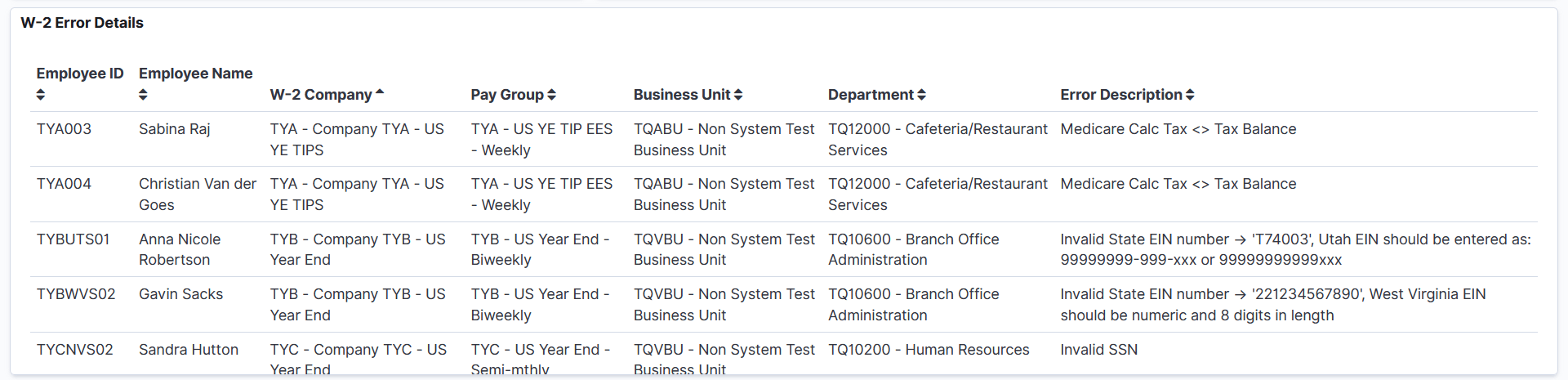

    • For Year-End Audit:
      HC_HPY_W2_YEDATA_LD_US (Year End Data Load)
      HC_HPY_YE_FMS_W2C_DTLS_US (Year End W-2 Forms Correction Reasons)
      HC_HPY_YE_W2C_FMS_US (Year end W-2 correction forms)
      HC_HPY_AUDT_ERR_US (Year End Audit error details)
      HC_HPY_US_YE_AUDIT_FLTR (Year End Audit Filters)

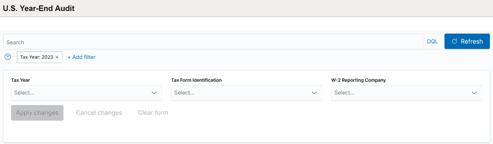

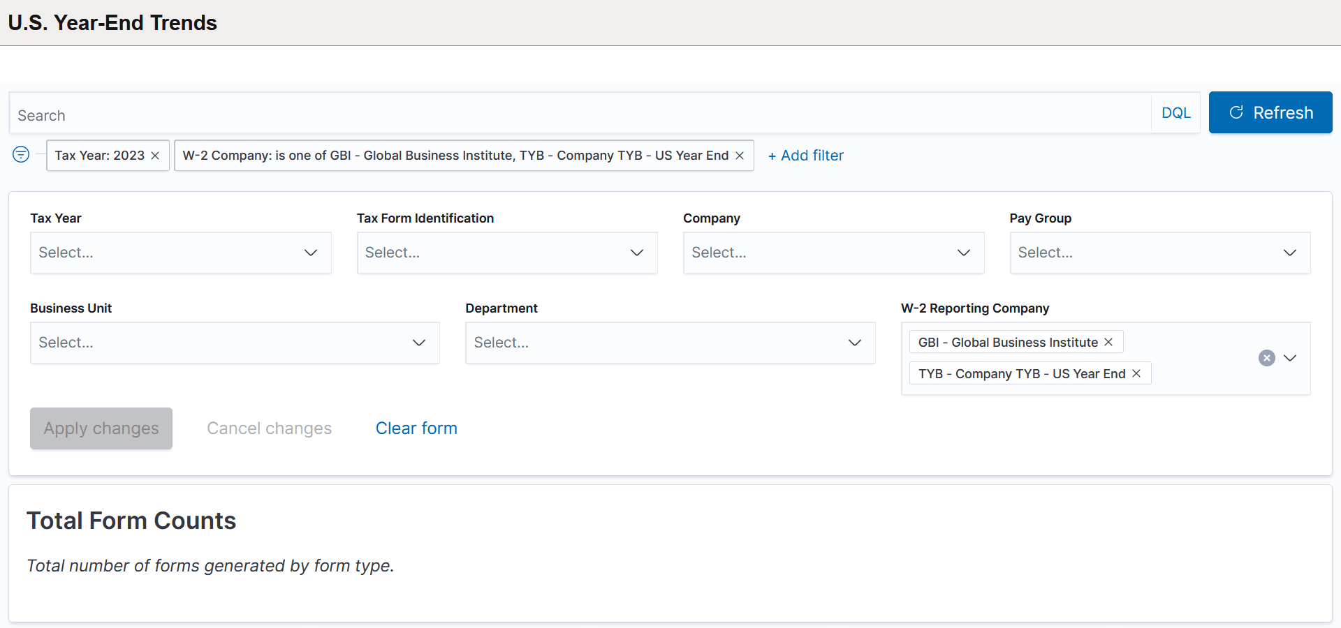

Search and Filter Options:
Field of Control Definition
Search field
Enter a query to filter data, if applicable.
Change all filters icon (Change all filters) and + Add filter icon and link
Enter criteria to filter data on the visualizations. You can apply filters in a number of ways:
  • Enter queries in the Search field.
  • Use the + Add filter link to create filters using fields, operators and field values.
  • Use delivered filter fields.
  • Select a chart item from a visualization.
  • Use the filter options in details grids to add or exclude items.
  • Use the legend to add or exclude items.
Added filters are displayed next to the + Add filter link for reference. For example, when you select the metric number of a year-end form, the filter is automatically added to your filters list, and all visualizations are refreshed to show data pertaining to the selected form.
Select the Change all filters icon for a list of actions that can be performed on all filters, for example, disable them temporarily, remove them permanently, or invert inclusion (show data that does not meet filter criteria). Click a filter item for a list of similar actions that can be performed on it individually.
Tax Year, Tax Form Identification, Company, Pay Group, Business Unit, Department, and W-2 Reporting Company
Select to refine year-end form data using delivered filters.
Note: Delivered filters for the U.S. Year-End Audit dashboard are Tax Year, Tax Form Identification, and W-2 Reporting Company.
Apply changes button
This button is available after you select filters.
Select this button after you select filters to update visualizations.
Cancel changes link
This link is available after you select filters.
Select this link to remove any update you entered since the last time you applied changes.
Clear form link
Select this link to remove all the values from the filter fields in this section. You must select the Apply changes button to update the visualizations.

When you select filters or chart items, PeopleSoft Insights dynamically updates all visualizations using the source from the index.
Filter By
For a list of filters available for the year-end dashboards, see the Common Elements and Controls section in this documentation.

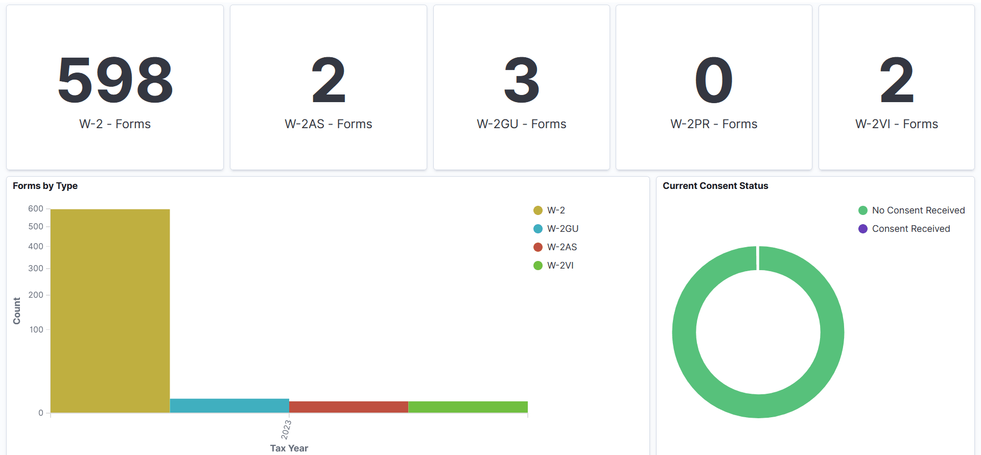

Total Form Counts
These number charts display counts of generated year-end forms by form type, which includes W-2 forms for U.S. and U.S. territories (American Samoa, Guam, Puerto Rico, and Virgin Islands).
These counts pertain to forms that were generated based on the PDF generation process of the year-end forms.
Forms by Type vertical bar chart
This visualization displays the counts of year-end forms created for each specified form type by tax year.
Current Consent Status donut chart
This visualization displays the percentage and count of year-end forms by consent status.

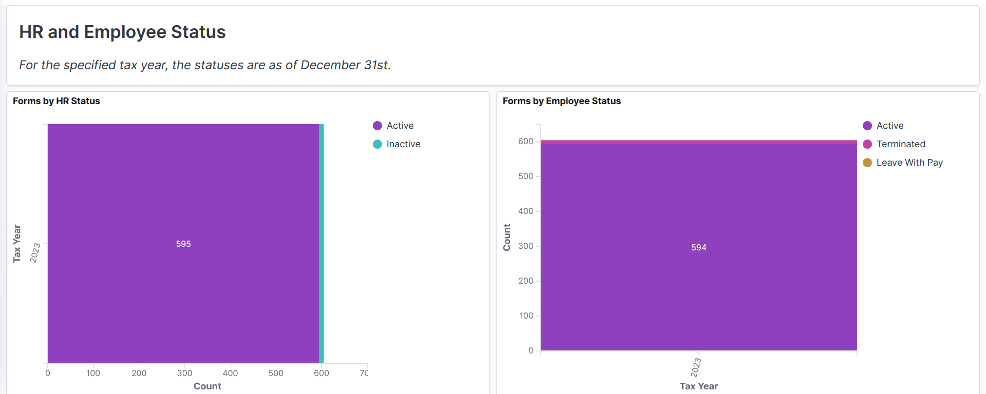

Forms by HR Status horizontal bar chart
This stacked bar chart displays the counts of end-year forms for employees in the Active versus Inactive HR status by tax year.
The HR status is captured as of December 31 of the tax year.
Forms by Employee Status vertical bar chart
This stacked bar chart displays the number of year-end forms for employees of each specified employee status (payroll status) by tax year.
The employee status is captured as of December 31 of the tax year.

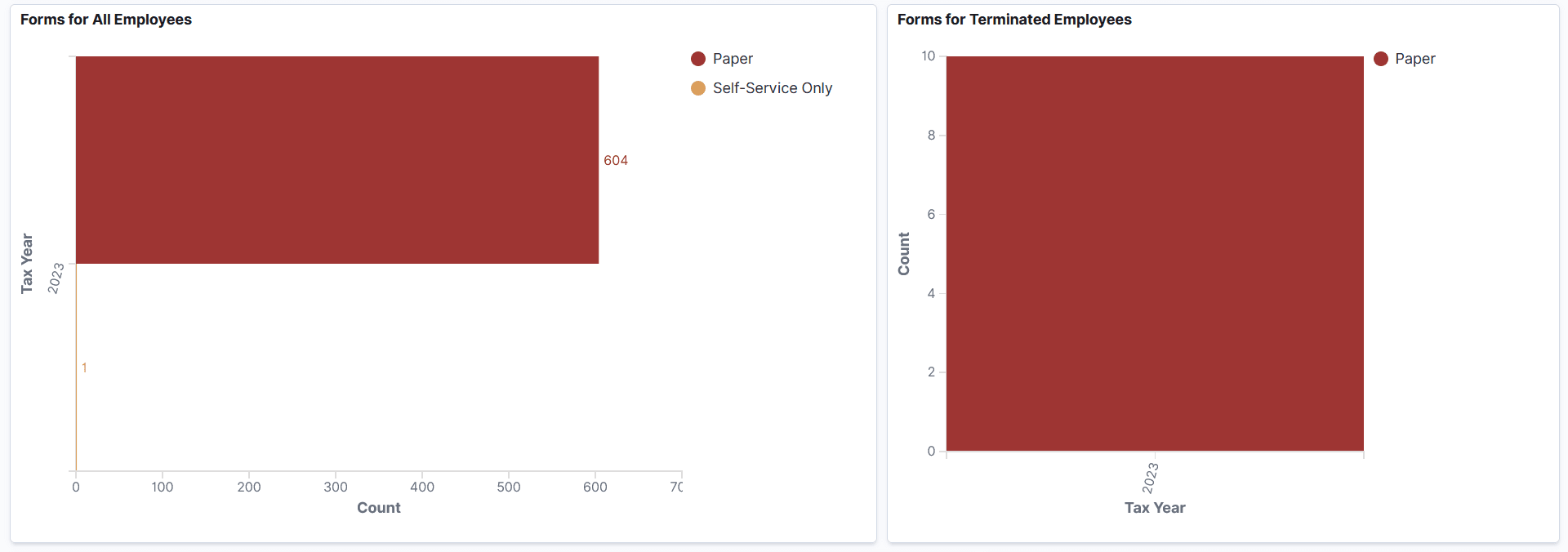

Forms for All Employees horizontal bar chart
This visualization displays the counts of paper versus electronic year-end forms created for all employees (employees with either Active or Inactive HR status) by tax year. It shows the trend of paper form usage in the organization, which is helpful when you need to order paper for form printing.
Forms for Terminated Employees vertical bar chart
This visualization displays the counts of year-end forms created for terminated employees by tax year.
Note: If the dashboard is filtered by the Local wages, tips, etc. or Local income tax box description, no results will be displayed in this visualization because local wages do not apply to terminated employees.

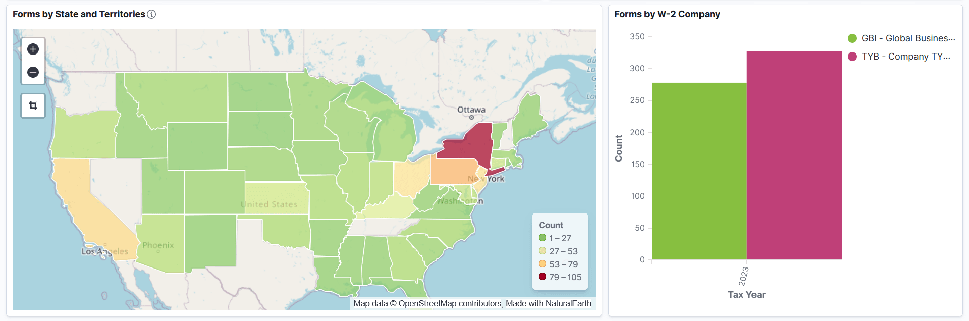

Forms by State and Territories map
This region map displays the number distribution of year-end forms among U.S. states and territories.
Note that the form counts presented on this map are based on the state code in Box 15. A form is not counted if Box 15 is blank. A blank state code can be caused by one of these reasons:

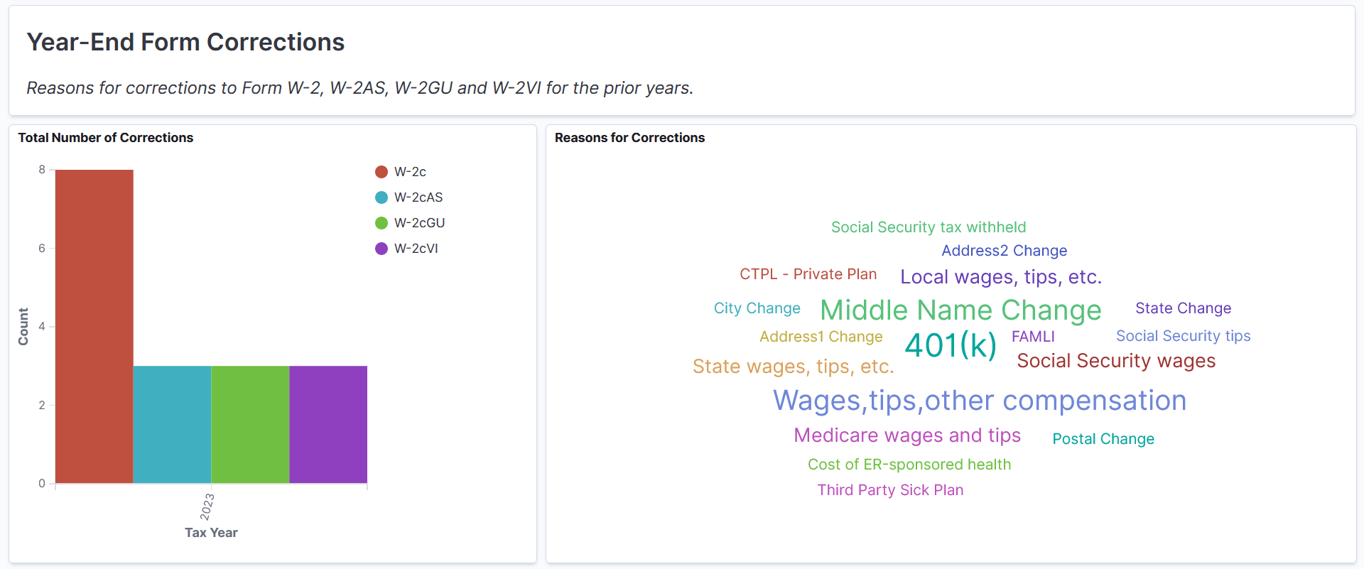

  • Overflow W-2s for box 12 or 14 data
  • No state data was imported to the YE tables because the employee does not have tax withholding in their state, such as Alaska, Florida, Nevada, South Dakota, Tennessee, Texas, Washington, or Wyoming.
Forms by W-2 Company vertical bar chart
This visualization displays the number of year-end forms created for each specified W-2 company by tax year.

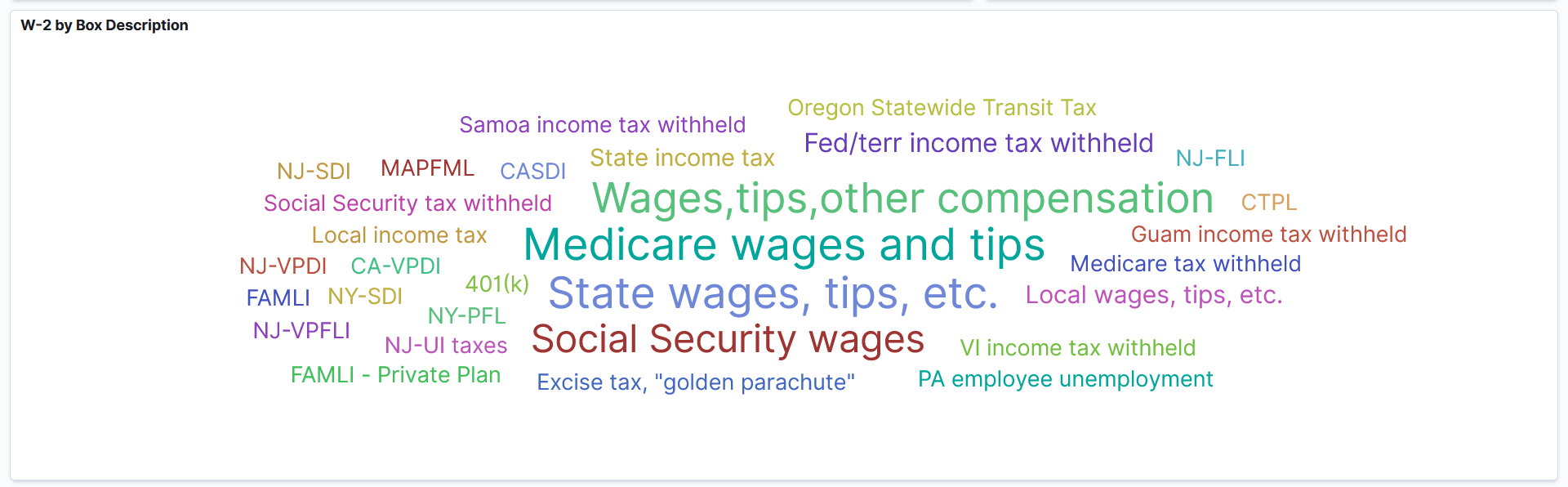

W-2 by Box Description tag cloud
This visualization displays amount-specific box labels that are available in year-end forms. The larger the font size of a box label, the greater the total amount calculated from the year-end forms.

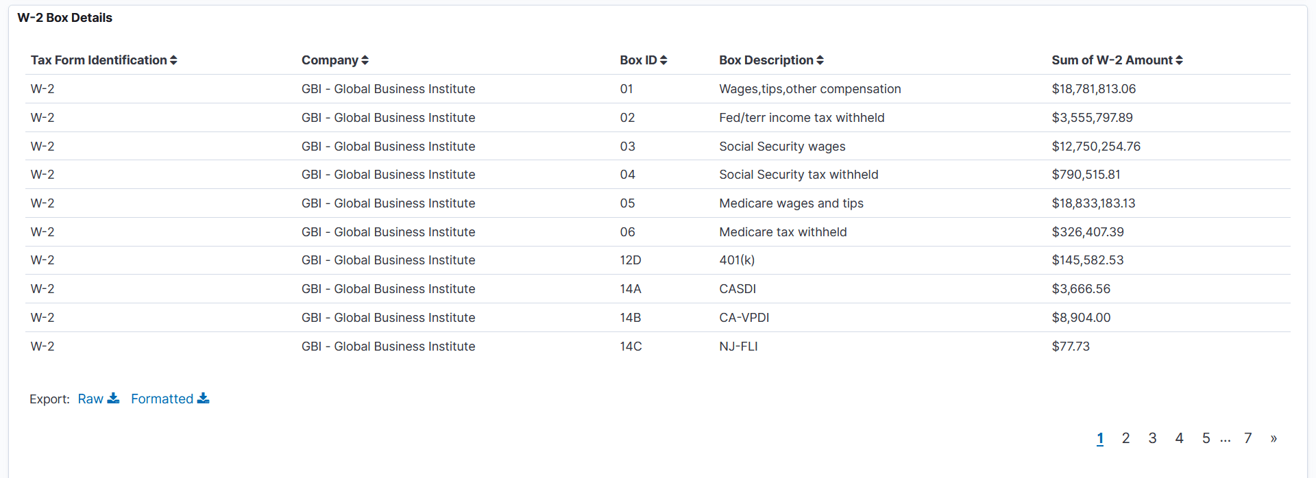

W-2 Box Details
This grid lists the boxes and corresponding total amounts of year-end forms for companies, which are presented in visualizations, in a tabular format.

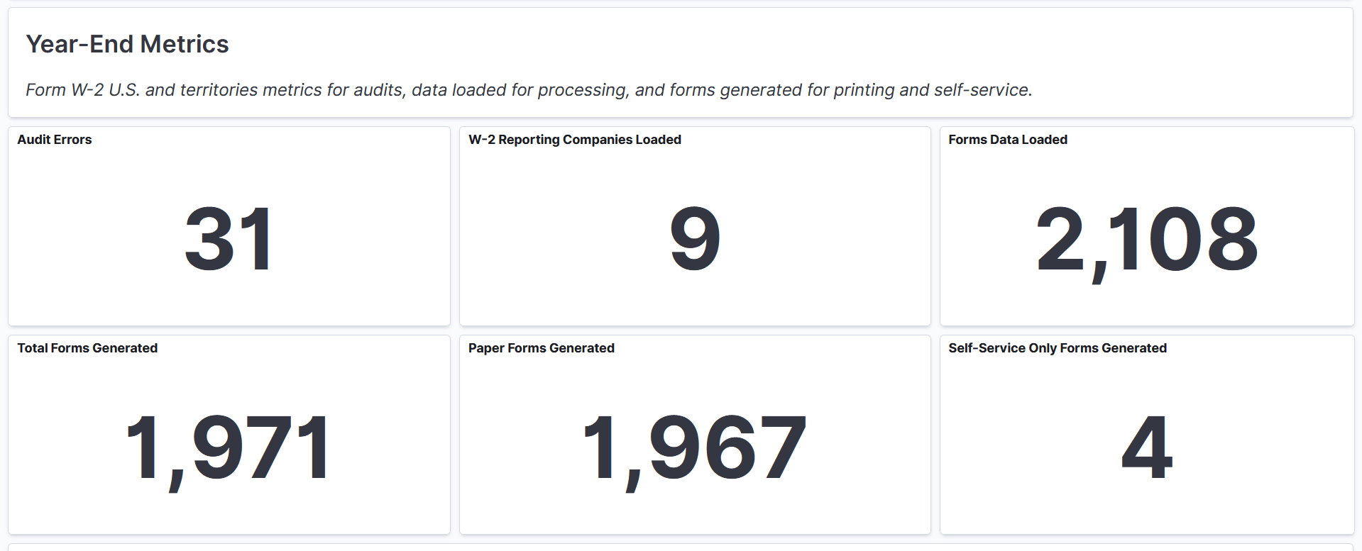

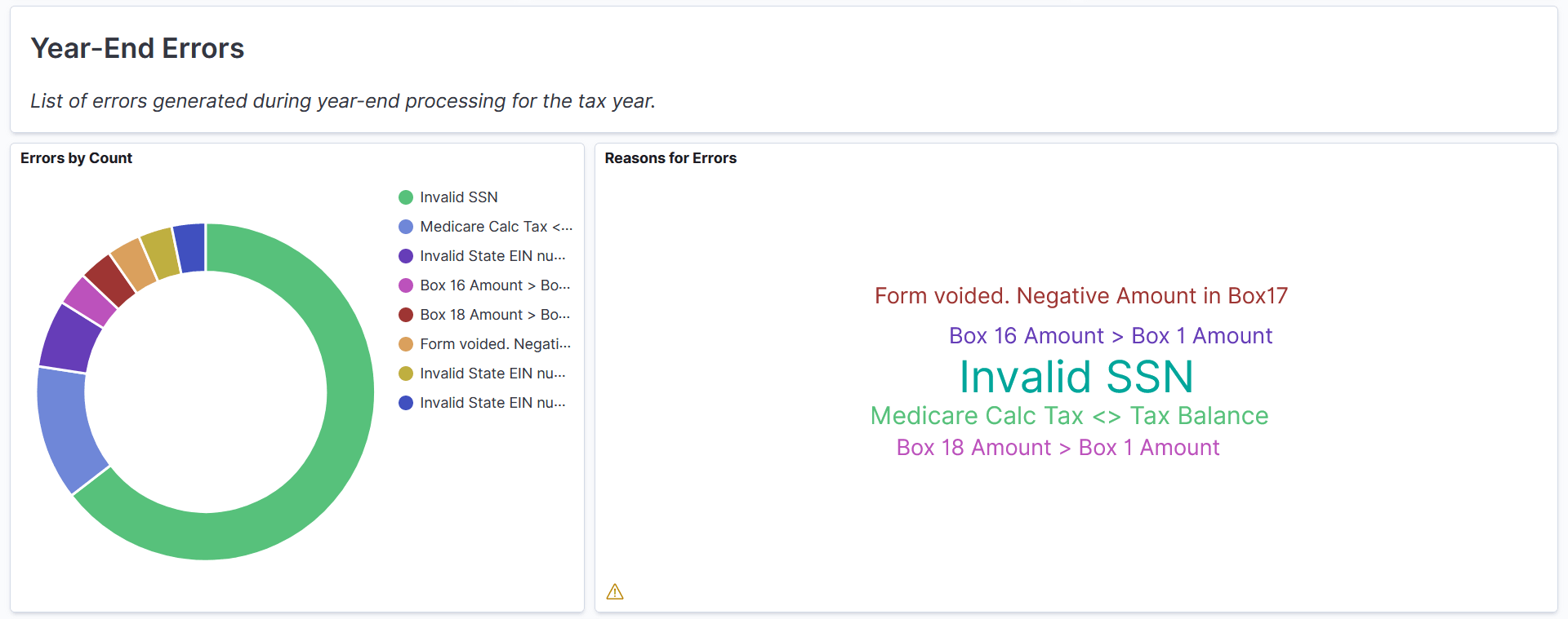

This tile displays the Errors by Count visualization, which shows the distribution of identified audit errors.
Select this tile to access the U.S. Year-End Audit Dashboard and interact with year-end audit data for U.S. Payroll.

Filter By
For a list of filters available for the U.S. Year-End Audit dashboard, see the Common Elements and Controls section in this documentation.

Year-End Metrics
These number charts display highlight information of year-end processing for the selected tax year (or tax years), for example, counts of identified audit errors, loaded W-2 reporting companies and forms data, and paper and electronic forms generated by the process.
Year-End Errors
Use these charts to identify the list of top errors that were reported during year-end processing.
Visualization Description
Errors by Count donut chart
This visualization displays the percentage and count of audit errors reported by the TAX910ER process.

W-2 Error Details
This grid lists the employees who had audit errors in their year-end forms. Additional information, such as the employee's company, pay group, and department, is also displayed and can be used to filter data on the year-end error visualizations.
Year-End Form Corrections
Use these charts to visualize form correction data for previous years, and identify which forms had high number of corrections and where those corrections occurred.
Total Number of Corrections vertical bar chart
This visualization displays the counts of generated year-end correction forms by tax year. Supported form types include W-2c, W-2cAS, W-2cGU, and W-2cVI.
Reasons for Corrections tag cloud
This visualization displays the form boxes that had their values updated using correction forms. The larger the font size of a box label, the higher the number of corrections it has.

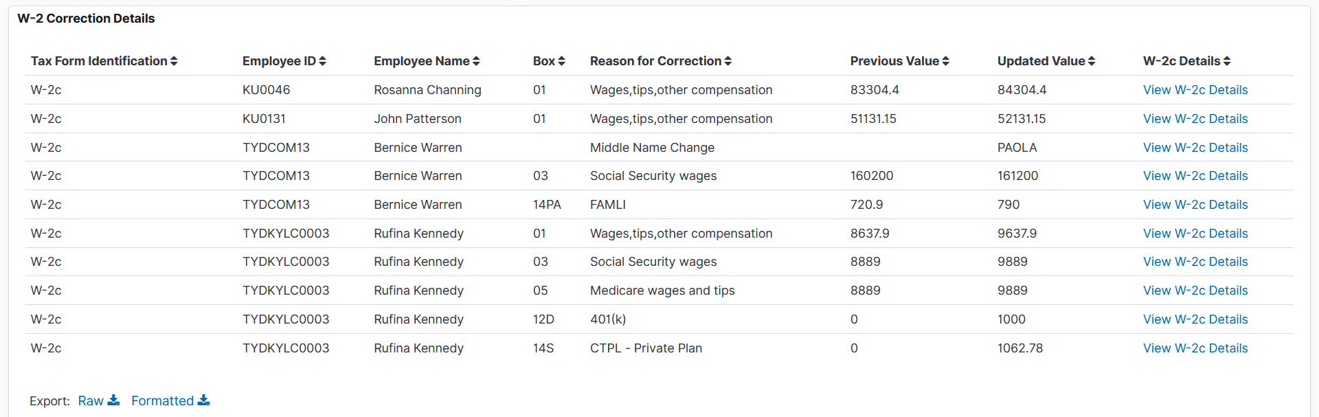

W-2 Correction Details
This grid lists the employees who had year-end form corrections and the associated correction information. Additional information, such as employee ID, box code, box label, and form type, is also displayed and can be used to analyze data on the year-end correction visualizations.
Field or Control Description
View W-2c Details
Select to view the update details of the correction form for the corresponding employee on the Create W-2c US/Territories page.
