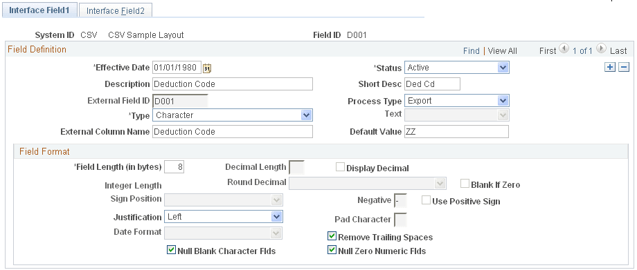

This example illustrates the fields and controls on the Interface Field1 page.
Field Definition
Field or Control Description
Process Type
Select the Payroll Interface process.
Note: Exp/Imp (export/import) can be used as the process type only if the characteristics of the field are the same for both import and export. Otherwise, you need to set up records for each process type. The Employee ID field is the only field that is mapped as both an export and import type; you do not need to define a PS record or field name for it.
External Field ID
If the System Table - Interface System Table 1 page, External Field ID Indicator option is selected, the external field ID becomes by default the value that you enter here. The external field ID can be up to 10 characters.
Type
Select from the following options:
  • Character
    Use the Justification field to specify whether characters are left or right justified.
    Note: When you are mapping from a large field to a smaller field, the results are truncated. For example, if you map '0123456789' from a 10-character field to a 7-character field, the result is '0123456'.
  • Date
    Use the Date Format field to specify the third-party payroll system's date format.
  • Number
    Use the Display Decimal andDecimal Char (decimal character) fields to specify a decimal separator.
  • Signed
    Use the Sign Position field to select the placement of the sign for signed numerical fields.
  • Value
    Select to specify a predefined data item for the Text field. For example, with thePay Run ID field, enter Pay Run ID as the text. (Including Pay Run ID in the header record may help ensure that the correct file is processed.)
    If using the company filtering feature, use the Processing Company or Processing Pay Group values for the Text field.
    See Working with Company Filtering.
Text
Select to enter a translate value.
Note: This field is active only if you have selected Value in theType field.
See Working with Text Translate Values.
External Column Name
Select to enter a name of up to 50 characters if the Interface field is used in a delimited data file structure with a header. The system uses this name to construct the header record.
Default Value
If you use constant in the Text field, the value that you enter here is used.
You can also use a default value for the character type. For example, if the field is part of a header record, you can specify some fixed text as the default value.
Field Format
Use the options in the Field Format group box to define the file's field formats.
Field Length (in bytes)
For physical file formats, the length determines where the field will be positioned. When you are setting up the Interface Definition Fields page, you can view the exact character position of the field.
Integer Length
The system calculates the integer length to verify that you have set up a numeric field as intended.
For a signed field type, the system subtracts one position from the integer length to allow for the sign. Use Sign Position to specify where the sign goes.
Blank if Zero
This field is active only for number or signed field types. Select if the payroll system uses blanks in place of zeros.
