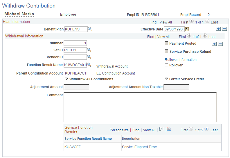

Withdraw Contribution Page
Use the Withdraw Contribution page (PA_WTHDRW_CTB) to enter the transaction when an employee elects to withdraw contributions.
Navigation:
Pension, and then Payments, and then Withdraw Contribution, and then Withdraw Contribution
This example illustrates the fields and controls on the Withdraw Contribution page.
Plan Information
Field or Control Description
Empl Record
Displays the active employment record number.
Benefit Plan
Identify the plan from which the employee is withdrawing contributions.
Effective Date
Enter the date that the withdrawal is effective. The first payment process (for one-time payments) that you run after this effective date picks up the withdrawal request and includes the payment in the Trustee Extract file.
Withdrawal Information
Number
This is a sequence number that you can use to distinguish among multiple withdrawals that you make from a plan on the same day. Typically, you only do this if you need to enter a payment in multiple components because there are multiple funding providers.
SetID and Vendor ID
Select an ID to identify the funding source for the withdrawal. The provider is typically the plan itself.
You enter providers into the system from the provider table. The provider table is effective-dated, so the provider must be valid for the effective date of the payment. If you specify valid funding providers for the plan in the Plan Administration component, only those providers are available.
Function Result Name
Select the function result name for the withdrawal account that tracks the withdrawal.
A withdrawal account rolls up to its parent account. By debiting a withdrawal account instead of the parent account, you enable the system to track interest on the withdrawn amount without forcing the main account to go negative.
Parent Contribution Account
When you enter a withdrawal account, the system displays the associated parent contribution account. Activity in the withdrawal account rolls up to the parent account.
When the withdrawal is processed, the negative adjustment to the withdrawal account (and thus to the parent account) is based on the last completed periodic processing for the parent account.
Withdraw All Contributions
Select Withdraw All Contributions to change the balance in the parent contribution account to zero in a single transaction.
Forfeit Service Credit
If an employee forfeits all service as a result of the withdrawal, select Forfeit Service Credit. If you select this option, the withdrawal account's "purchasable service" balance is set to the total value of the service account minus the amount paid out.
Note: The only option is to forfeit all service. The system does not support partial service forfeiture.
Adjustment Amount
If you break the withdrawal into multiple components, either because there are multiple funding providers or because the employee is not withdrawing all contributions, enter the total amount to be withdrawn.
Adjustment Amount Non Taxable
This is the portion of a withdrawal that is treated as nontaxable. When an employee's pension contribution is a posttax deduction, the employee has already paid taxes on that money. Contributions refunded are nontaxable. The interest portion of the employee account, however, is taxable.
Comment
Enter any comments associated with this withdrawal.
Service Function Results
Service Function Result Name and Description
When you enter a withdrawal account, the system displays the associated \and service function results. These are the service accruals that are affected if withdrawing contributions results in service forfeiture.
