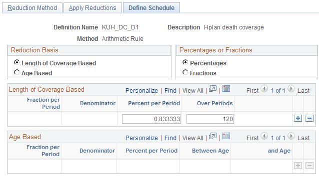

Define Schedule Page
Use the Define Schedule page (PA_DEATH_ADJ_COV) to set up an arithmetic rule for death coverage.
Navigation:
Set Up HCM, and then Product Related, and then Pension, and then Components, and then Death Coverage, and then Define Schedule
This example illustrates the fields and controls on the Define Schedule page.
Death Coverage - Define Schedule page
Reduction Basis
An arithmetic reduction can be based on either employees' ages or their lengths of coverage. To give an age-based example, you could reduce a benefit by .04 percent per period from age 40 to 54, then by .03 percent per period from age 55 and up. A reduction based on length of coverage would follow a pattern such as a .04 percent per period reduction for the first 30 periods and a .03 percent per period reduction for additional periods. The period is determined by the Periods Counting Option on the Reduction Method page.
Field or Control Description
Length of Coverage Based or Age Based
Select Length of Coverage Based or Age. Then complete either the Length of Coverage Based or Age Based group box.
Percentages or Fractions
Select one of these options to choose whether to express the reductions as fractions, such as a 1/600 reduction per period, or as percentages, such as .16% per period.
Reduction Details
Use the Length of Coverage Based group box or the Age Based group box to provide reduction details.
For reductions based on length of coverage, the system applies adjustments in the order in which they appear on the page. So if you adjust by .05 percent per year for the first two years and .04 percent per year for the next three years, the .05 percent row must be before the .04 percent year. The order shown on the page is the order the function uses.
Fraction per Period and Denominator
If the reduction uses a fraction, enter the fraction numerator in the Fraction per Period field, and enter the fraction denominator in the Denominator field.
Percent per Period
If the reduction uses percentages, enter a percentage.
Over Periods
If your reduction is based on the length of coverage, indicate how many periods use each factor. The first row in the sequence applies to the first group of periods, the second to subsequent periods, and so on.
Between Age and And Age
Specify the age range to which each factor applies.
